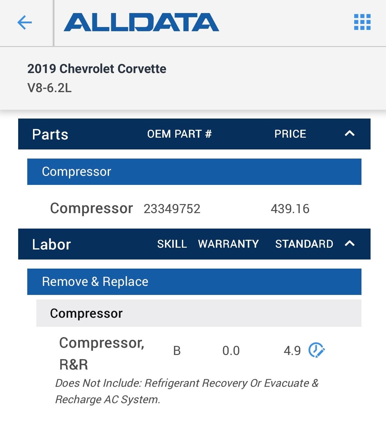

Can anyone help me with needed info, my 2019 corvette stingray is in the dealer, thry say the AC Compressor is shot. What will this cost parts and labor using an O.E.M. GM Compressor from a GM dealer. Thanks,

Below is cost info from Alldata…now WHY is the compressor being replaced ??…if it failed internally you need to replace more than just the compressor…watch the video….if failure is internal and you just change the compressor it will most likely fail again and probably won’t be covered under a warranty !!…I hope the dealership guessed right…cheaper to take the car to C&S Corvettes in Sarasota…with 5 hours of labor plus the evac and fill you are looking at maybe $1500-2000…don’t let them BS you on the “book time”…4.9 hours plus another 1-3 hours for the evac and charge !!
