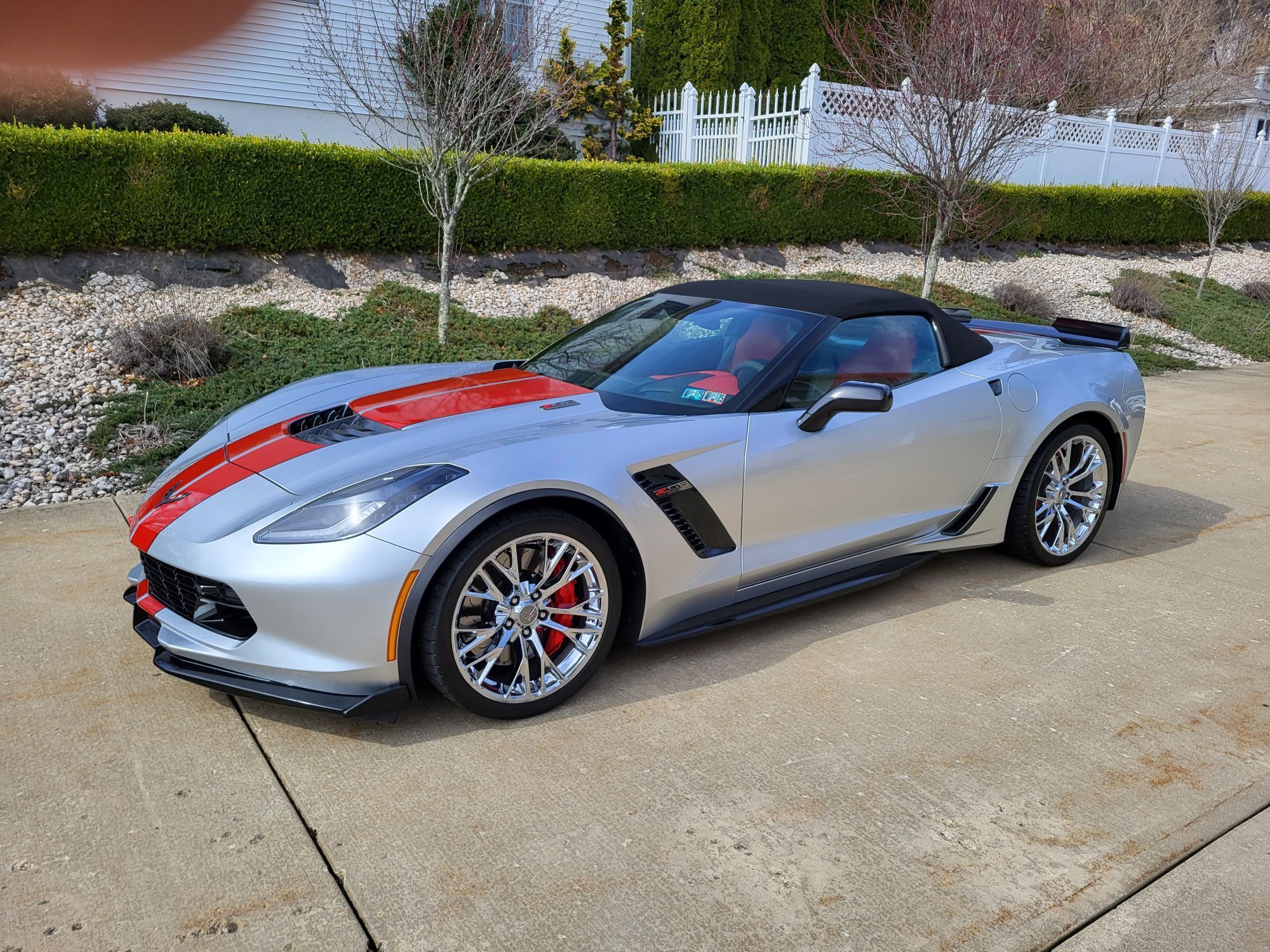

That is an absolutely beautiful and stunning Z06!
Thank you. We absolutely love it. Only 7,500 miles.
