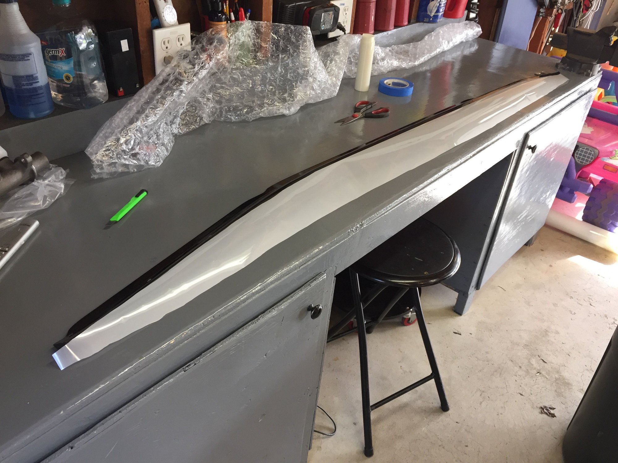

I installed a pre-cut expel on set on my C7 including the front bumper. Its not rocket science but I will tell you it is an art form and i give good installers a lot of credit. Especially when I see a job well done. A good install has perfect edges, no bubbles and nothing under the film.
These are the challenges you will face:
1 - Stretching. You pull on one side and it affects the other. Your want for example, to stretch the PPF so it properly surrounds the headlights. Its a lot harder than you may think. Like in the video he does one side first (emblem to headlight). What he doesn't mention is that if you use too much film on one side, the other side can be short.
2- Bubbles and any kind of dirt. Make sure your hands, tools and the surface is extremely clean.
3 - Be patient, its a lot more work and time than you think.
4 - You can stretch the PPF a lot, but pull too hard and it will damage it.
Good luck! My front bumper home install came out perfect. I would say I was at it 3 hours.

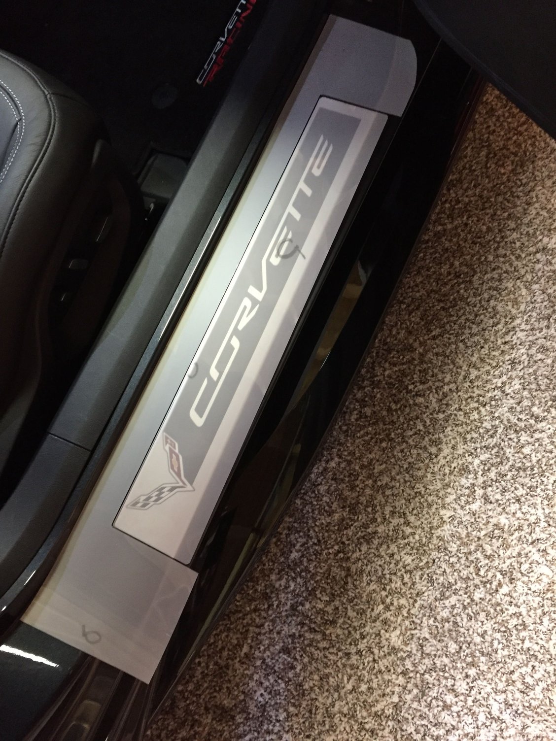

I did lots of small pieces that I cut myself, headlights, door sill, bottoms of the door and front fender, side skirts etc. Flat areas are easy. Curved areas like the bumper are hard to make your own. The pre-cut has the angles and cuts already made. My front splitter for example didn't come out that great. The notch areas are hard to determine.

The door sills are definitely on my list and will most likely be a "custom cut" approach.
