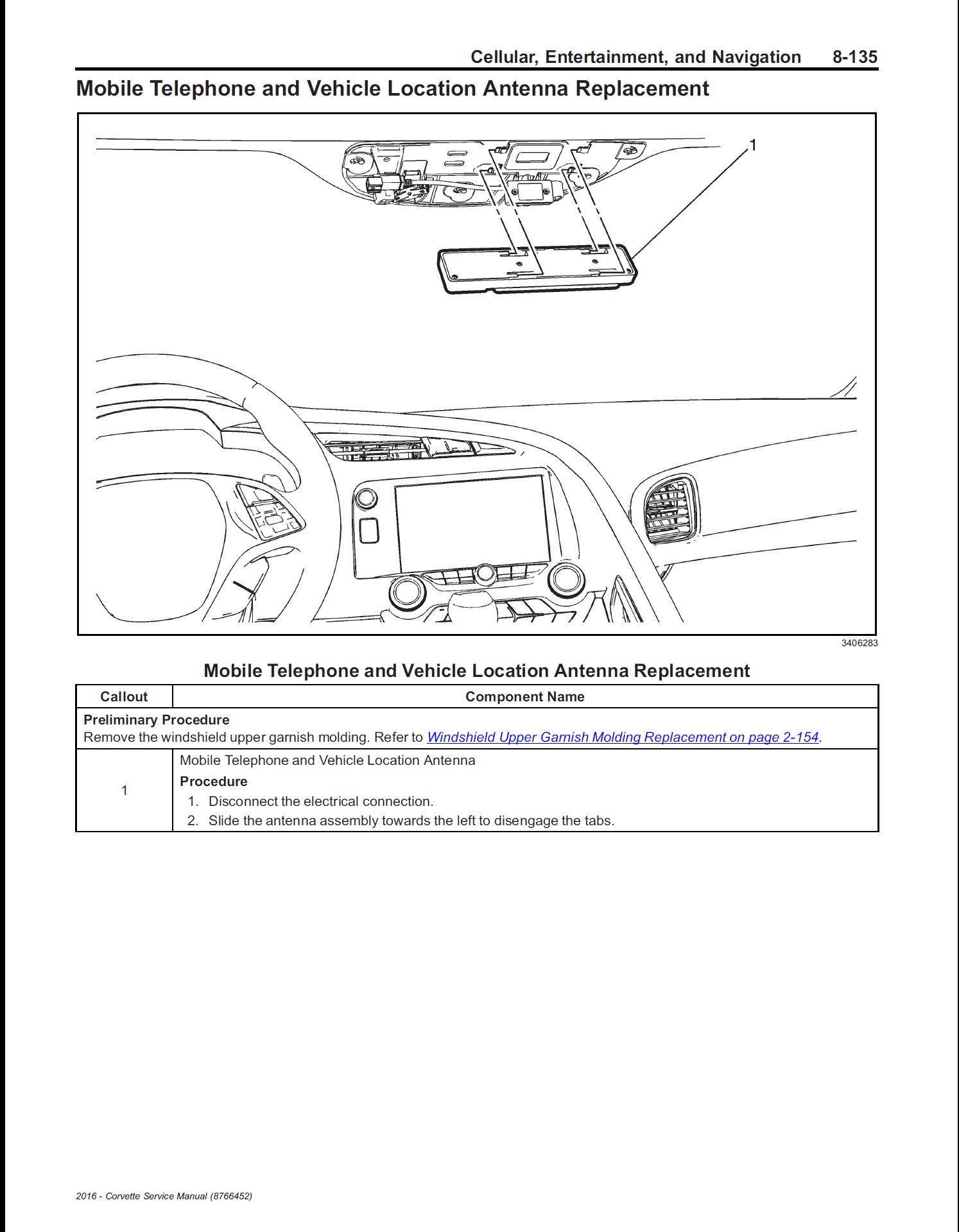

The issue may be due to the antenna becoming disconnected. Check the antenna connection behind the rear-view mirror panels.
Bill

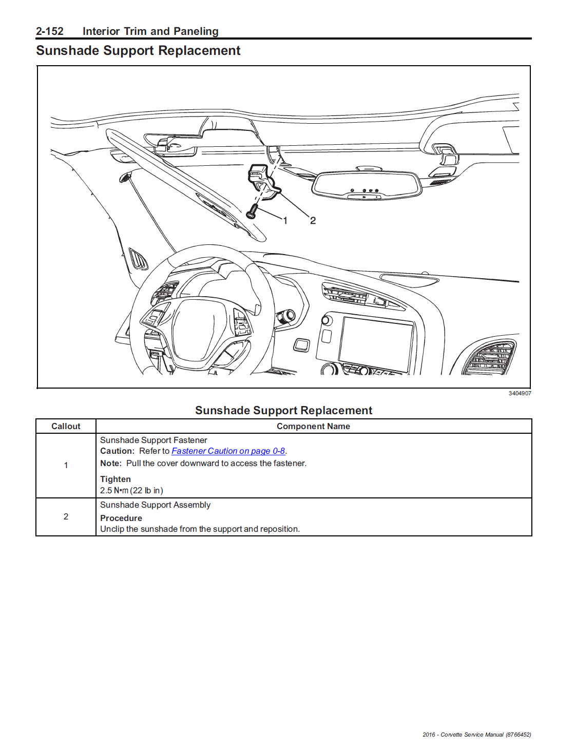

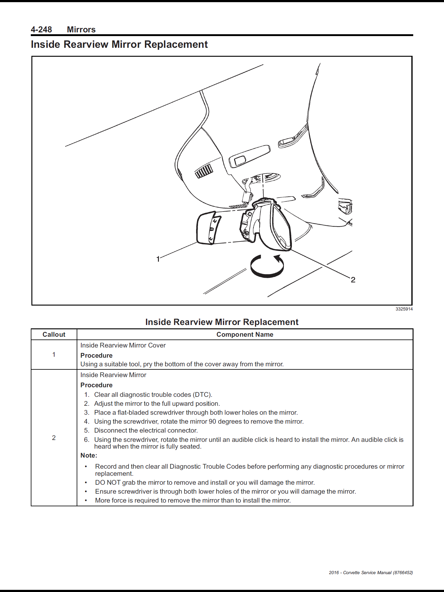

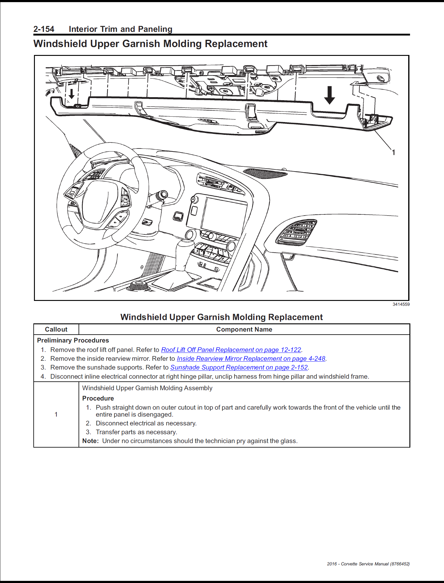

Bill
Your post is great. I’m installing a blend mount radar detector soon and although I’ve watch the videos I was thinking there may be a written procedure on how to pull off the cover behind the mirror without breaking anything. Might you have that?
