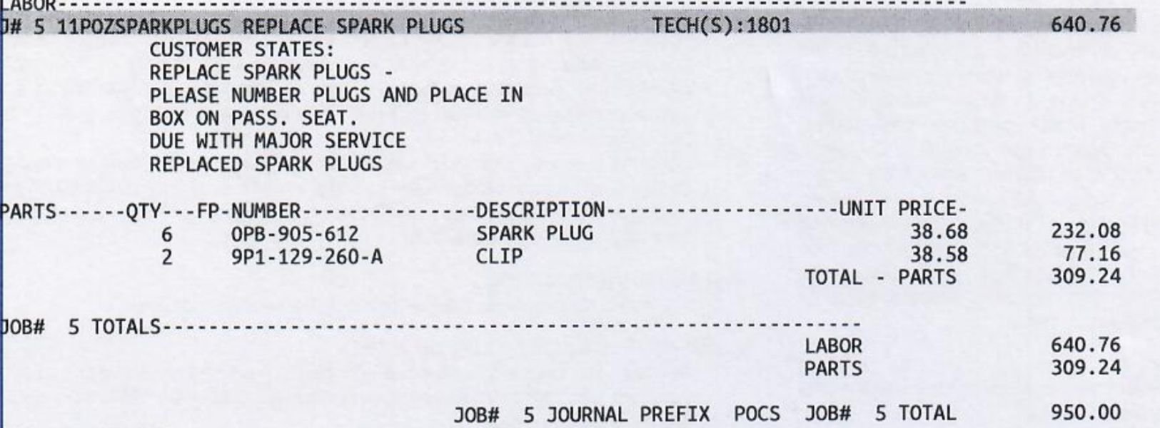

I’m glad I own a Grand Sport. On my 911 plugs had to be changed at 4 years or 30k mi. Evidently one couldn’t get the my plugs out.
911 Spark Plug Change Cost
