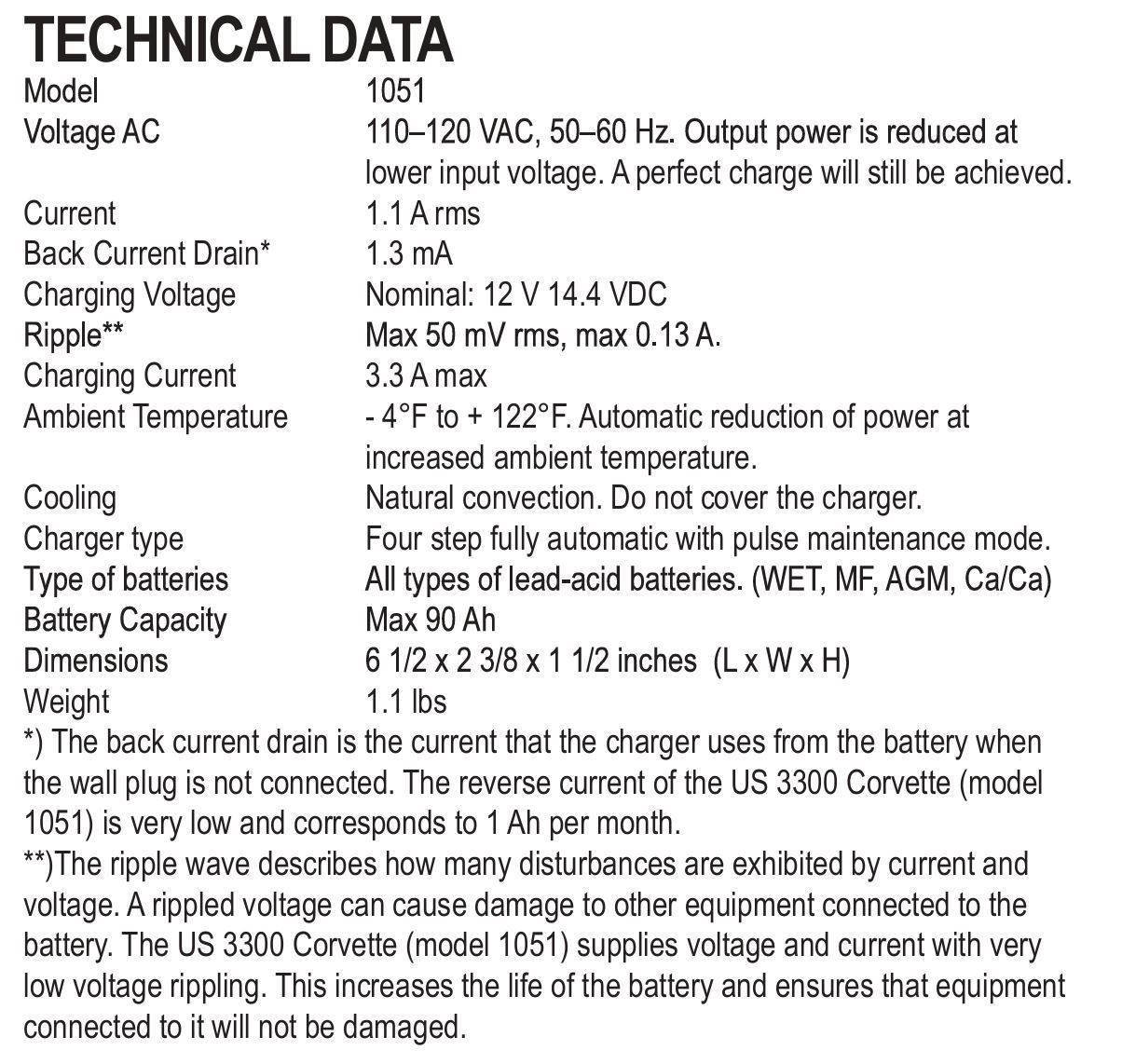

Will the stock battery tender work properly with an AGM battery? I've seen some youtube videos that caution against it.
If the instructions don't specify, I would get one that does for sure. I just had to do that with my motorcycle.

Just look on the manufacturer web site for that model's instructions and see if it is acceptable for AGM. Or email support@ctek.com and ask them - just give them the model number off your maintainer.
Most new maintainers should support AGM - but check the package or instructions to be sure.

My GM CTEK seems to work fine with my AGM.
Yes. Like many things on the Internet, YT is far from authoritative.
Good advide. Thankfully, the instructions DO specify. According to page 9 of the US 3300 Corvette Model 1051 Battery Charger User's Manual, it's suitable for charging "All type of lead-acid batteries. (WET, MF, AGM, Ca/Ca)"
