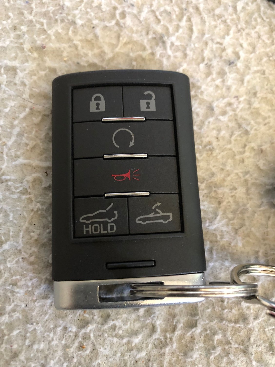

These are the two fobs I got when I purchased my 2016 Z06 “convertible” and my 2017 grand sport “coupe” (Each came with only one).
Can anyone tell the difference? And no, the fact that one of them doesn’t have the key blank doesn’t count lol.
Can anybody tell me which one came with which car? You can’t. Because they’re identical. Hell, I had to label them so I could tell them apart!
Hint: the one on the right came with the Z06 convertible.

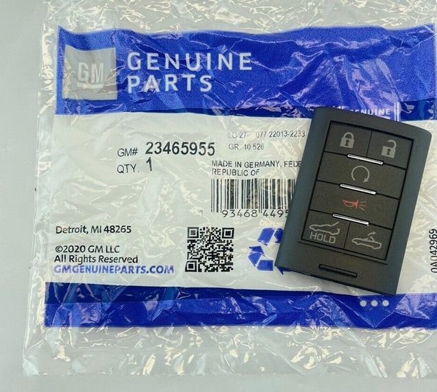

according to the list above, this is the fob needed for the convertible
Old Aug 27, 2025 | 04:05 PM
RobertCorvette's Avatar
RobertCorvette
Joined: May 2022
Posts: 578
Likes: 426
From: Bay Area
Yep. Bought two of those off of eBay and programmed them myself to the number one and two memory slots.
