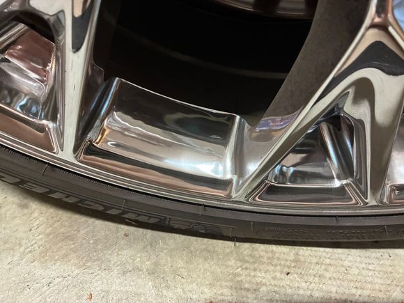

This wheel (and the other three, as well ) has about 500 miles on it since it was last washed. The lack of dust is because of the PowerStop Z26 pads.
