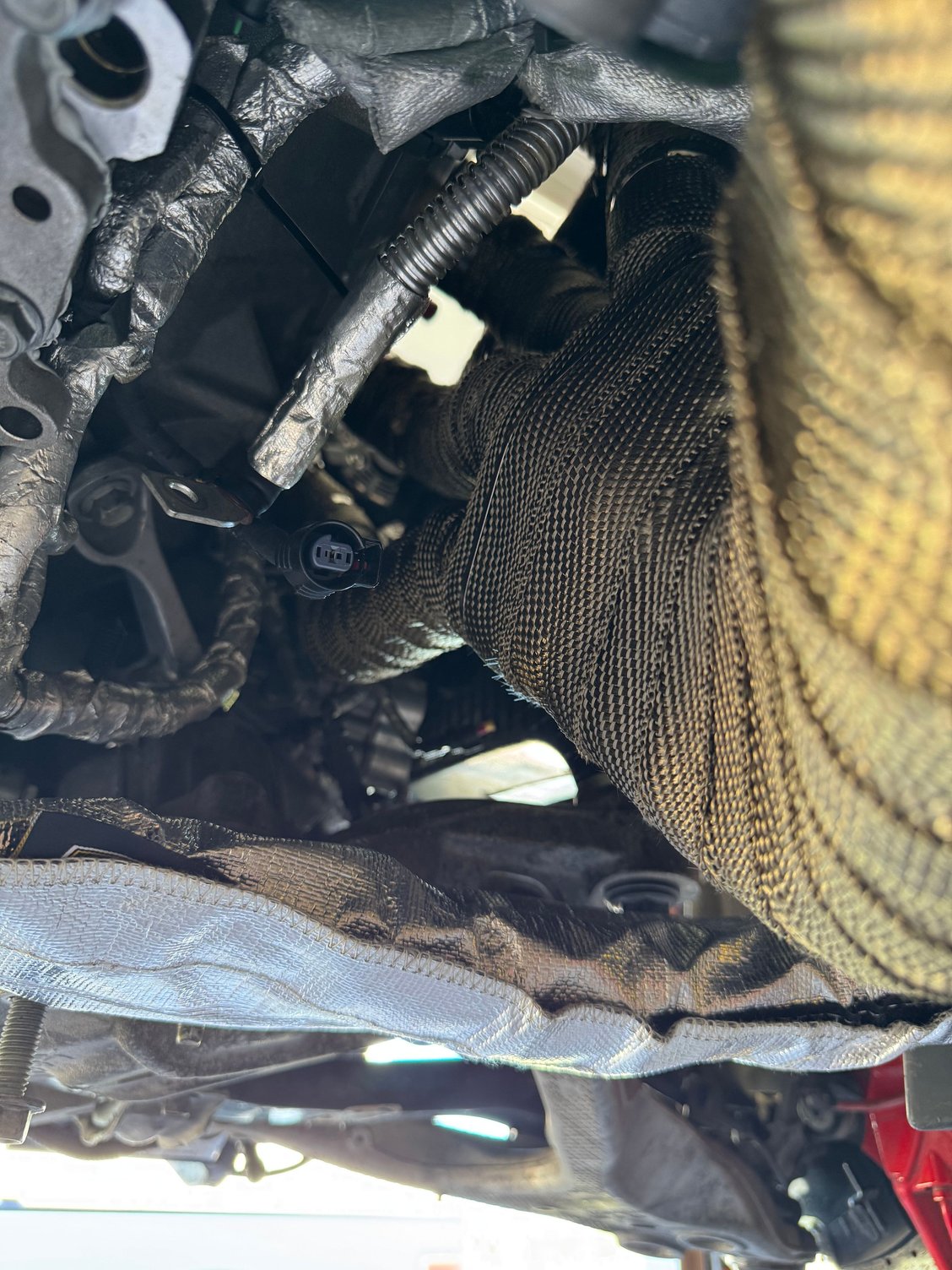

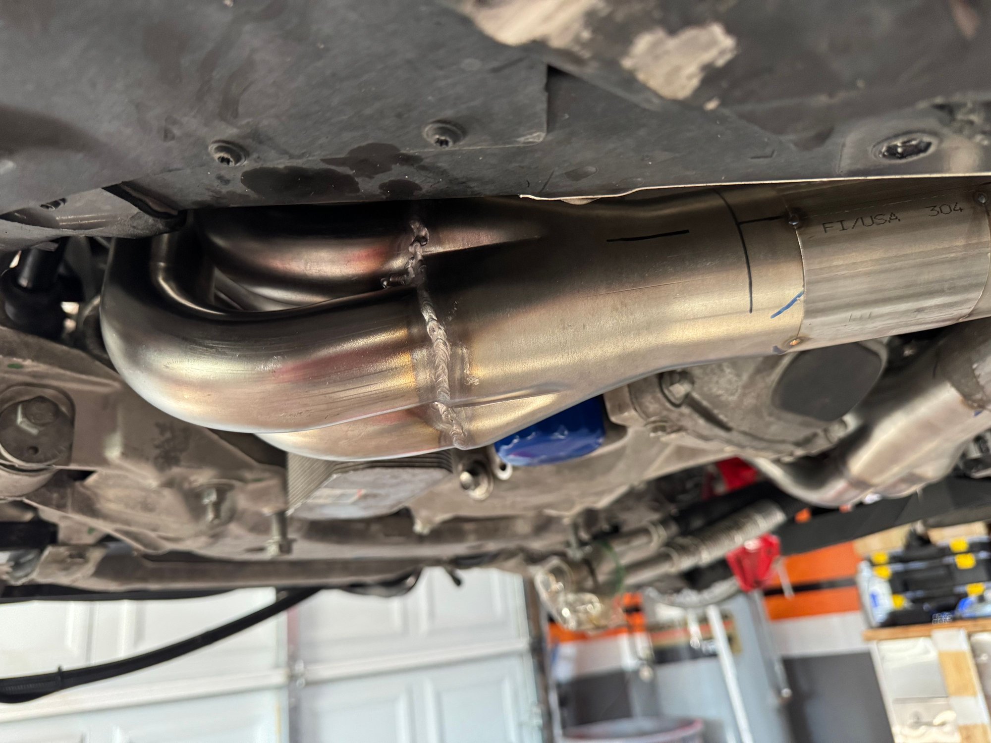

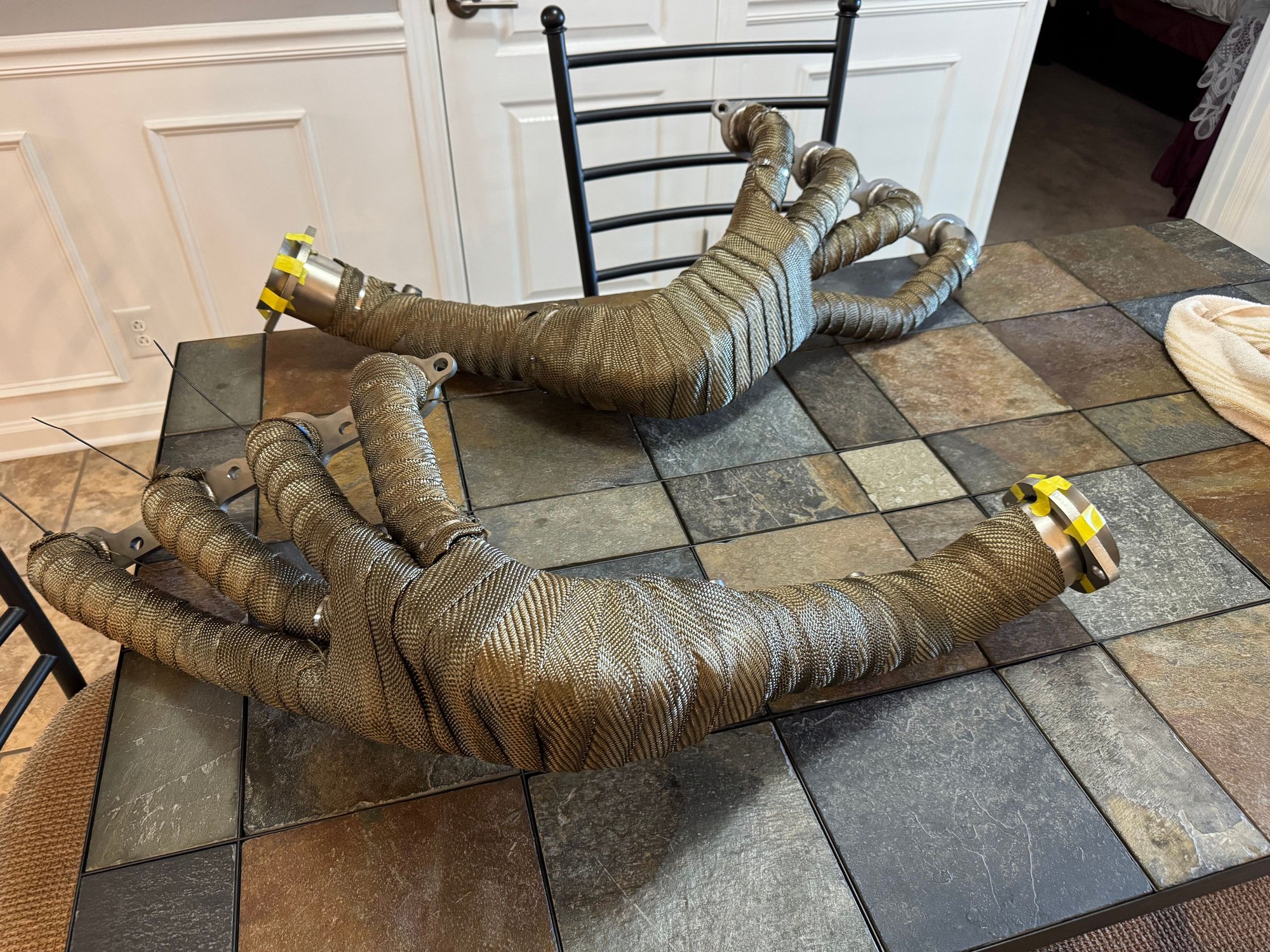

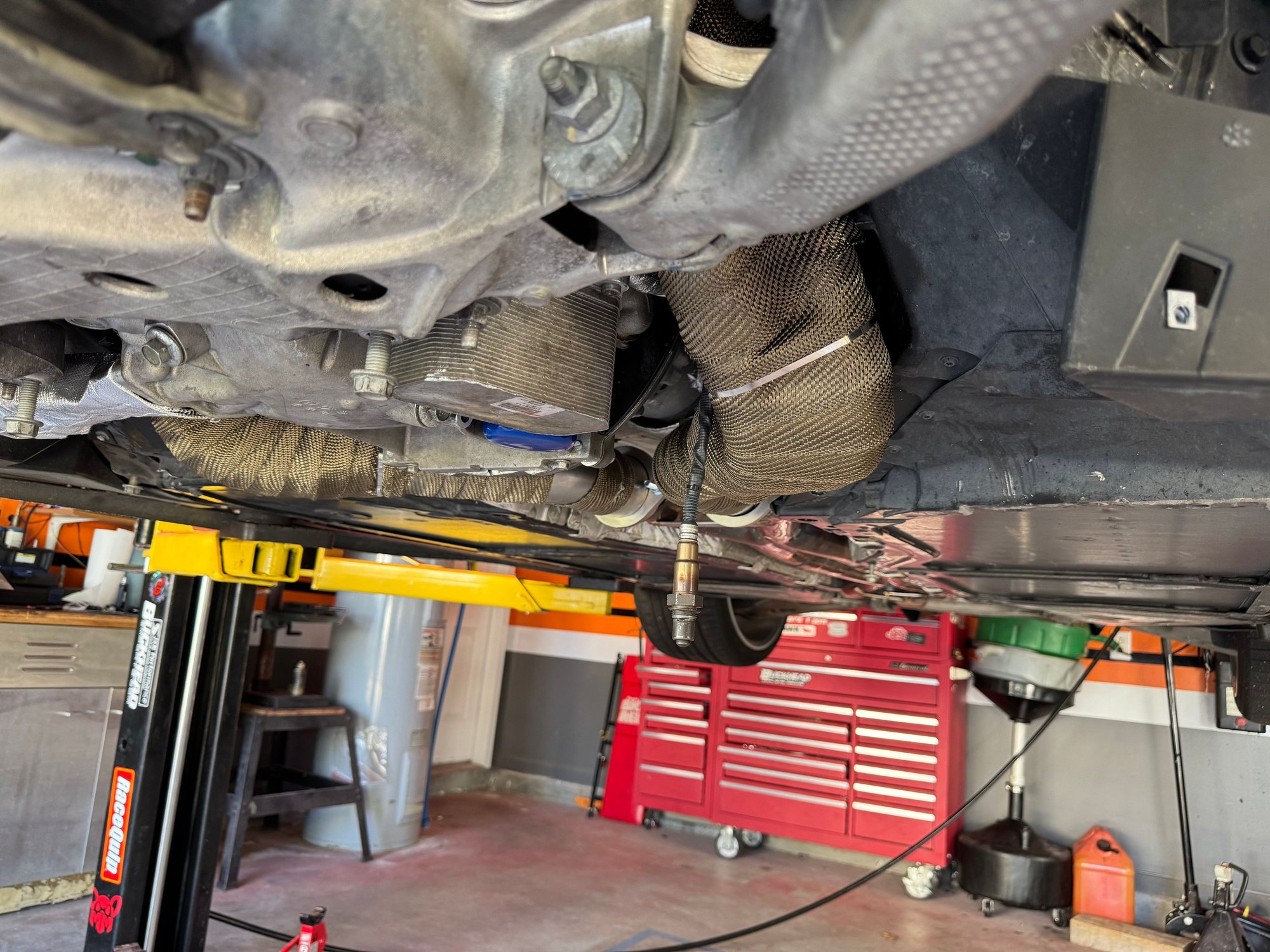

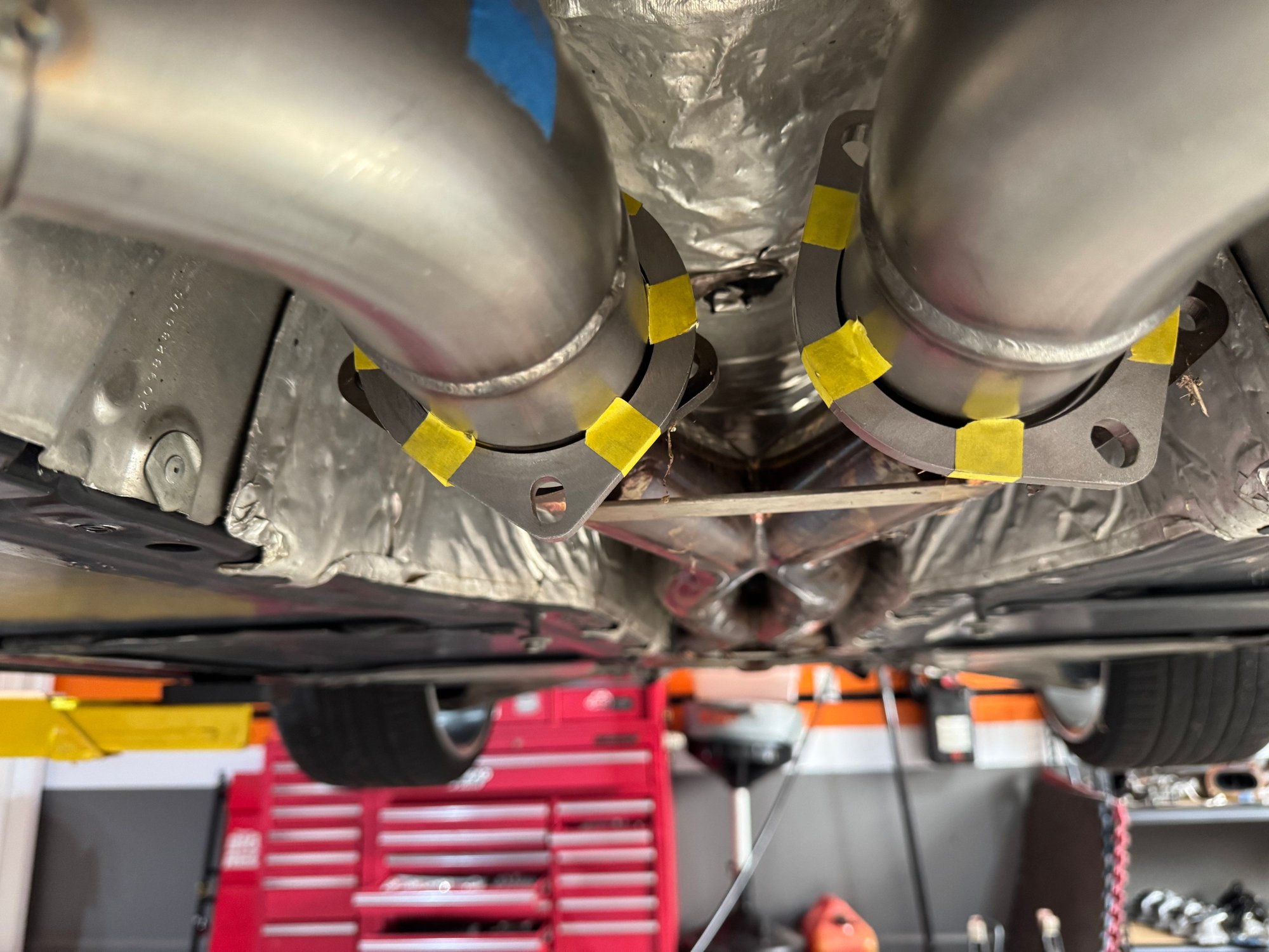

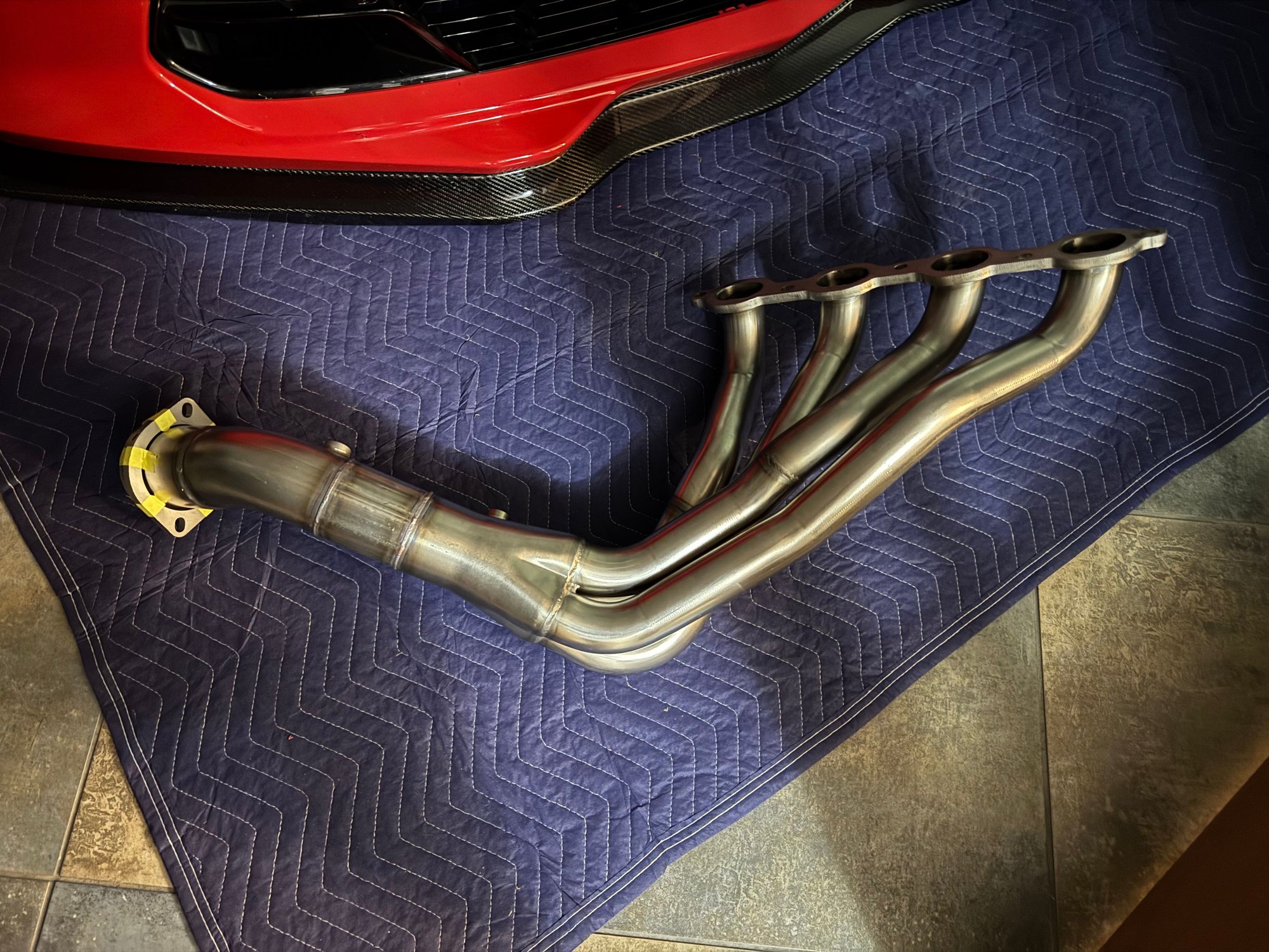

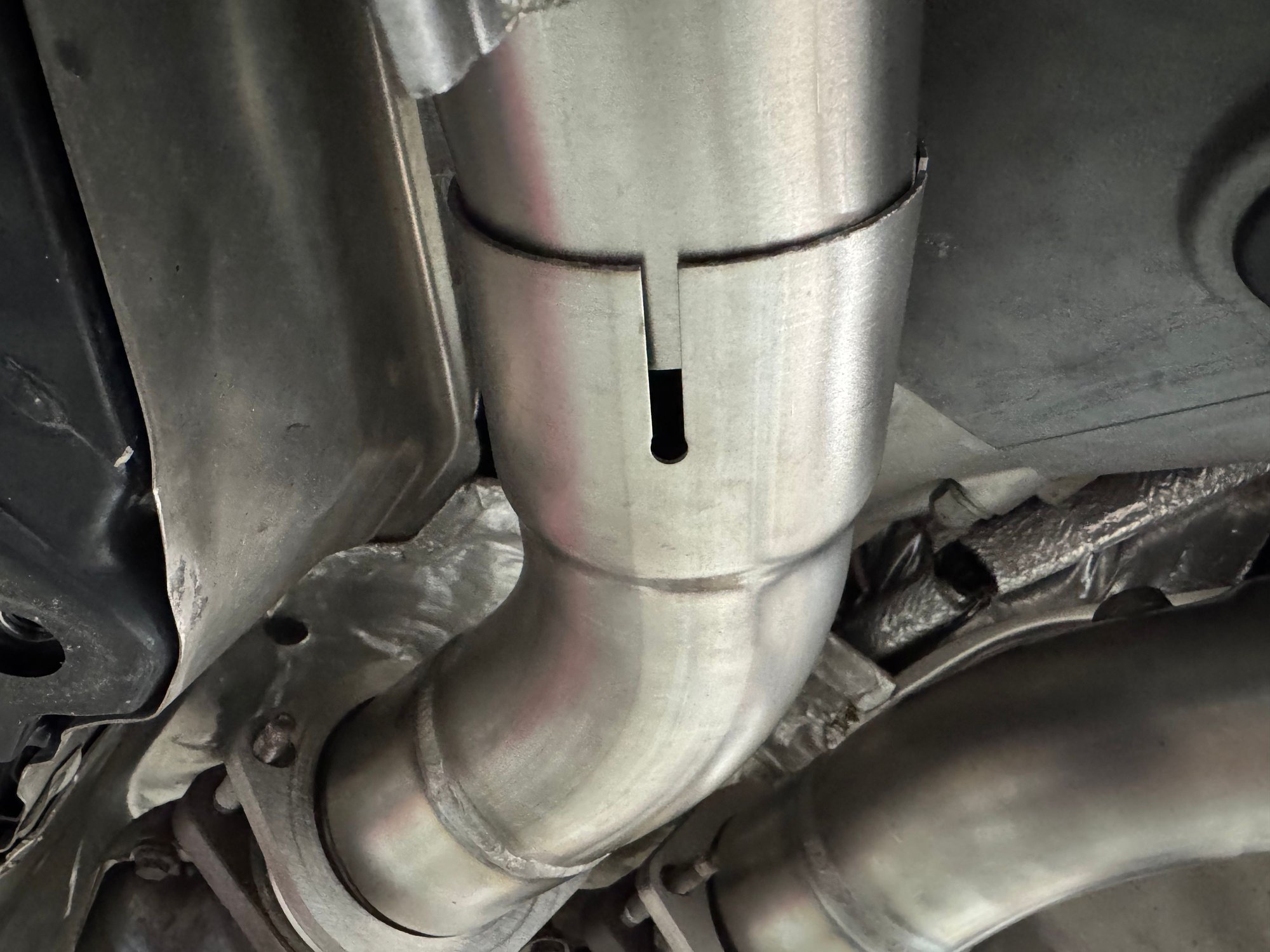

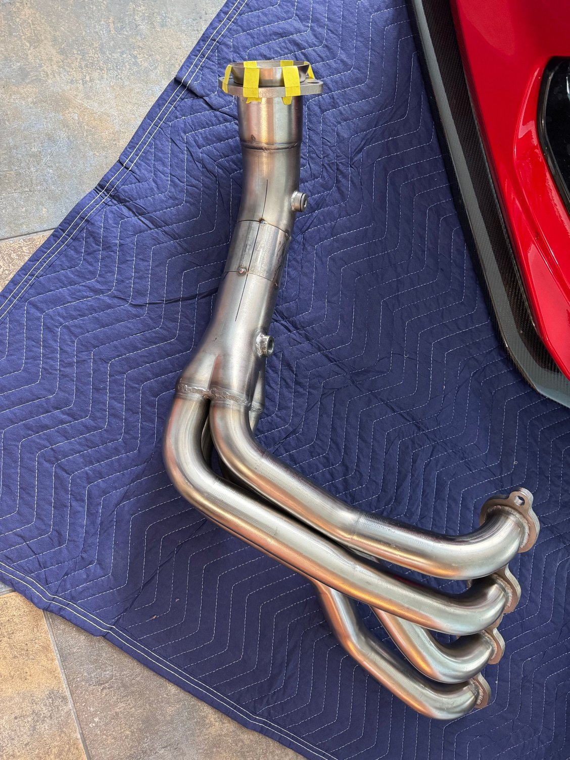

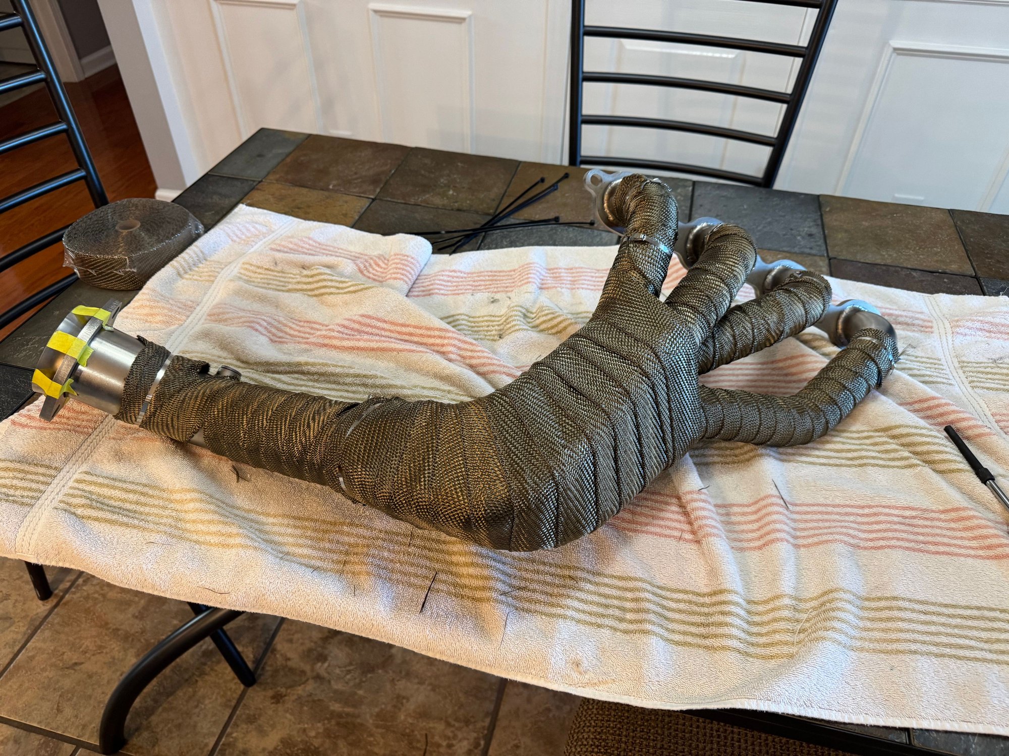

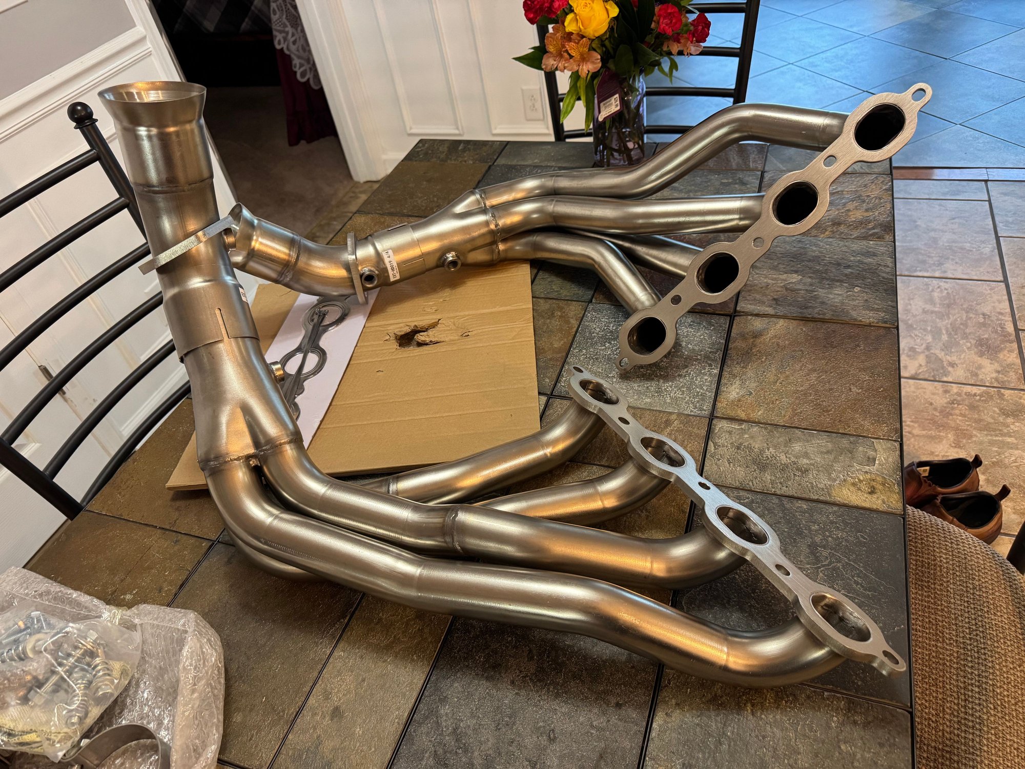

so I know everyone loves the arh or kooks long tube headers. my issue is THE COST!! ad in you need product specific mid pipes and the cost is 2500$ or more for a set.
I found these online waited a few months to get them in and I have say they don't disappoint. most headers are either 1.75" or 2" these fall in just inbetween at 1.875". flanges are thick 12mm and the entire setup is 321 stainless steel.
the only downside I can find is they are a slip fit connection at the collector . I didn't like that so I mocked them up marked them and clamped them and had my welder cut out the slip fit out tack in some straight stainless tube and I took them home for a test fit . all looks good dropped them off and he welded them up to what you see now.
the nice thing about these headers are you can run a oem resonator mid pipe if you like or a catless mid pipe. I have both they both fit fine! AND I didnt have to run any o2 extensions either. my oem pre o2 sensors dropped right in. post o2 will also work but I don't run those. (tuned out for catless and no emissions in my state)
install took me about 45 minutes per side mid pipe connection was a exhaust doughnut like stock. (eventually ill v bands welded in for ease of install and fewer leaks). wrapped them in DEI titanium wrap and slid them in place. zero issues. space from the body nothing hits the frame honestly theres just room everywhere.
EOS long tube headers cost was 653$ shipped to my door. doubt you will ever find a cheaper option!! ad in the 200$ for my welder and im still under 1000$ cant wait to hear the sound hopefully car is back together ion a few weeks

I would have had the headers ceramic coated vs that wrap, Kooks & ARH cost more because they fit well right out of the box with no modifications or trips to the local welding shop
ceramic coating is certainly an option. I chose not to spend 1300$ on a coating thats my choice. as for fitment one can easily use the slip fit and simply clamp them in place it works fine no different than the catback slip fit from the oem exhaust. I chose to clean it up since spending 200$ at my welders shop was approximately 1300 $ cheaper than buying the name brand headers. fitment in the car is as good as any setup on the market. arh 2" headers are a very tight fit so these at my hp goals of 800whp will do the job very nicely. if I was wanting 1000 hp or more than yes 2" would be the header to choose

Any pictures of the collector inside? I'm doubting it has a merge spike but curious.
Old Oct 8, 2025 | 05:41 PM
9sec's Avatar
9sec
Joined: Jul 2019
Posts: 3,827
Likes: 1,299
From: nashville TN
it does have a spike but I didnt take any pics. headers are mounted up in the car so I dont have any sorry

Would this actually be considered a long tube header? It looks very similar to ARH mids. The long tube collectors appear further down which is probably why they don’t work with OEM mid pipes. I’m not hating, just observing.

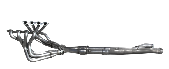

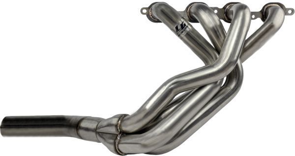

I compared all the big names and they are shorter than Stainless Works, but similar to Kooks/ARH/LG
SW:
https://stainlessworks.net/headers-2...Udb-qROzMaKnas
Kooks:
https://www.corvettepartsandaccessor...yYwb8V8x78amMZ
ARH
https://americanracingheaders.com/pr...nt=29943871300
LG
https://www.lgmotorsports.com/lg-mot...e-headers.html
