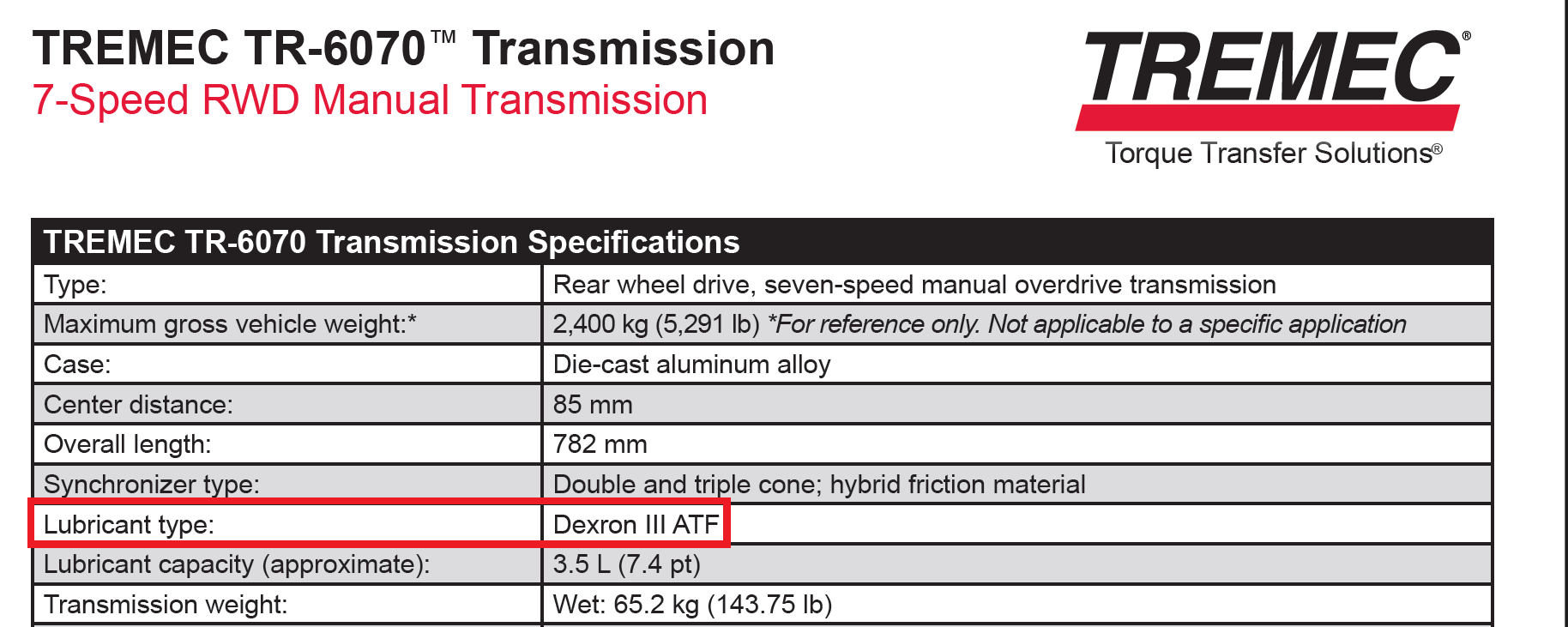

Originally Posted by TheGreenLanternC7
proving, once again, how unintelligent AI can be.
Excerpted directly from TR-6070 manufacturer TREMEC's (atchd) product flyer...
File Type: pdf

Corvette has used ATF in the transmission since 1997 (first year of the C5) with the original Tremec T56. That continued with the TR6060 in the C6 (2005-2013) and the TR6070 in the C7 (2014-2019). All years, all models.
Many use the factory fill, I use Red Line D4 ATF (in my 2013 and 2019), others use Amsoil, etc. Regardless.....it's a flavor of ATF that's used and not 75W90.
