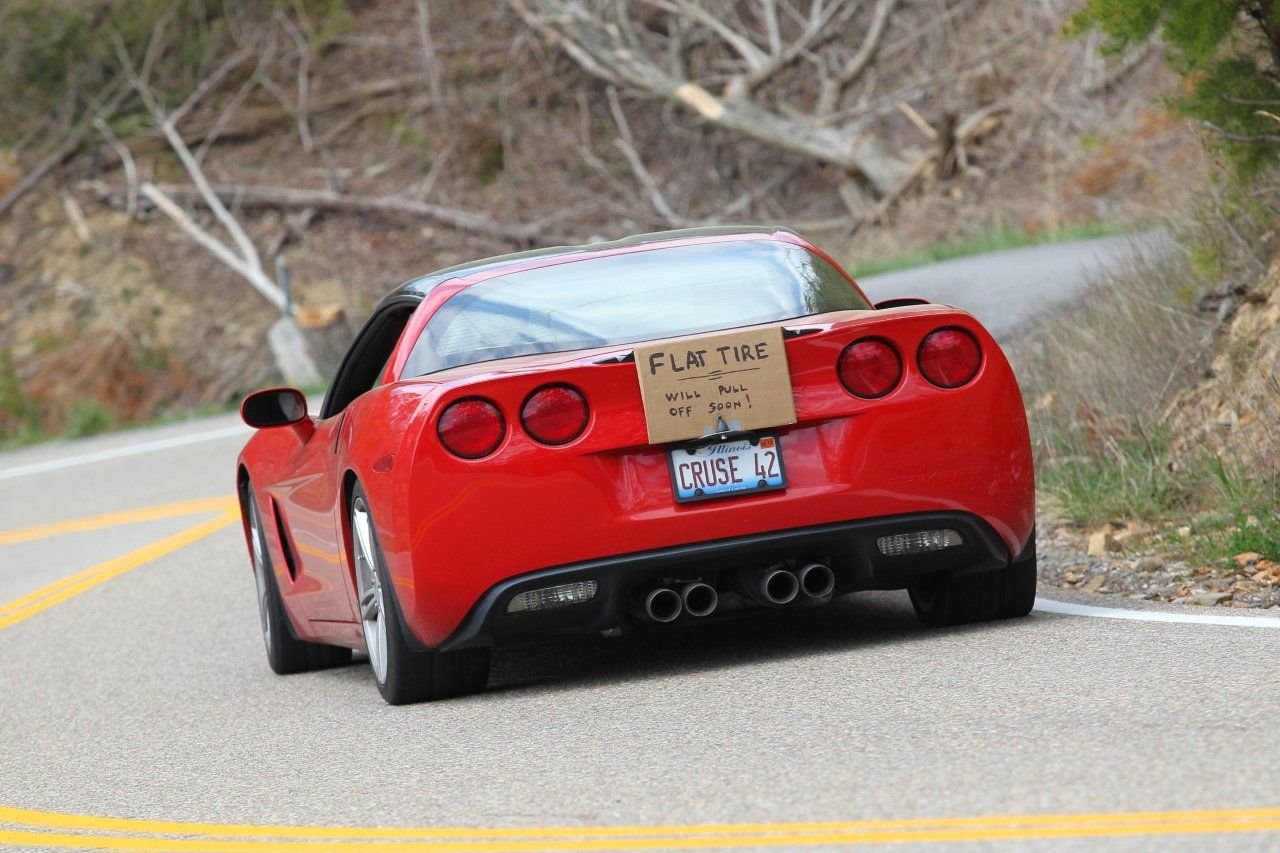

Run flats will get you a lot further than 50 miles.
Driving on a flat runflat will ruin the tire pretty quickly, even 50 miles is probably optimistic.
But if the tire is already ruined, or you need to keep going so urgently that you don't care about ruining it; you can go hundreds of miles on a flat runflat. I posted the question long ago in the C6 section and the "winner" had driven something like 400 miles on a flat runflat, he only stopped because he got home. I did not find anyone who had a runflat come apart.
We had a flat runflat (un-repairable sidewall cut) near the Tail of the Dragon and drove the Dragon on the flat, slowed down but kept on moving to a tire store about 30 miles away.
I do keep a compressor in the rear cubby of each of our cars for slow leaks.
