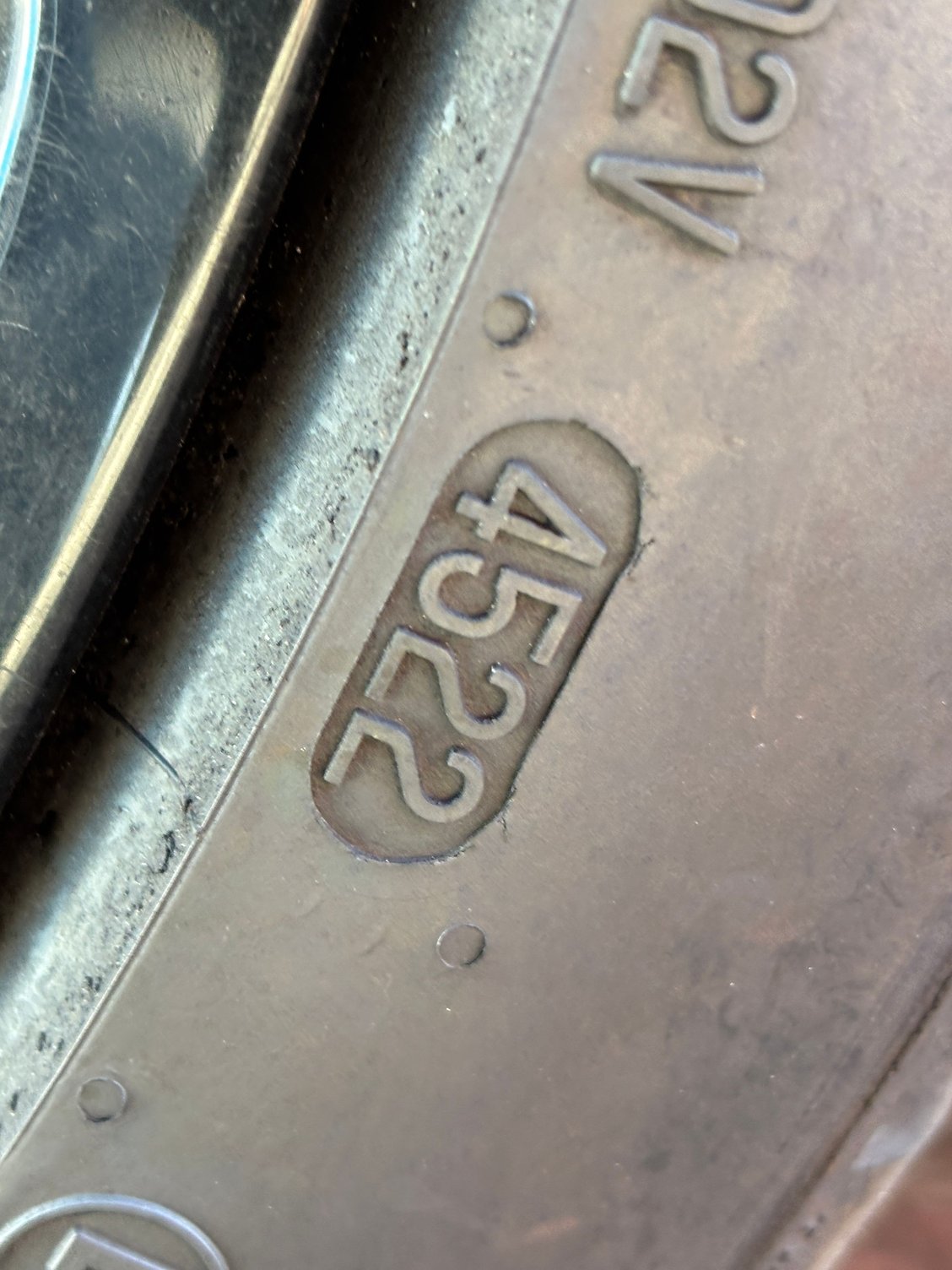

SuperdadZ06 do you know the age of your tires? Find the four digit number embossed on the sidewall. Let’s say: 4319. That would indicate the 43rd week of 2019, which is the last week of October.
This is the tire date of manufacture on my Stingray: first full week of November 2022.
