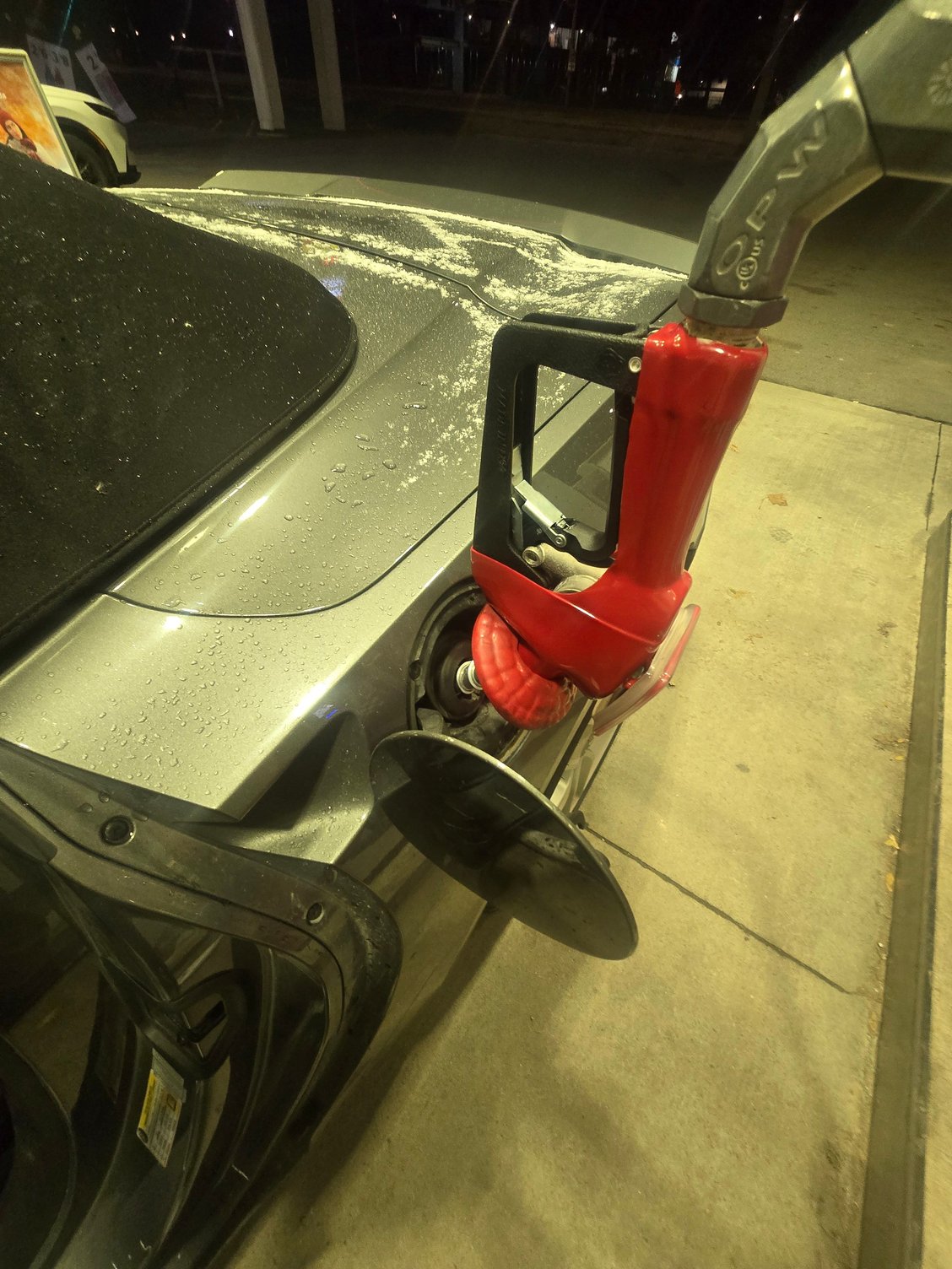

I was right on empty, and I figured I'd try the upside down thing.This station is the absolute worst for the nozzle clicking every few seconds.I got 3/4 of a tank before it started its BS tonight. Definitely a win 😁

I don't disagree with any of your points, I think they all contribute, but at the same pump at the same station to I filled up a 2024 Elantra without a single click until it was full, and even with the nozzle upside down, I only got 32L in before the filler neck backed up. I am certain the shape/angle of the C7 filler neck just doesn't agree with some pumps (in Canada the worst brands are Petro-Canada and Pioneer (usually use the same pump models), Shell and Esso/Mobil are better for me.

you have far more nozzle inserted upside down than i ever see with handle upright + i try to fill-up at 1/2 mark!!
