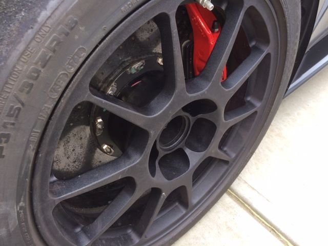

Hi everyone!
I’m trying to find out if C5 Z06 rear wheels (18x10.5) will clear C7 Grand Sport / Z06 iron front brakes.
I have a set of C7Z brakes that I have been procrastinating on installing on my C5 because I don’t know if they’ll clear.
If anyone with a C7Z or Grand Sport could test this out, I would greatly appreciate it.

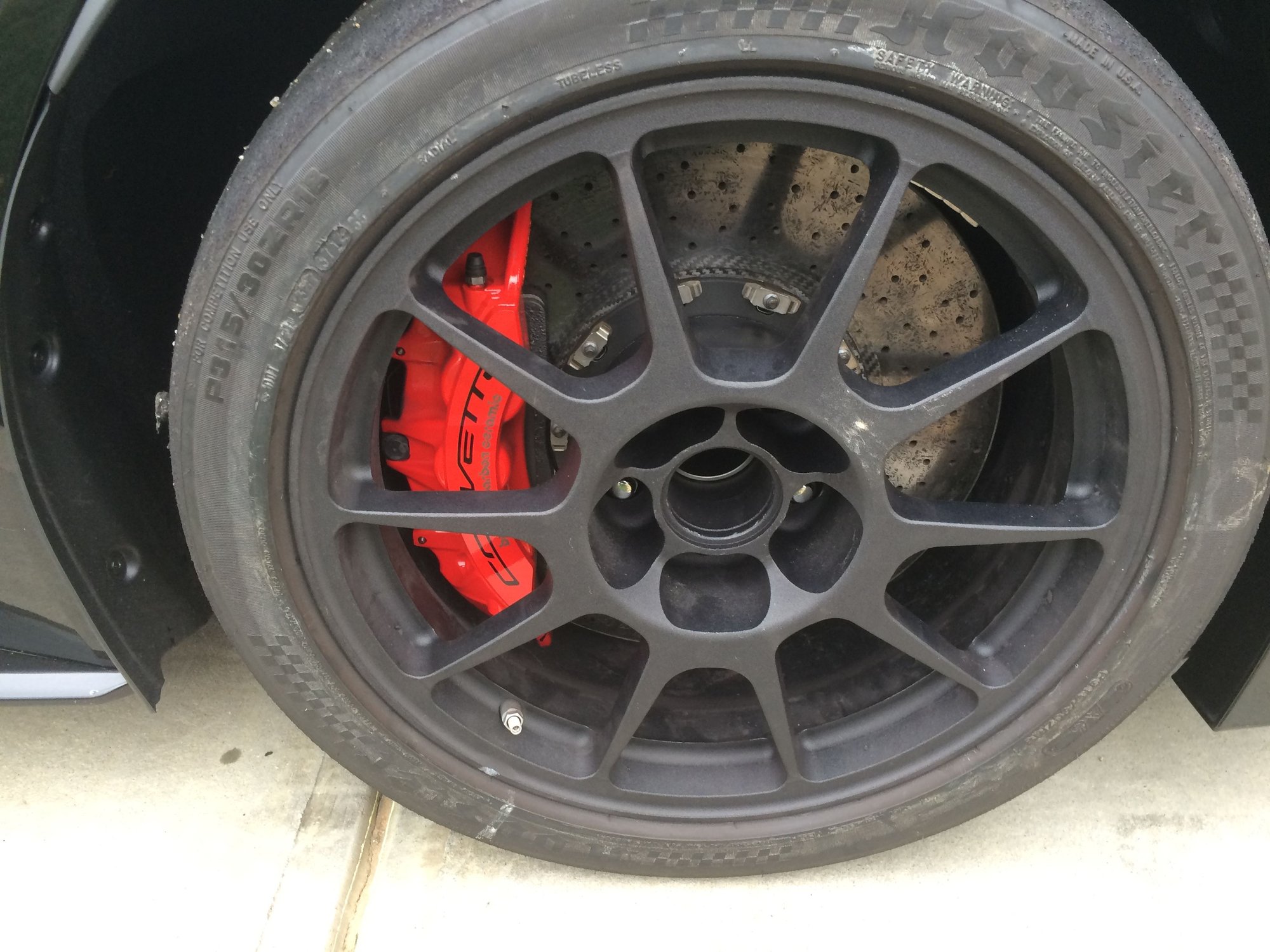

The diameter will clear (I use 18x11 CCWs on the front of my Z06 with CCM brakes, which are larger than the standard GS/Z06 front brakes), but I suspect the spokes may not clear, as the C5 rear wheel doesn't have sufficient offset to push the back of the spokes outward enough. My front CCWs have a lot of offset as shown in these pictures:
Bill
Bill
Hi Bill!
Thank you for sharing! I’m glad 18” will clear! I’m hoping that I can throw a spacer (and possibly longer studs) with the Z06 wheels until I can buy something that fits correctly. Not ideal, but at least I’ll be able to roll the car out of the garage. 😂
