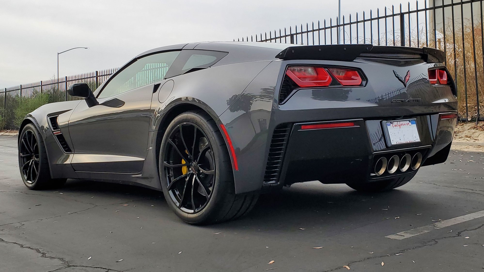

I get it.. let's fill up that huge gap in the wheel wells with some hot rubber to grab the Earth!
Do you have the stock wheels? 19's and 20's will give you "taller" tire options if this is what you are after. eg 305/30/19 (26.3" diameter vs OEM 25.7") fronts and 325/30/20 rear (26.9" vs 26.6) Nankang CRS top 200 tw below:
These top 200tw autocross competition ready tires definitely feel great in the "curves" even with the extra height!!
Note: I do run shorter tires with 18/19 now since I compete on the weekends.
As others said lower and wider is also faster generally, but this setup has plenty of grip, was more street friendly with the height, never cracked a rim, and in my eyes looked the best filling up them horrendous fender gaps!!
