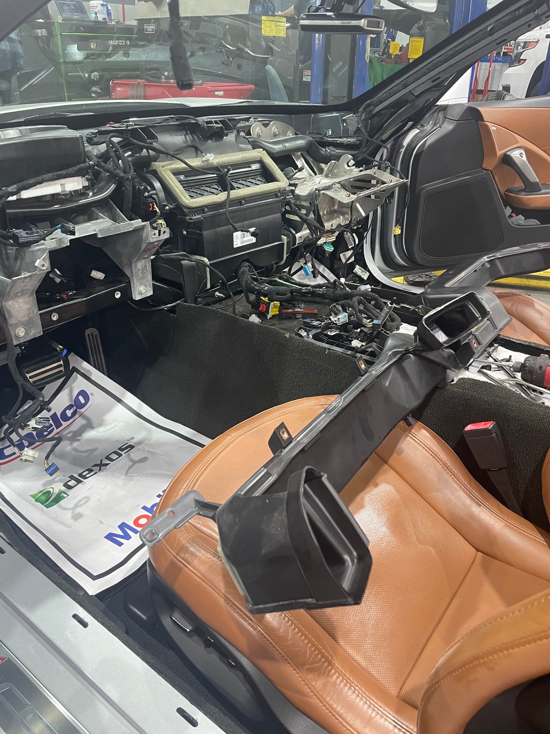

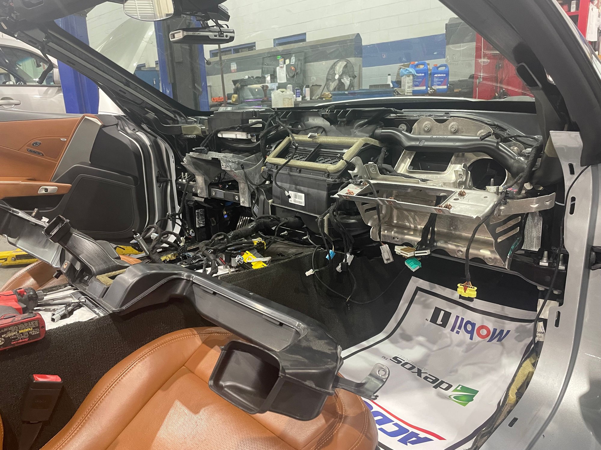

If your 'dealer' is so good why did he leave part of the dash with the sharp metal mounting brackets laying on your expensive seats. It just yells to me. you're going to have a tear or scuff.
When I was working in high end corporate aircraft we weren't even allowed to enter the cabin with shoes on, socks only. And they already had runners on the floor and all seats covered. And don't touch anything you're not actually working on. And when finished, get out, no sight seeing.

Circling back to this...
Finally pulled the trigger and took my car into a local Chevy dealer that has done excellent body work for me in the past. Went on a ride-along to show him there were no rattles, squeaks, etc. before I left the car. He actually noticed that I had 3LT bubbles on the dash, on both sides of the heads-up display. Good thing I took pictures before I dropped it off that showed the bubbles--about 2"x3"--or I would've sworn they were caused by the dealer removing the dash! I just never noticed them...maybe it happened recently because there were some hot days in SoCal. Or maybe the leak in the evaporator core built up pressure behind the dash that migrated up to the top? (But that seems doubtful?) So I remembered bikerdkh's post above discussing the procedure. Very helpful.
