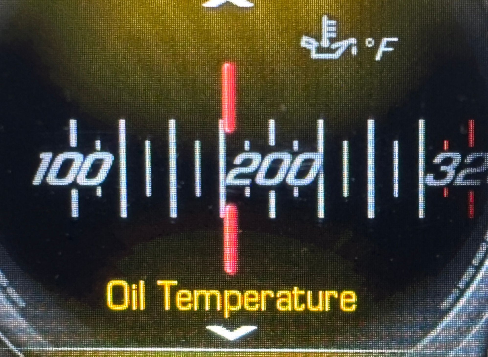

This is my typical oil temperature after driving my 2016 Stingray Z51. I understand this is not a precise gauge but it looks like the temp is around 177-178 F. Maybe 0w-40 is not needed for my car.
I understand the push for 0w-40 Mobil 1 started after a very few 2014-2016 Stingrays (Z51 and non Z51) encountered engine failures on track days. I understand C7 engine oil temps can soar up to and beyond 280 F while on the track.
Rather than redesign the engine to improve the oil pan, oil pickup, baffling and pump calibration, GM came up with a new oil recommendation.
For me, it is not about the price of the oil. I will buy whatever oil is required. My concern is what will thicker oil do if it needs to flow into tiny places in the valve train but my engine oil temp never gets past 200 F.
Toyota recommends 0w-20 full synthetic for the V8 (with 32 valves) in my Tundra, and that is what I use. Tundras like mine are going beyond 300,000 miles. They have a towing capacity of 10,000 pounds.

Photomania, at that oil temp, unless you have an extended warranty that requires it, or change your driving habits so that you often run 200 and sometimes get to the mid-200’s, I see no reason for you to risk the 0W40 VI improver problem. For my driving habits, I would actually pay money to avoid a dry sump Vette because it extends warmup time, runs borderline too cold on oil on the street even when warmed up, and it isn’t even remotely needed on the high end. If I inherited a dry sump car, I might consider putting an oil temp thermostat its oil cooler to reduce the warmup time. Unless you are in a very cold climate and actually drive it in the winter (those in snow country seldom do), the 0W to 5W difference isn’t enough in my mind to justify the VI improver problem with 0W40.
As far as the Toyota Tundra comparison, I’d be reluctant to use that as justification to drop to 0W20 for your Vette situation. Bearing clearances, materials, and configuration also factor into oil viscosity recommendations. I have no idea how those factors compare between the two engines.
