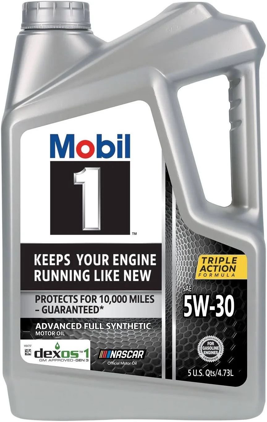

Originally Posted by ball-z
hi guys getting ready to do oil and filter on my 2016 base vette and getting alot of different part numbers (ie 5-30 syn oil then 5-30 dexos mobil 1 then 0-40 mobil 1 dexos 2 then oil filter pf 64 then delco upf64R)
What Mobil oil is being used? thx
I called the parts department at the Chevy dealership where I have my warranty on my 2016 stingray Z51 and I asked them what kind of oil to use and they said Mobil 1 5W 30, Dexos1, Gen. 2 or 3. That is because I do not track the car and I never drive crazy. Others on the forum who track their car probably use Mobil 1 15W-50.
Many Corvette owners also like Mobil 1 ESP 0W-40 as an upgrade option and as a middle ground between the other two oils, especially if they do a lot of spirited driving.

thx for the info photo

Originally Posted by Photomania
I use that oil as well as a PF64 oil filter.
