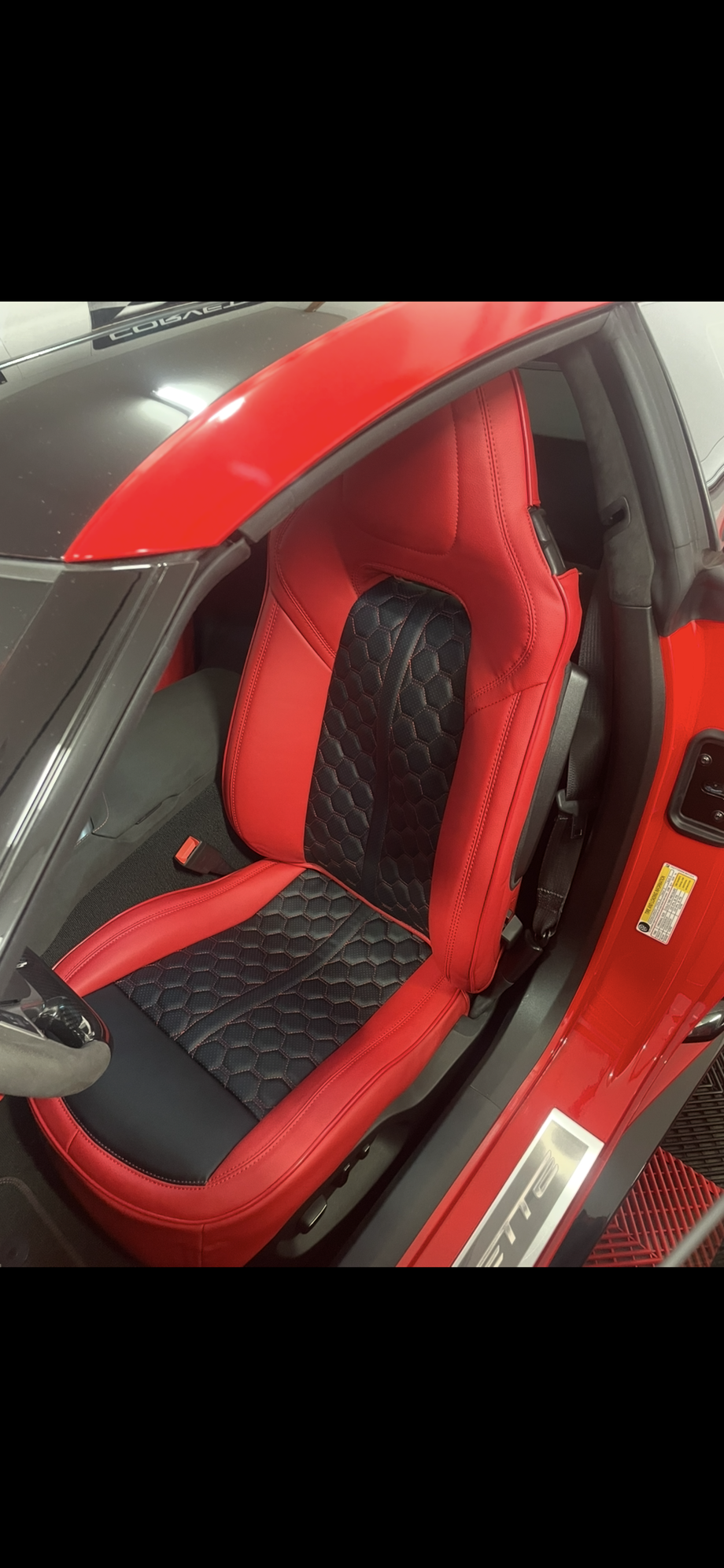

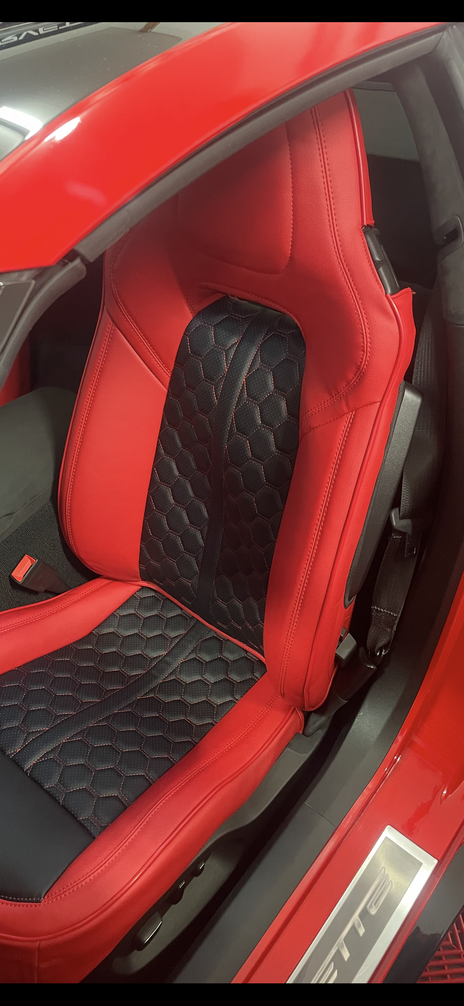

Granted this was on a C8 Z06, but I saw some in-person at our local cruise tonight...looks like a quality product...

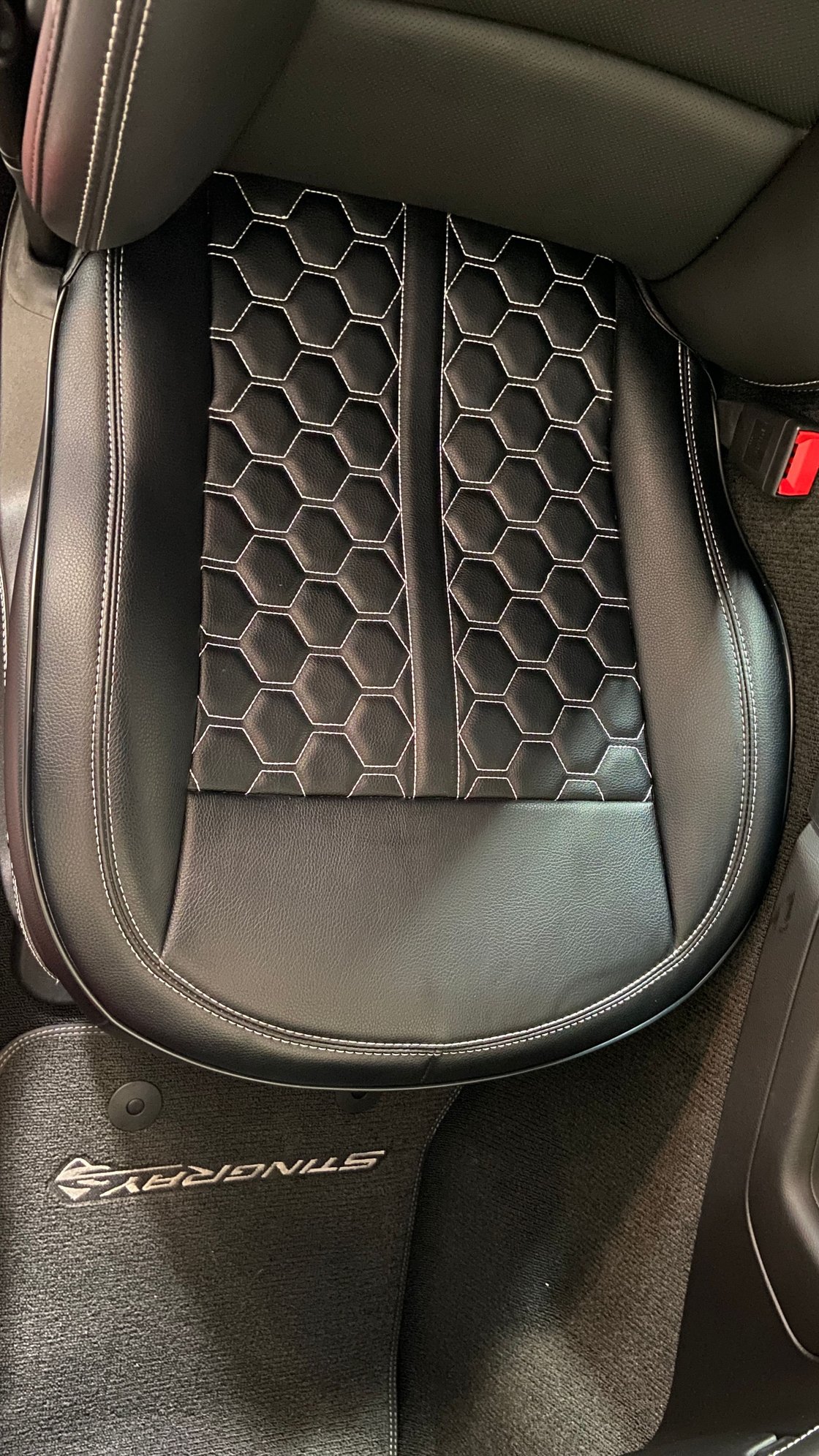

Have them for approximately 3 years now .
I added the Stingray logo to make it look a bit more original, love how they look in the car.
Take your time to install them correctly and the fit is very good.
Overall, quite happy with the quality.

@I8URRICE - how did you add the logo?

Logo was purchased from GM dealer.
It has 4 pins at the back, I used a hole punch to put the four holes on the cover and then attached it with 4 Starlock washers ( purchased from Amazon )
The logos come with a spring clip in the package but you have to be careful using those, if you don't press it down evenly the tabs on the logo will break, I learned that the hard way
I also glued a leather patch behind the cover over the pins to prevent it from damaging the original seat covers.
