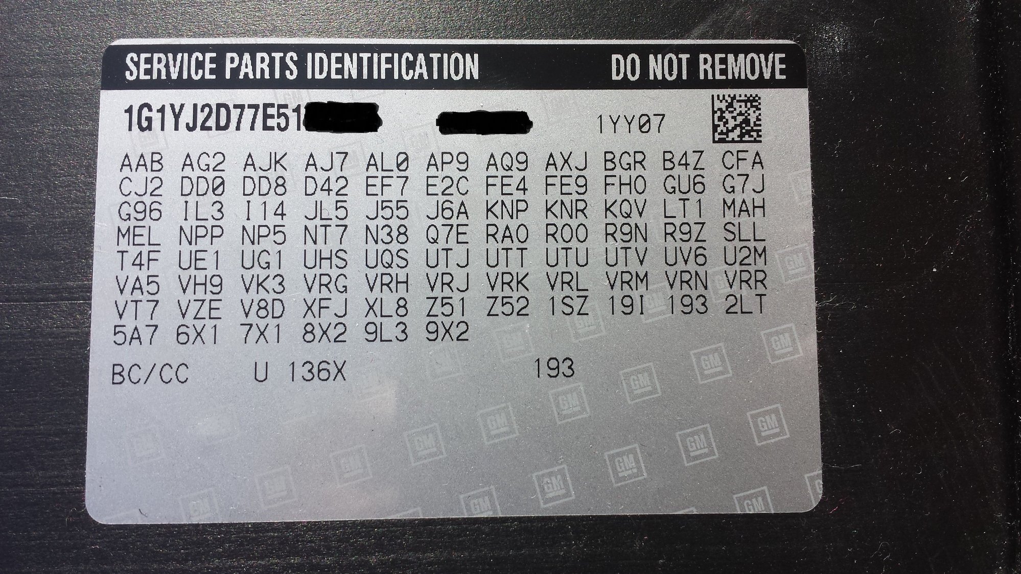

I know this thread is old but wanted to ask a related question.
Recently bought a 2014 A6 coupe. I removed fuse 41 for the npp valves but it seems to have not made a difference. In weather, eco, and tour modes its quiet. Sport is a bit louder, track is a bit louder than sport but it all sounds the same as it did initially. Anyway, has anyone had this happen after pulling the fuse? It seems to me its like I didn't even remove the fuse but I know it was the correct fuse.

Are you sure that your 2014 has Performance Exhaust? It was optional in 2014. Can you see the valves in the 2 outboard exhaust pipes? They should be open with the motor off and stay open at all times with the fuse removed.
With the fuse in, the valves stay closed most of the time and pop open around 1800 rpm or above.
It is possible that you don't have NPP, the actuators have failed / valves stuck closed, or have aftermarket exhaust without the valves.
Ron

I don't have the NPP RPO code, but my exhaust does have the valves. They are open while the car is off. The fuse is out but when I change modes or when I hit the 1800 RPM area, I can tell it gets louder then quiet again at lower RPM and on the highway. Completely quiet as if the fuse was still in it. That's what I found odd is that it seems like I didn't pull the fuse. I had to check three times after pulling the fuse to make sure I didn't pull the wrong one.

LOL - the RPO code for Performance Exhaust is NPP...
If the 20 amp EXH2 fuse (#41 (2014), #42 (2015 - 2018), #87 (2019)) is pulled you should only hear the exhaust get louder with rpm.
It might be worth having someone watch the valves or set up a camera to video them as you change rpm. You might want to use a mirror to keep your observer or camera out of the exhaust... If the valves are still moving, the stock wiring has likely been modified.
