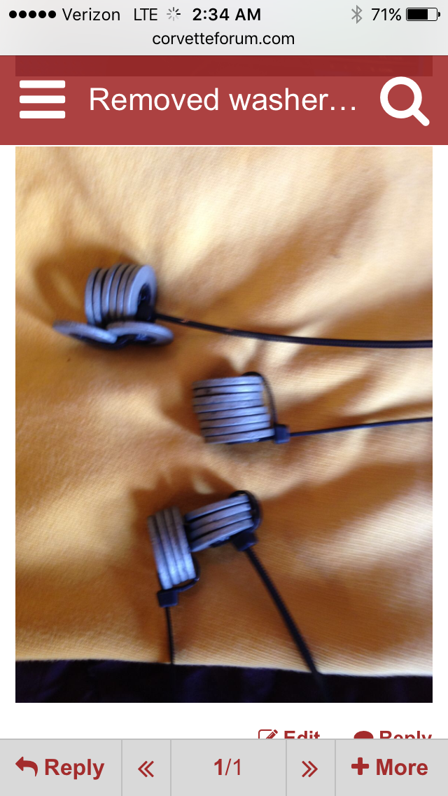

Originally Posted by savage
i did look for the shims that fell out (lol) in the past, i was not sure if taking out washers was ok, now i know. i just need a little more and did not want to grind anything, also with your thinking adding ones to the bottom would give someone even more.
You can not add any washers to the bottom as it is on the eccentric.

Originally Posted by chets ls3
Has anyone found the proper solution for toe issues in the rear beyond -1.2-1.4 camber in the rear. At 1.5 rear camber toe is off 18 degrees
Remove the washers!! The sky is the limit then , -2.0 camber and toe in is easy !!!

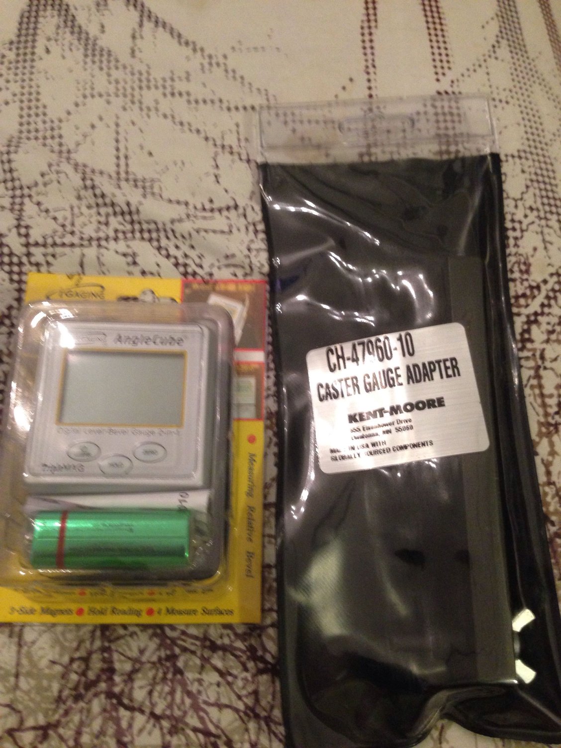

Thanks guys. They didn't remove the bolts up top but still
Managed -1.5 in the rear with .05 toe. -2 in front with 7.7 caster. Iirc. I'm
Still trying to acquire a rear caster tool
Old Aug 5, 2016 | 01:44 PM
savage's Avatar
savage
Joined: Jan 2014
Posts: 1,078
Likes: 262
From: swoyersville pa
I have tools !! Now to find someone that understands how to use them . Cube was $20.00 on eBay and adapter was $160.00 at Chevy dealer .
