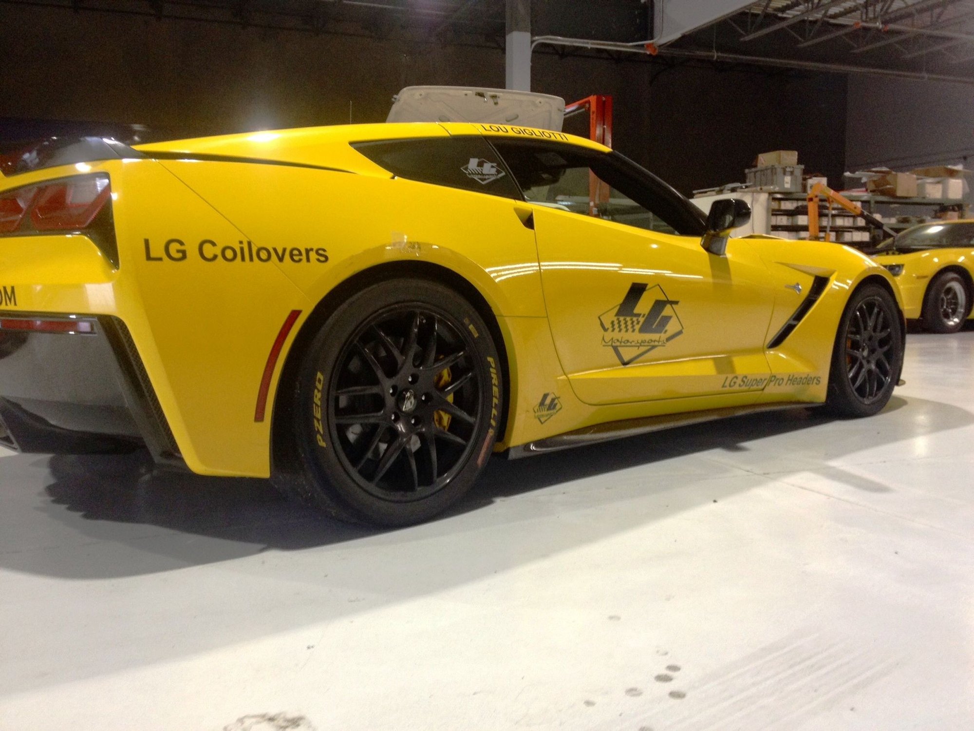

I kept it simple on our shop car....1/2" wider wheel and 1" wider tire (265 front and 305 rear's)
Talking to Dave at Forgeline if you want to go really radical you can stuff a 305 under the front of the car and a 315/325 in the back. The only issues is that you will loose some travel with it, and the tires rub at full lock on the front but for those wanting an aggressive AutoX or road course setup, that is the most you can stuff under it.
Our first C7 with the 265/305 combo

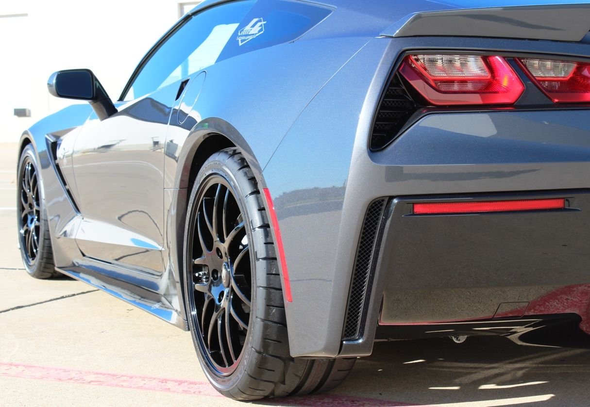

This is the ForgeLine car with 305's on the front and 315's on the back

Originally Posted by Bryan Wharton
Anthony what wheel off sets are on the picture with the 265 305 combo please?
If memory serves me correct.....the front is a 18x9 at a 54 and the rear is a 19x10.5 at a 79.

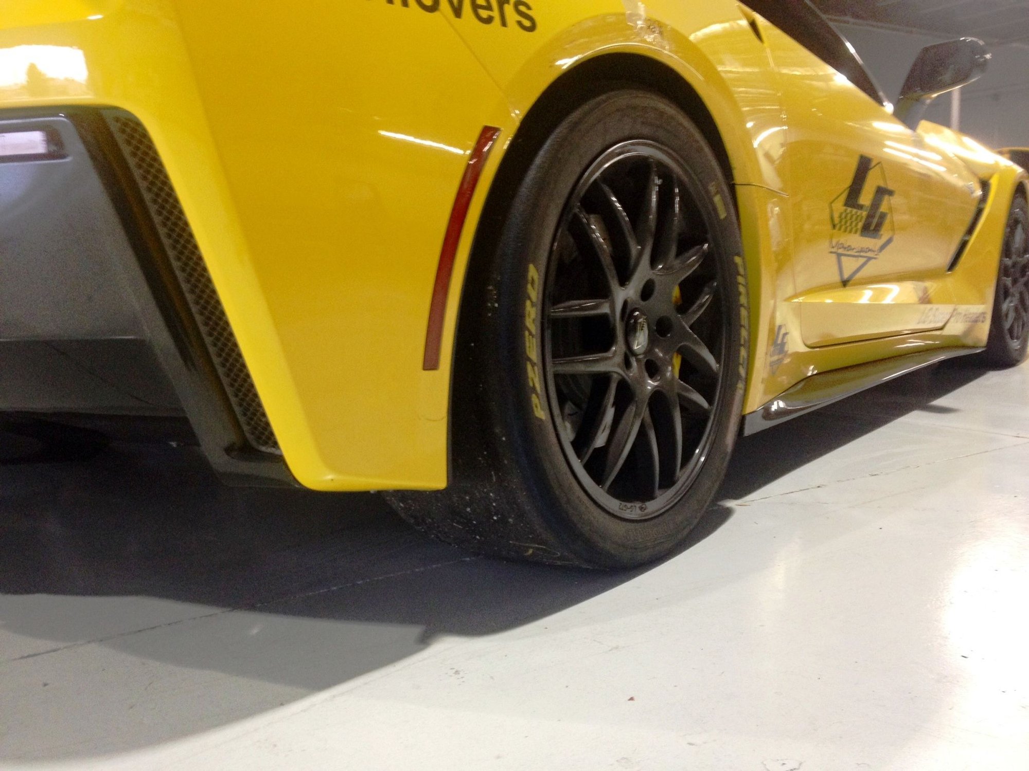

Just did a quick shot of our car with the slicks we have been testing on it.
265-650-18 front and 305-685-18 rears mounted on our GT2 wheels in black.
I have a complete new set already mounted ready to ship too!
