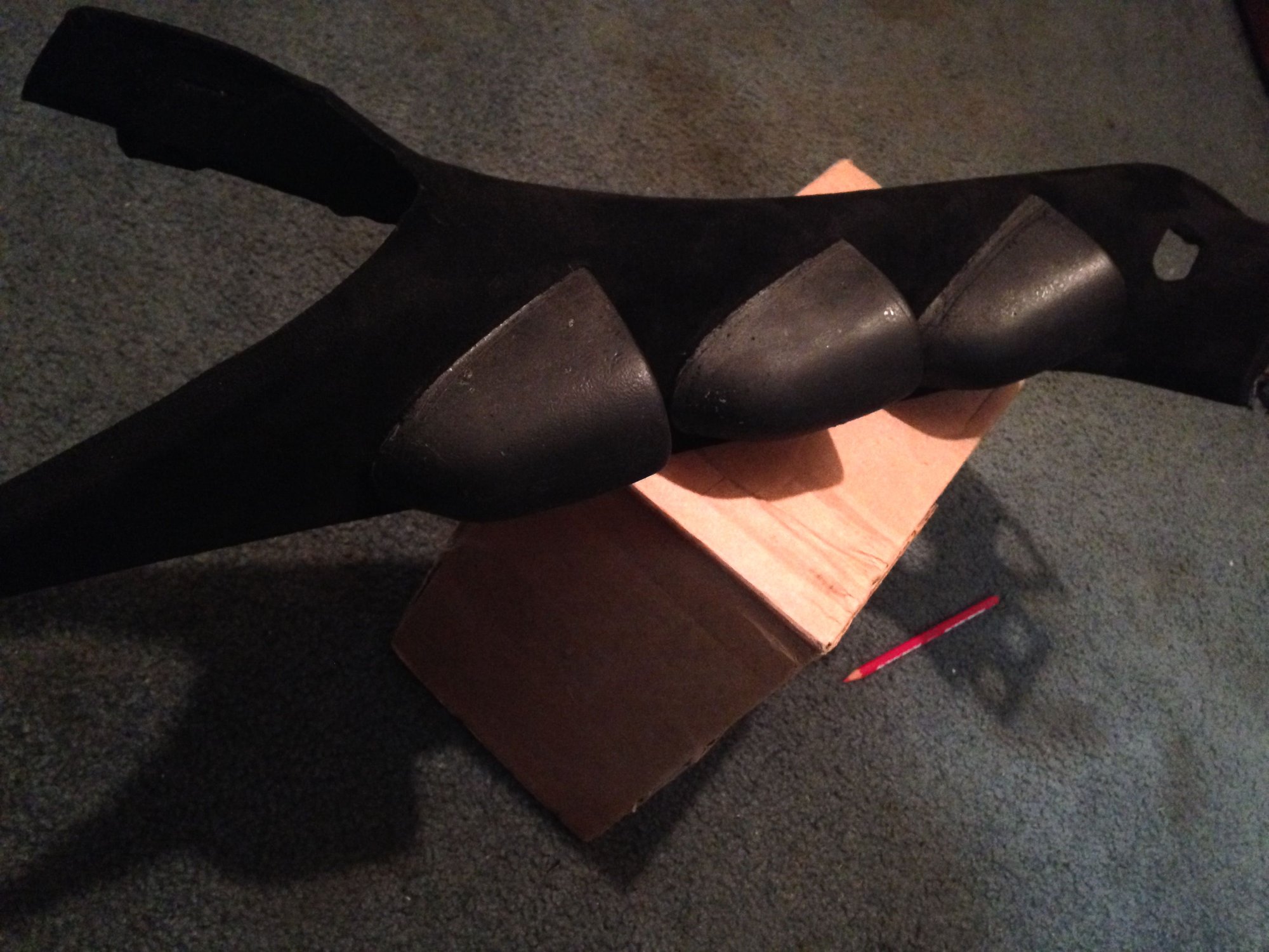

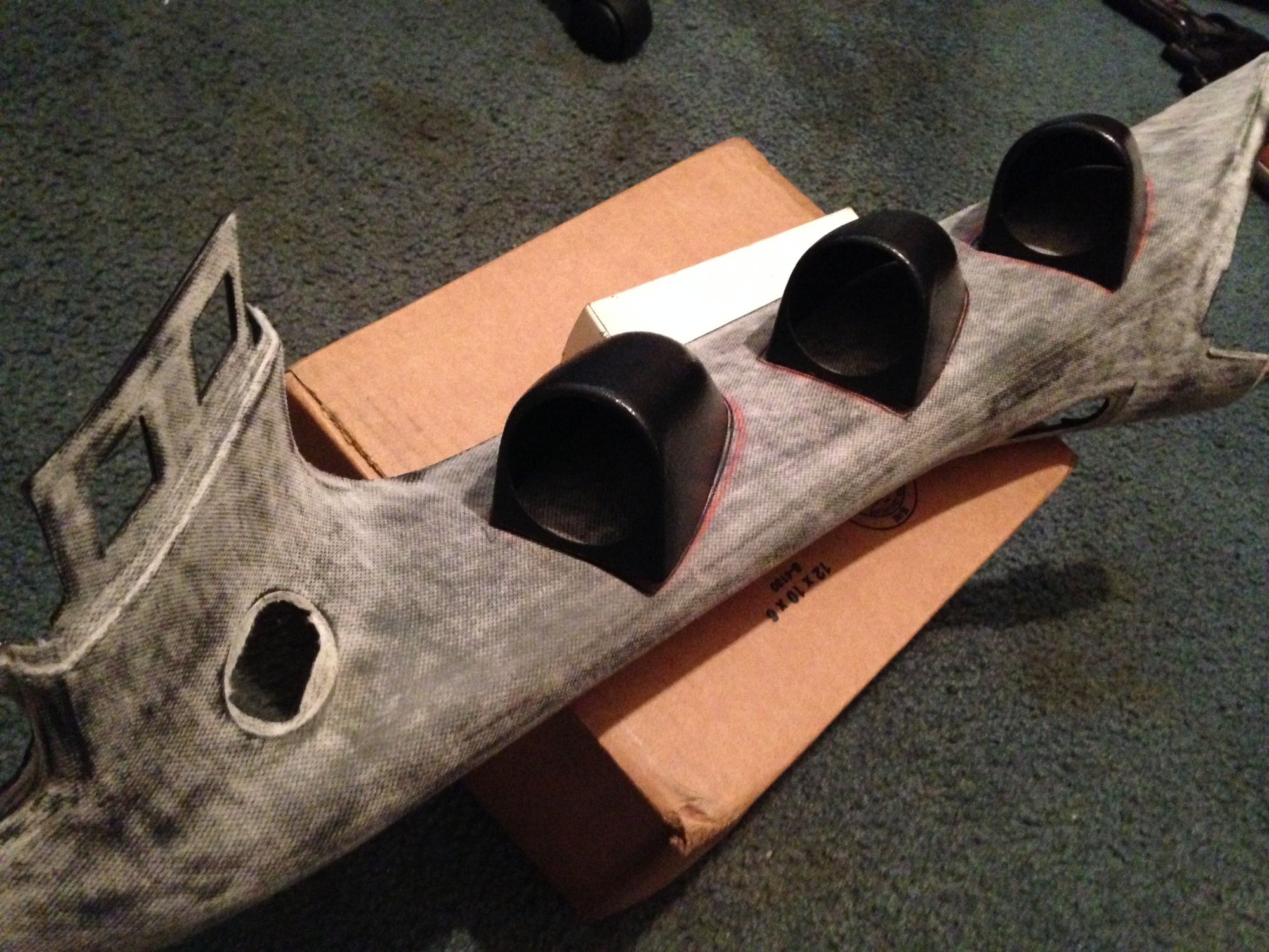

Originally Posted by Randy WS6
I know you don't want a pillar pod mount setup , but heres one that I made, to give you a idea.
Can you tell me which 3 gauges your using and where you bought them. and and advice how you made your look so good. Thanks for your help. They make the car look so much snottier.
Allan
the gauges are (PLX Wide bands) & (PLX Vacuum/Boost) and can be ordered from PLX or Summit Racing or Jegs or maybe a Sponsor on here.
I used universal gauge pods and cut the contour to match the pillar, then epoxied them in place and covered them in black suede , witch was a pain in the ***, lol....

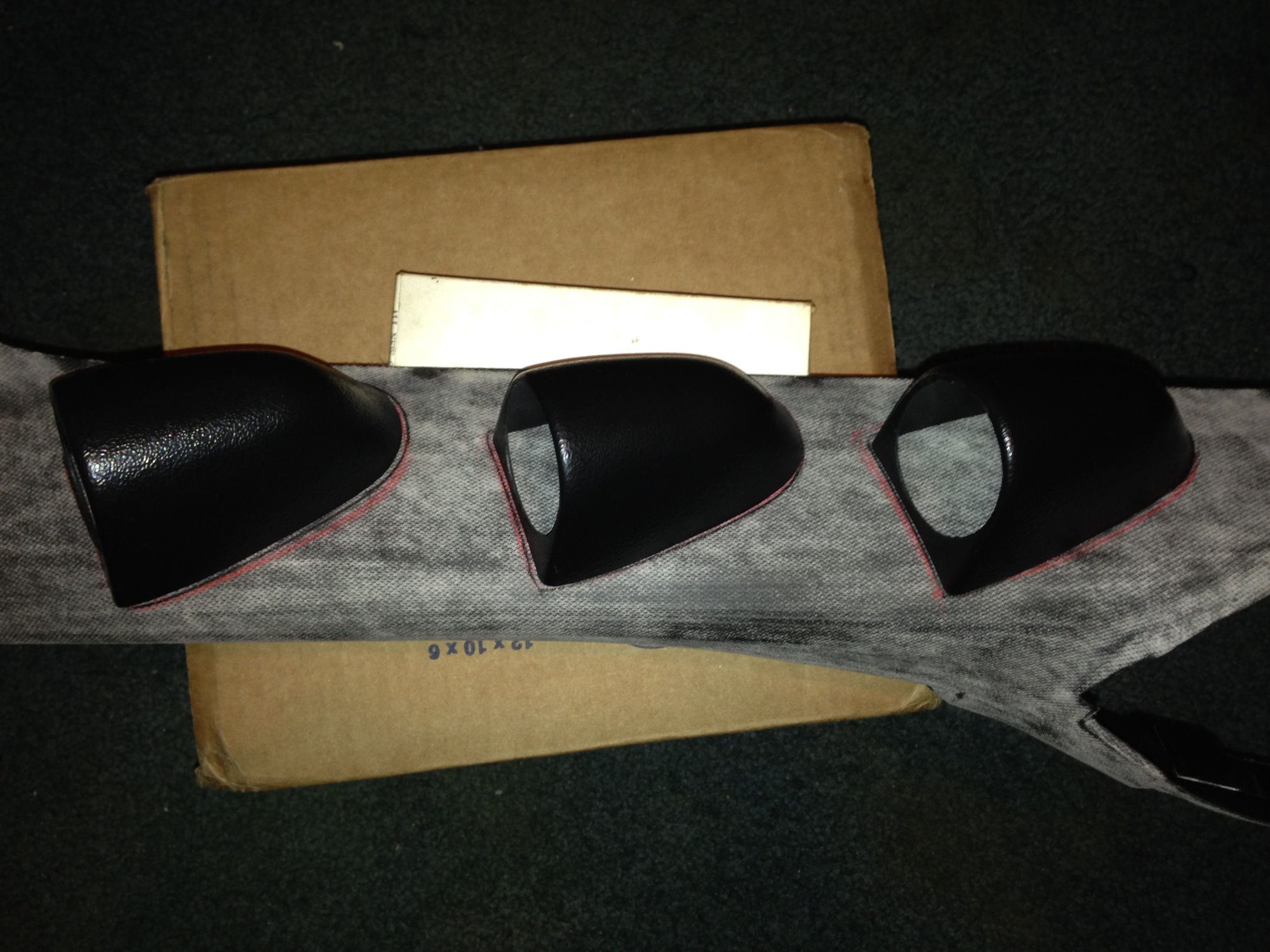

C7 of Year Finalist (performance mods) 2019
Just received my gauge pod from Ortiz custom gauge pods. Some quick picks. Haven't seen it myself as I'm in Las Vegas, but my girlfriend was kind enough to snap some pics. I will cove with sued,
