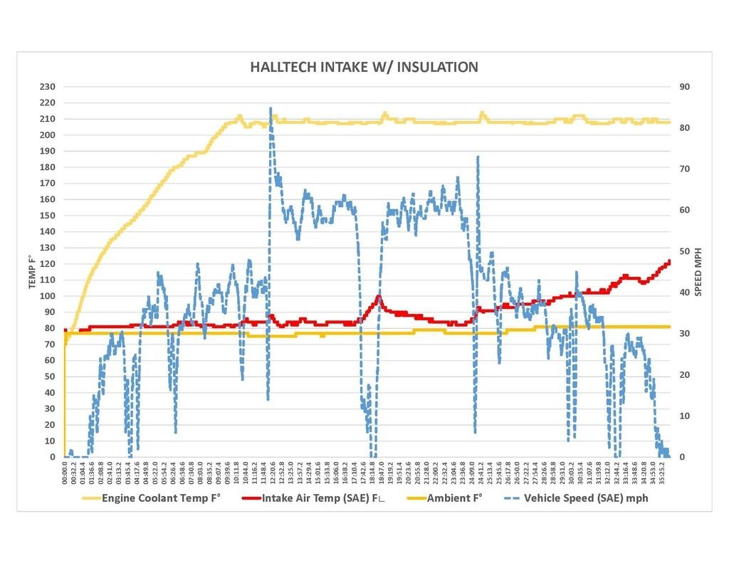

Old Apr 30, 2015 | 05:49 PM
  #52
RussM05's Avatar
RussM05
Joined: Jun 2012
Posts: 2,226
Likes: 1,029
From: Thomas Texas
Here is a graph of the scan I did last night using HP Tuners and export to Excel feature.
The scan is 37 minutes long. The temp display on the infotainment screen showed 63-66° but for some unknown reason, the scan with ambient was +7° higher. Oh, well, but the real important thing is watching the IAT change.
Pretty interesting stuff. Love gathering the facts to support theory.
(Ceramic coated ARH mid-length headers and stock thermostat)
The red line is the IAT and the green line is the ambient and the dotted blue is the vehicle speed. Notice how the IAT starts to rise when the vehicle speed drops below 50 mph during the last 3rd of the scan and right at the end where speed was zero, it increase to 109°. No surprise, once up to temp, the slower you go, the more it goes up. Makes sense because less fresh air is moving thru the intake tube and heat soak
Right in the middle, when the speed dropped to zero, notice it increased again but dropped down pretty quickly.

Here a graph of the Halltech scan from March.
First, its not a fair comparison to the first graph because I was really pushing it on the backroads of Central Texas. Look at the MPH changes as well at the ECT.
Second, look at the temp increase over ambient and the absolute IAT temps. It is higher than I would like for sure.
I've been fighting the radiator hoses being too close the Halltech air filter box. I am having trouble getting them away from the carbon fiber box. I've added insulation around the hoses and air filter box but the IAT are still higher than I would like.
I'm going to a fair comparison along the same route I took last night and try to match the speed.

Here is a graph of the Halltech intake. Same cruise as the stock air intake.
Ambient last night was about 10° warmer than the previous night when I scanned the stock intake. Notice during the last half of the scan the IAT gradually increases and especially below 50 mph. The spread between the ambient and IAT is what I look at.
I've wrapped the radiator hoses in insulation and added insulation to the outside of the air filter box. Not pretty......
Just to understand how hot it gets behind the radiator, I had another test with just the air filter in the engine compartment right above the anti lock brake module. That one reported IAT of 160°.
