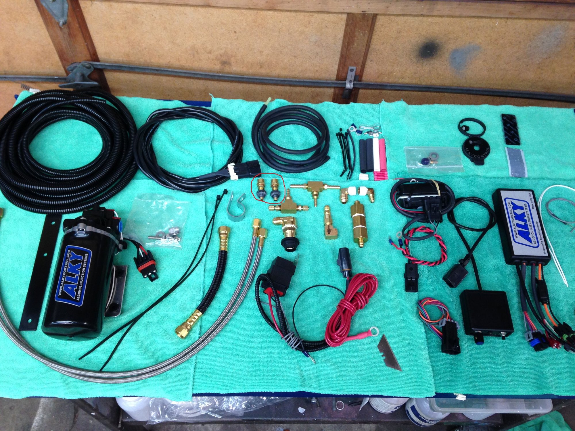

What did everyone use to plug the lower bung in the washer tank when removing the WW fluid pump?
I'd like to do something similar to Randy's setup, but I have no idea what to shove in there (size-wise) to seal the hole permanently [oh boy does that open a big window for jokes]. Once it's capped with an appropriate piece, I intend on siliconing it in place to prevent any methanol seepage.
In the pic you will see 2 brass barb fitting with 2 rubber grommets circled in red at the near upper middle left hand side of the pic,That's what I used to plug the holes in the factory WW tank . click on the pic and zoom in to see it better.
