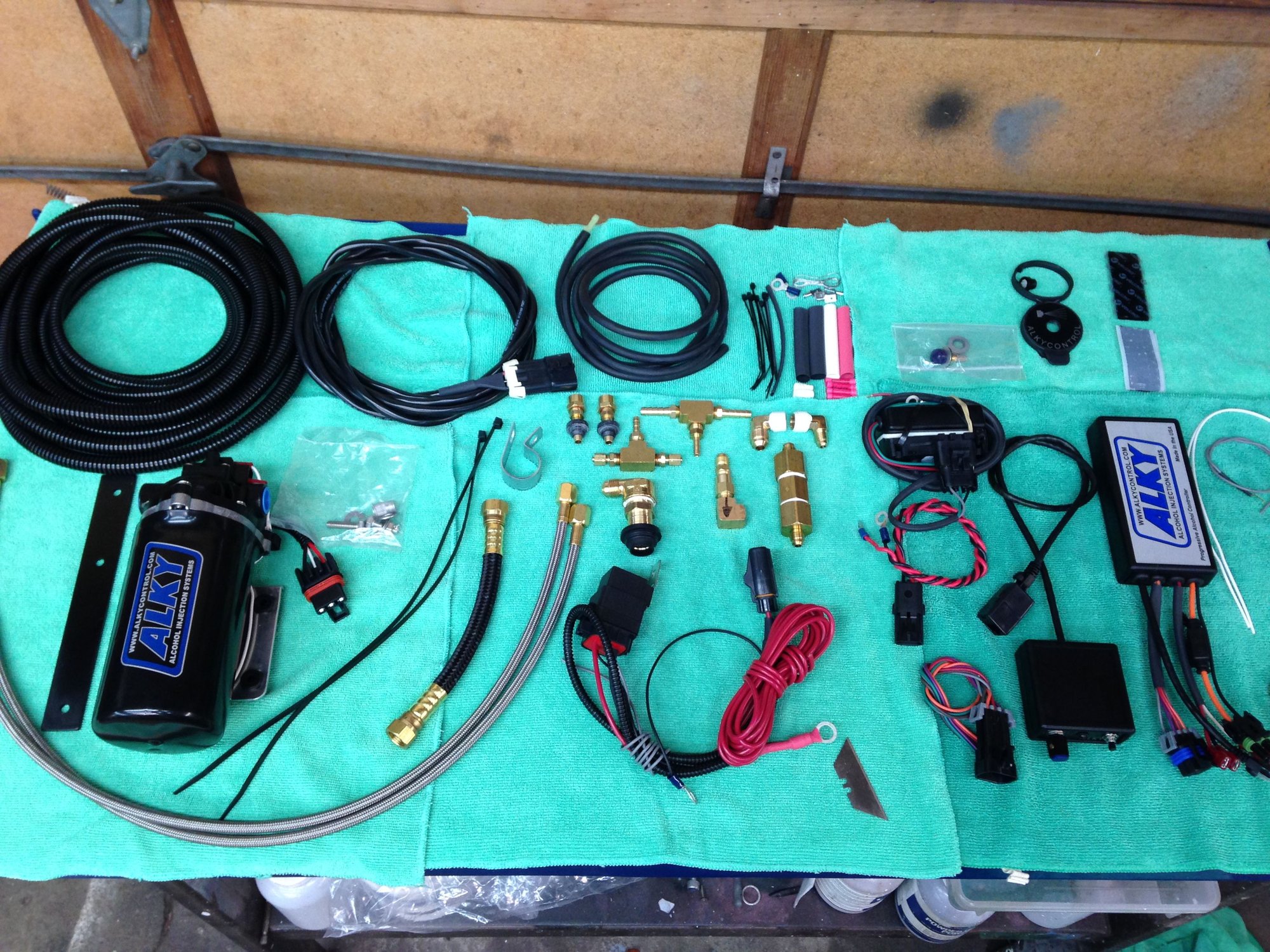

I have the Alky kit from ECS and its designed for the washer tank. But I would say that they can hook him up with a custom tank. Here is a pic of there kit that I got for my C7

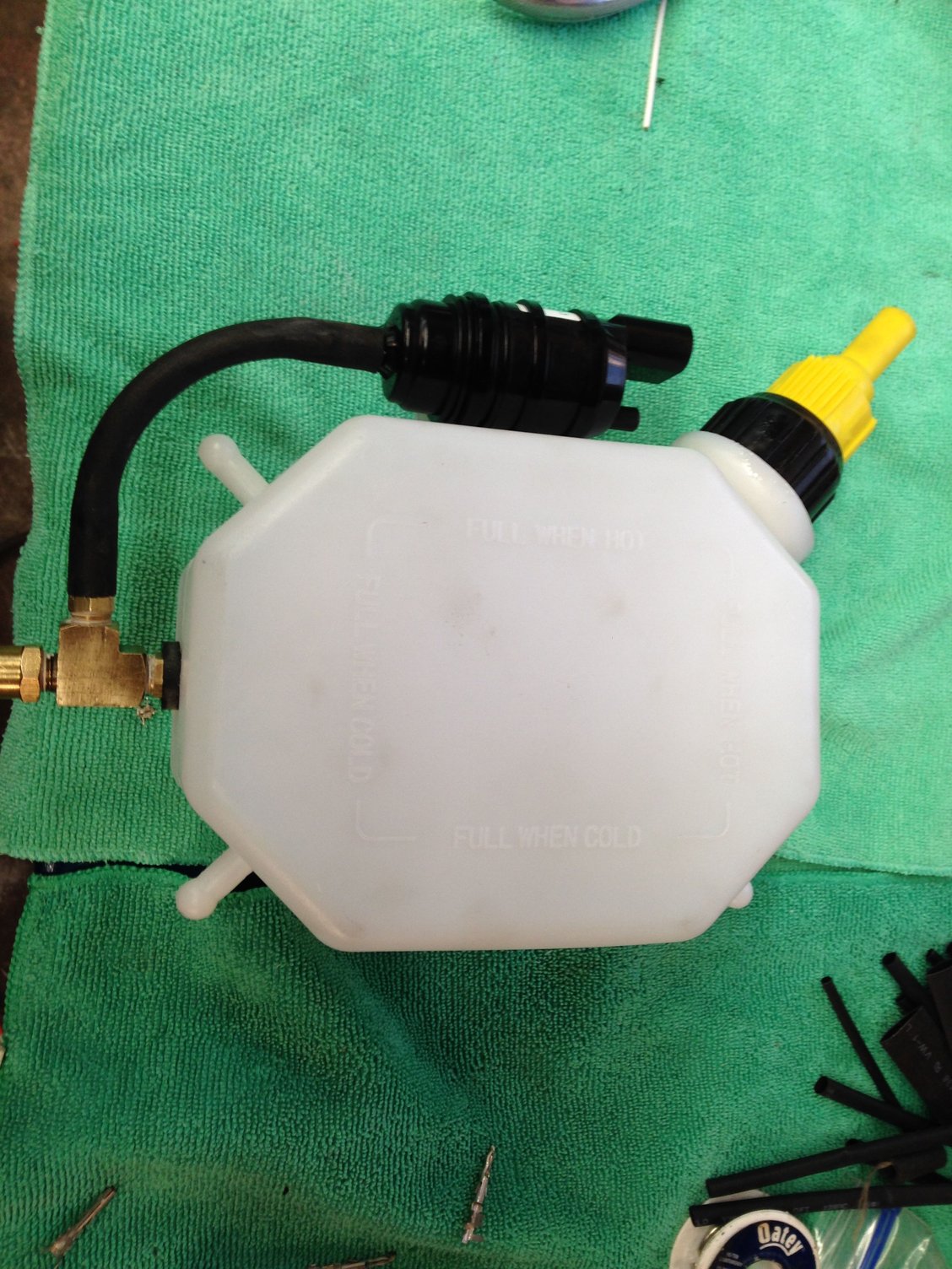

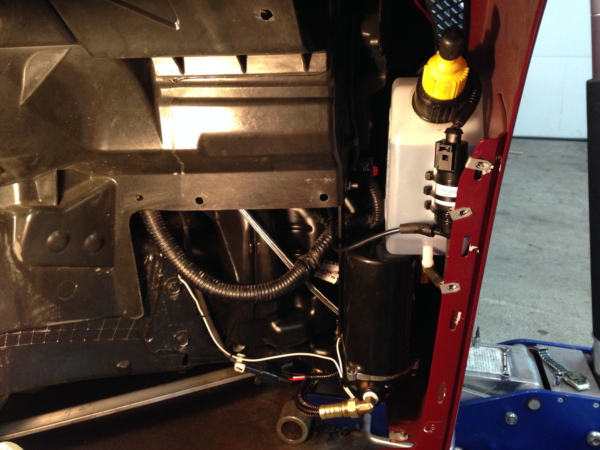

I went to O'reilly auto parts store and bought a overflow tank that fit perfect right above the Alky pump and it also came with a bracket to bolt it on with. I drilled a hole in the bottom of the tank and used a barb fitting with a rubber grommet for the pickup for the washer tank and pump. The only thing is if I haft to ever refill the washer fluid, I will haft to loosen the inner fender well to fill it, But its no big deal and very easy to do, and I don't use that much any way. Might haft to fill once a year. It works perfect. Here is the tank that I got

I understand on the serviceable part in the engine bay. My tank is to high up in the inner fender to run a pipe or tube to gravity filling the universal washer tank and not haft to modify or drill holes in the engine bay, and trying to fine a place to put the tank under the hood to remote fill. Its very compact under the C7 hoods ,not much room for any aftermarket parts, lol.... If you mount under the hood you will need to extend the wiring harness to the washer pump and reroute the tubing that goes to the wiper blades from the pump . Very nice tank you have there by the way.
