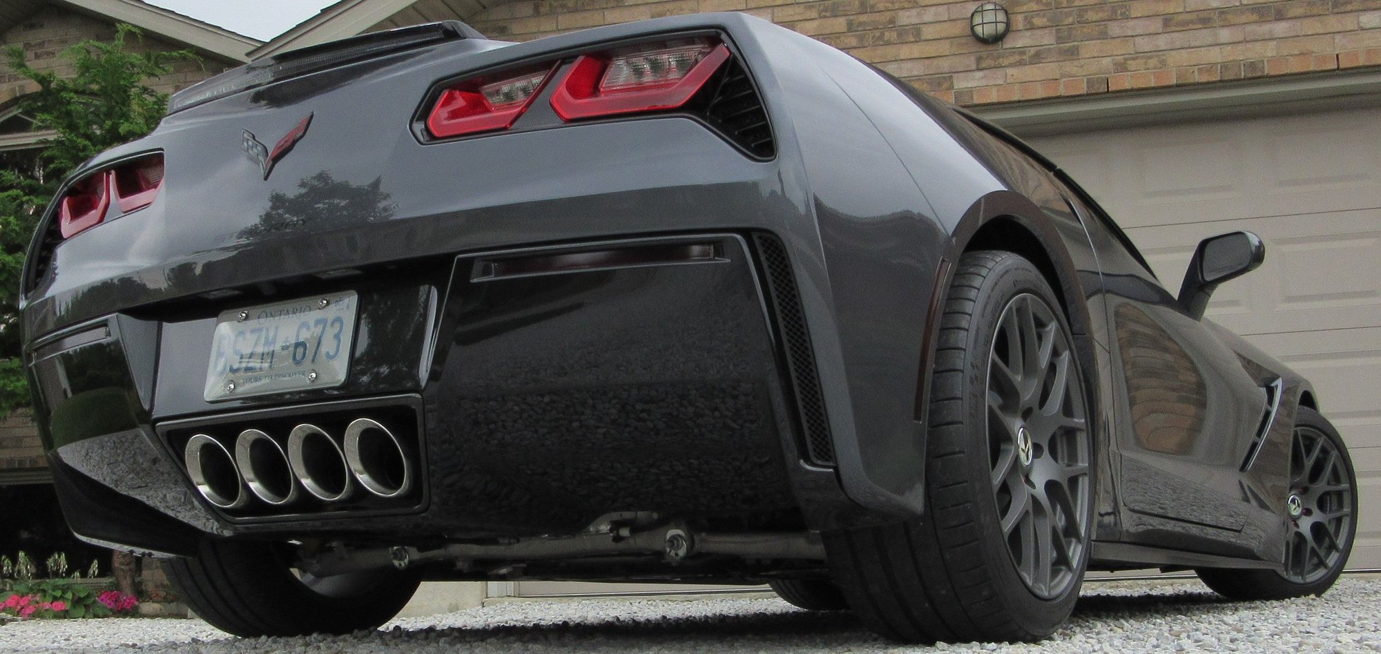

If you have a Non-NPP setup you can easily use the stock tips because they provide the one into two design. The NPP setup has two muffler outlets which go in to four individual tip gangs.
In short, Non NPP easy. NPP system difficult.
