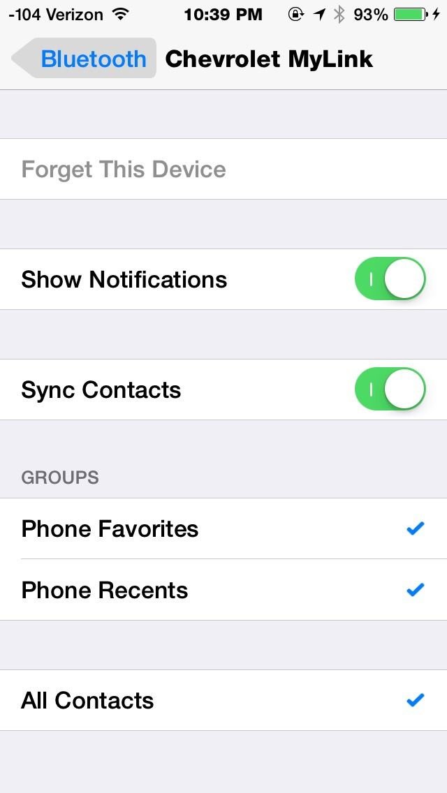

Can anyone tell me how to activate or turn on the SMS/Text on my 2015 Vette. My Iphone 6 is connected to the system but won't connect to SMS/Text

This has happened to a lot of people.....you need to check on something within the set-up on YOUR phone. go into the iphone and click on the bluetooth info icon. Then turn on the "notifications" switch. After that everything should work fine.

Here is a screenshot of the Show Notifications switch you need to flip. My 2015 C7 SMS/Text started working when I flipped it. It's off by default. No joy for the 2014 folks though.

The screen shot helped me a lot - thanks, I am not in the car but hopefully with turning on "notifications" it will work. Happy Holidays.
