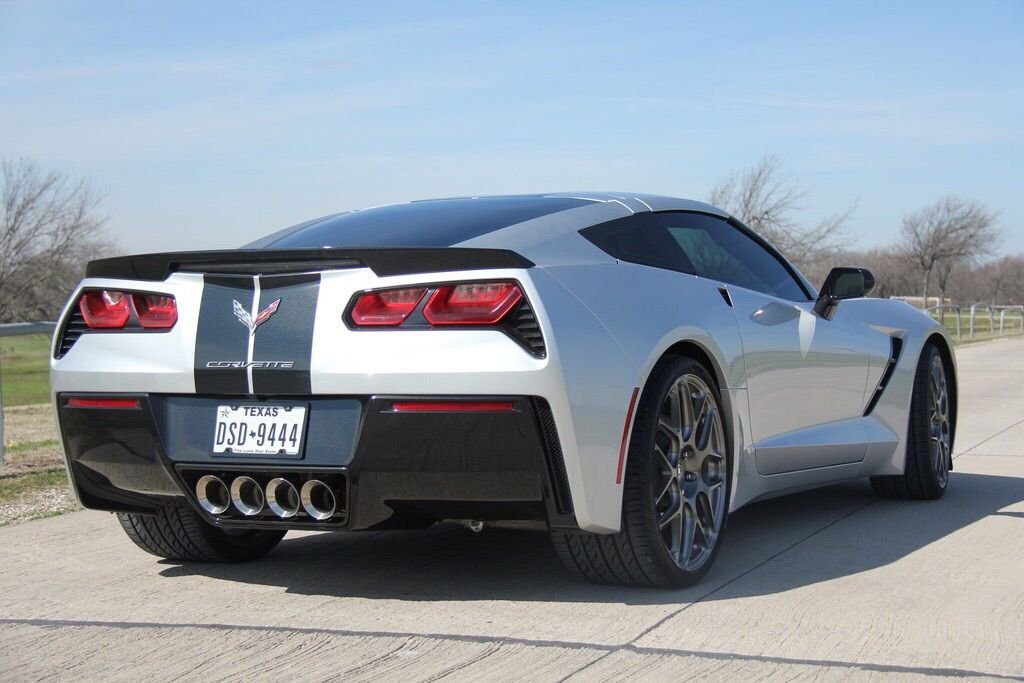

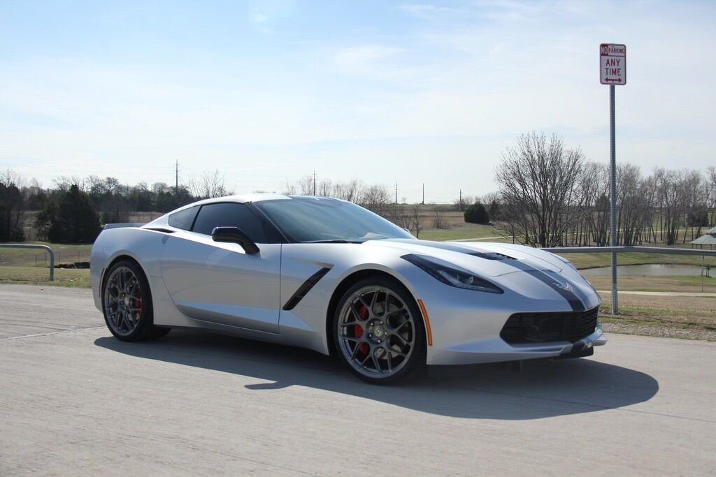

So you know...HRE has offsets where you can get a 12 inch wheel in the rear and a 375 tire. The offset is perfect and it does not stick out at all.
Not sure if this is in your budget but just wanted to give you some consideration. Btw, I'm supercharged too and the 375 in the rear still doesn't stick.

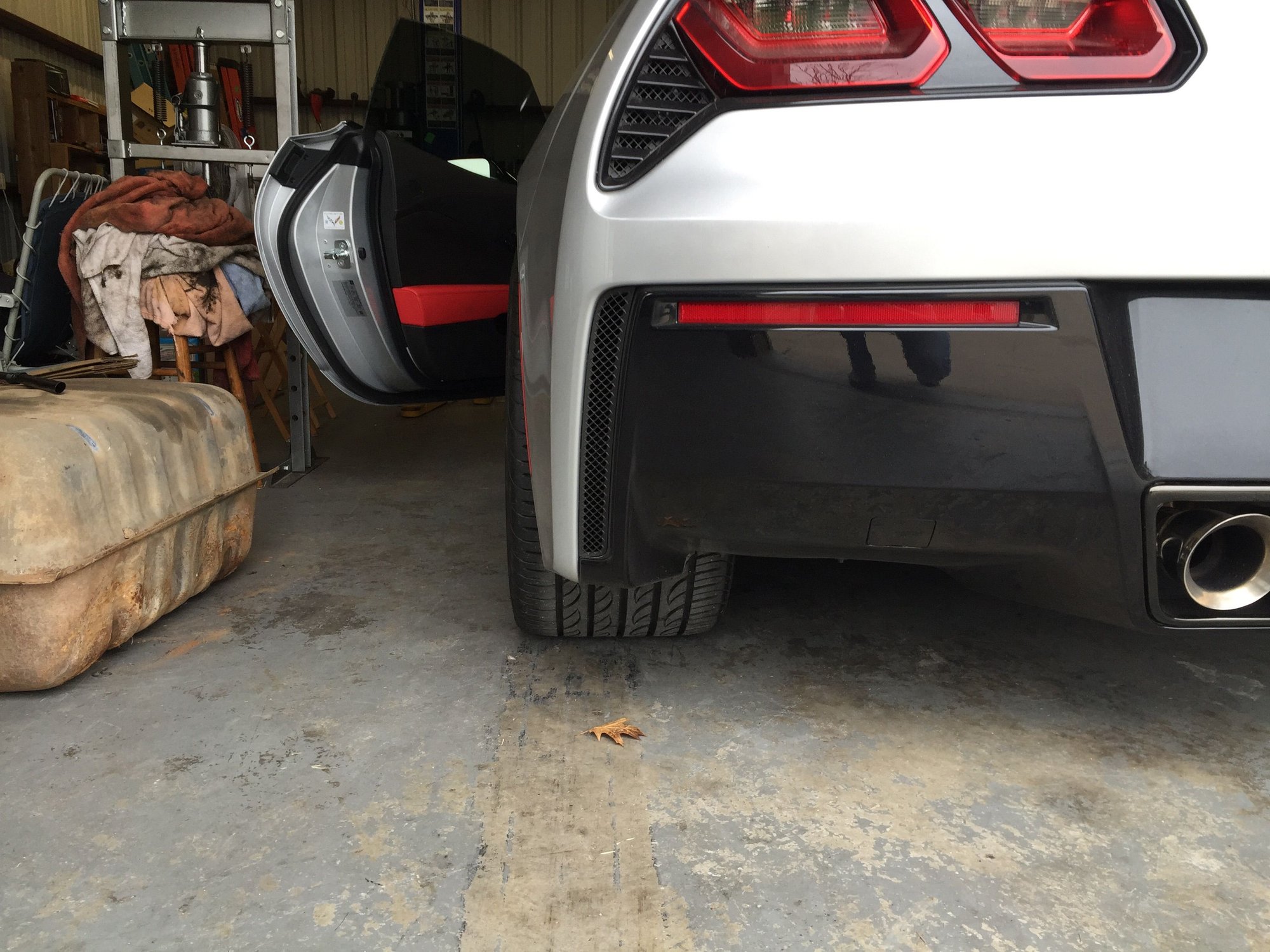

For the money, quality of fit and finish of the OEM parts, they can't be beat. I can do the rear kit for under $4200 and the whole thing under $5900. I have done a few of these already and can also take care of the exact wheel/tire needs for the setup.
I was going to do a wide body. To do it right, the rockers and rear bumper need replaced and if you're just making wider fender flares which will leave the wide wheels hanging out of the wheel wells on the front and rear of the car. They already taper in some now, I couldn't even imagine them hanging out anymore. The sides of the car would be torn up from the road rash and you'd have to run some truck looking mud flaps on both sides to try and block it.
Here's mine with the wide body on it
20x10 with Pirelli 295s
21x12.5 with Pirelli 375s
