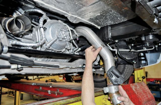

ok, some false info going on in here so let me try to clarify. I did a corsa xtreme and double helix x pipe myself in my garage on jack stands. You HAVE to take the lower valence off from the rear bumper. Its pretty straight forward but a pain at a couple of points in the process. Some axel backs come with their own over axel pipes and some do not. The corsa did not come with the over axel pipes so you HAVE TO CUT THE STOCK MUFFLERS OFF THE OVER AXEL PIPES AND REUSE THE STOCK OVER AXEL PIPES. Now, with Gregg00, you are going to need to get yourself new stock mufflers that have the over axel pipes attached, or weld the pipes to the mufflers to get it back to stock since you said you have corsa.
As far as adding the x pipe, its pretty easy, just a lot of bolts cause of the tunnel plate.

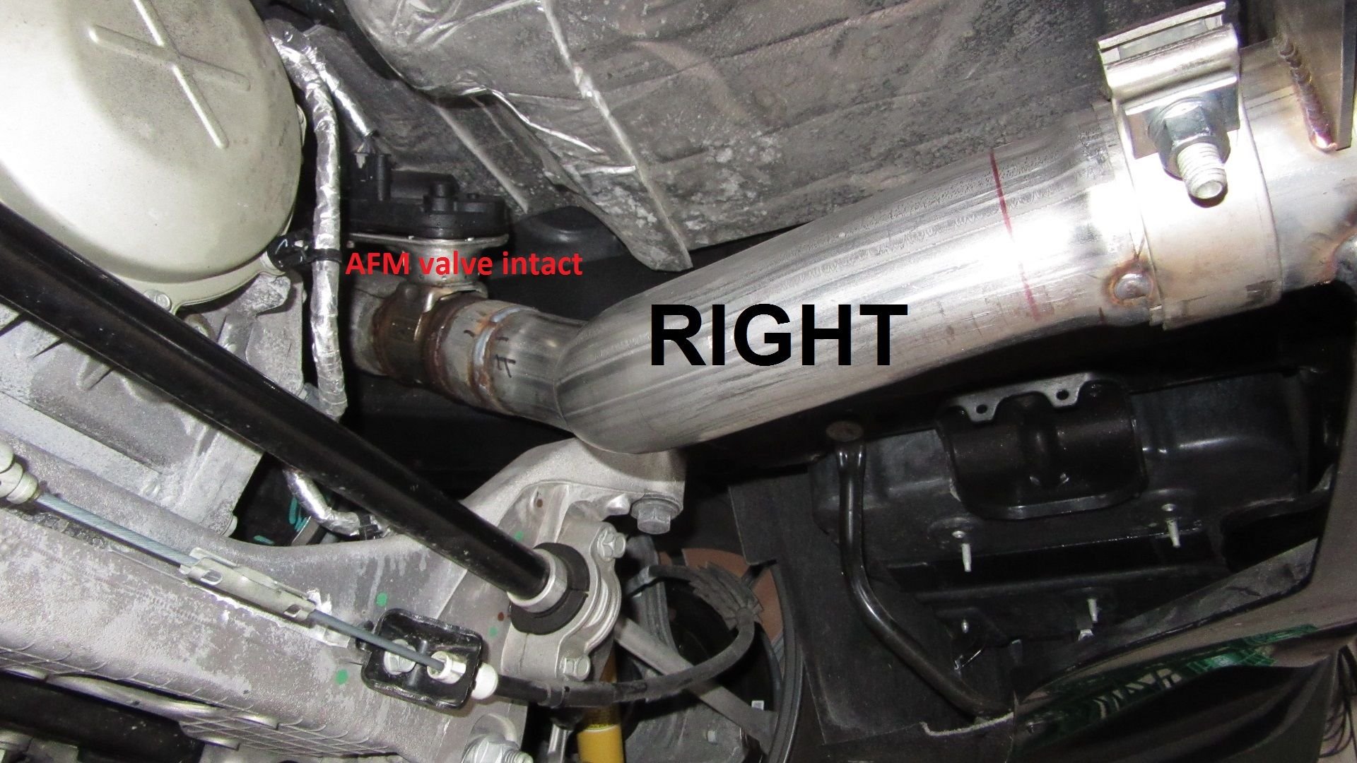

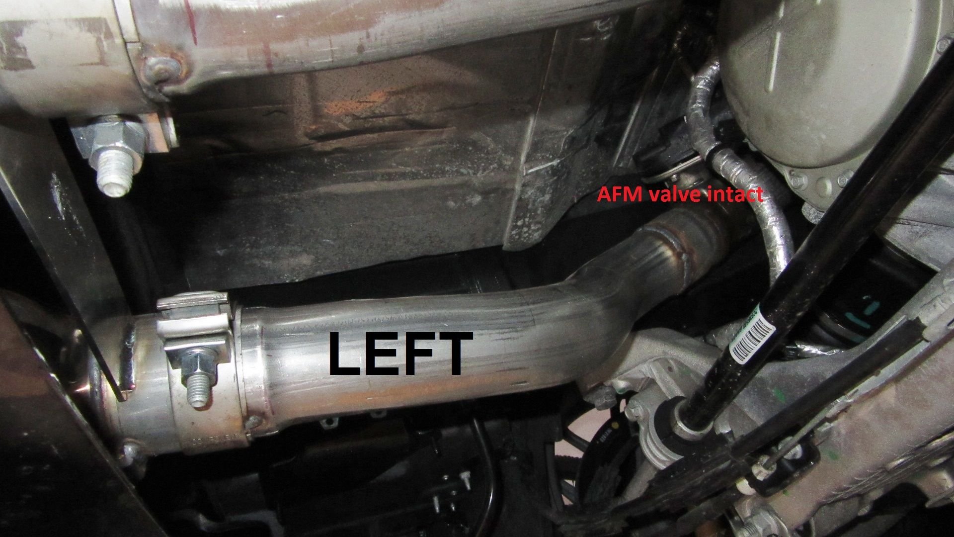

Corsa cut's between mufflers & AFM valves...AFM valves stay intact
My custom install didn't require rear fascia removal. Sawzall stock tips 1st, mufflers next.

Jake, are you just as much of a douchebag in person? When installing the XPipe with the Corsa exhaust you need to cut out the AFM valves of the stock pipe and reinstall them on the new system. I know, because I have had them on my car for almost a year now. Greg asked about the difficulty of adding an XPipe and I said it depends which system, that the Corsa system and XPipe you have to cut them and reuse them, and no one asked about being a hack and removing your mufflers hillbilly style.
http://www.superchevy.com/how-to/exh...-art-of-sound/ go to step 16.

Ya DON'T "cut out the AFM valves from the stock pipe".
Cut between AFM valves & stock mufflers.
Corsa mufflers get hillbilly "clamped" to stock pipes that retain AFM valves.

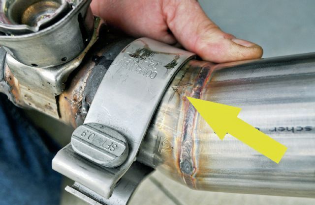

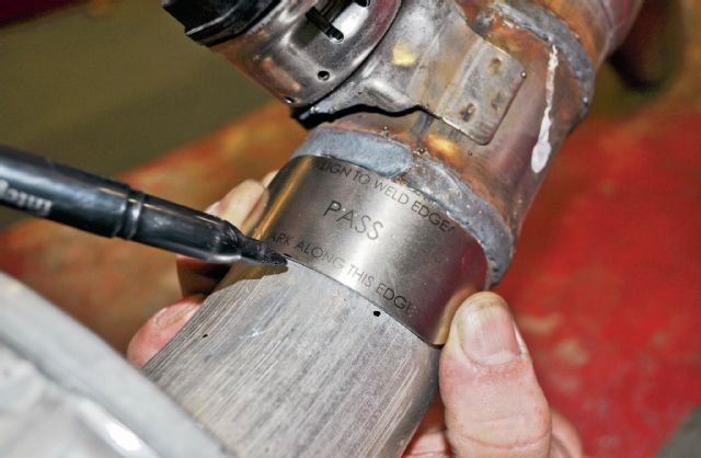

Cut out the AFM valves to reuse - You use the template to mark and CUT the section of the pipe with the AFM valves....
Next, the valve sections are joined to new axle pipes via clamps...
The pipes are slipped over the axle and connected to the X-pipe.<br/>
It's not too difficult to comprehend and I cannot make it any clearer. If you think I'm insinuating that you are supposed to just cut the valve right off of the pipe itself than that is your issue as I never said that anywhere in any of my posts.
