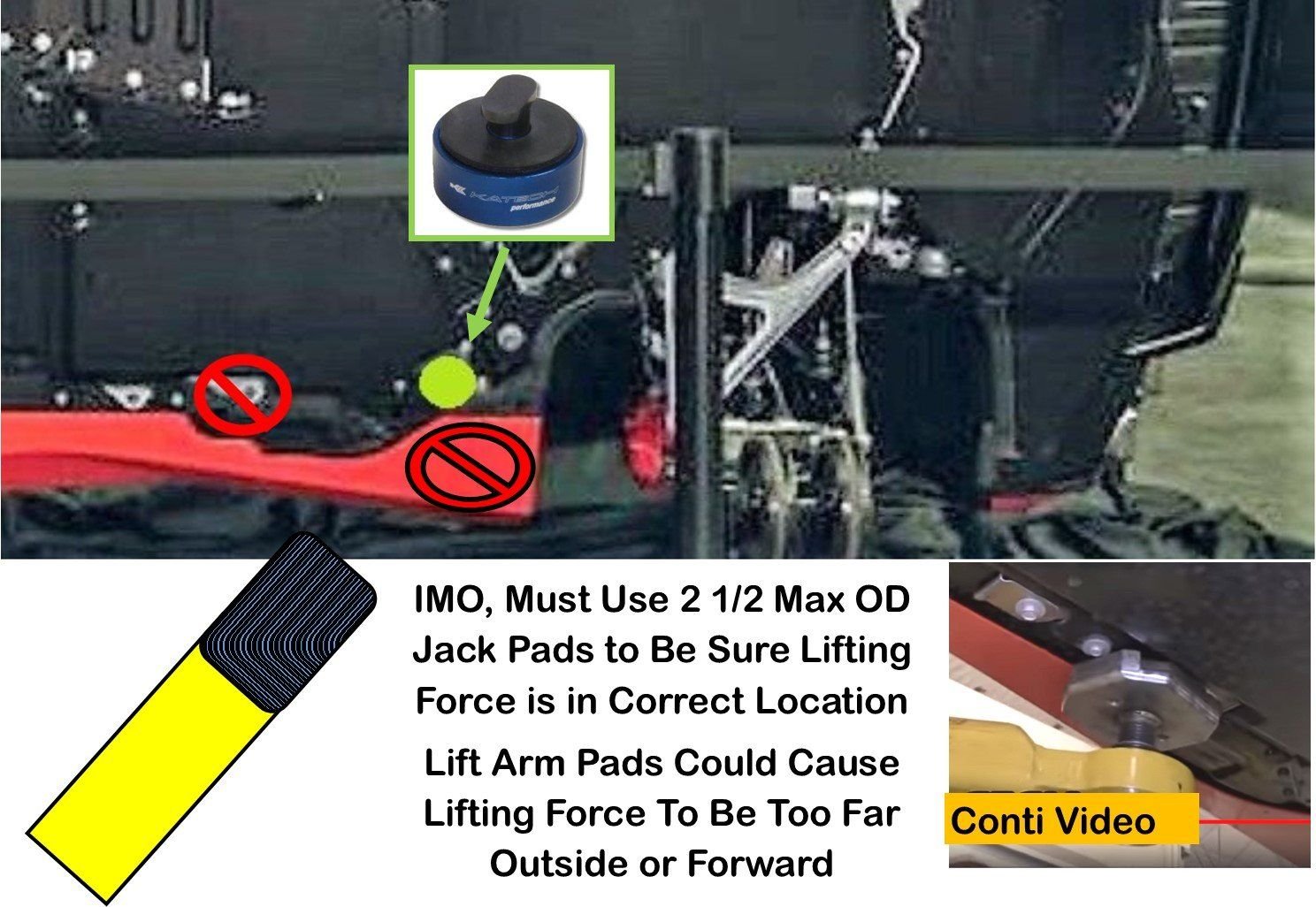

IMO the C8 is more of a risk than the C7's! IF they use a center post or a 4 post lift with arms, it's easy to place a lift arm pad outside the rear frame! It's not easy to locate the oval slot and techs have to bend down! Just jacked mine up and had to lay on my side and get a flashlight to install my jack pads!
IF when I install my ordered side skirts, there is enough clearance with permanent jack pads I may install.
