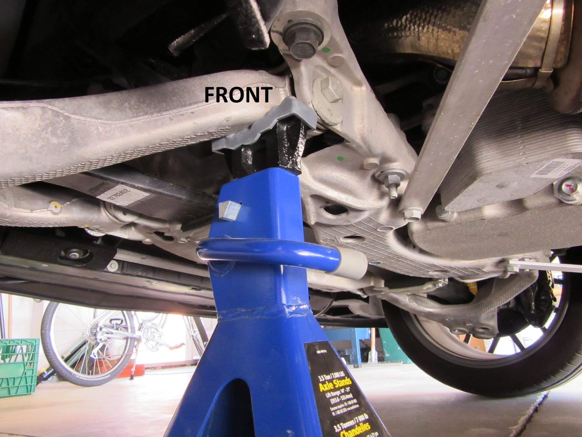

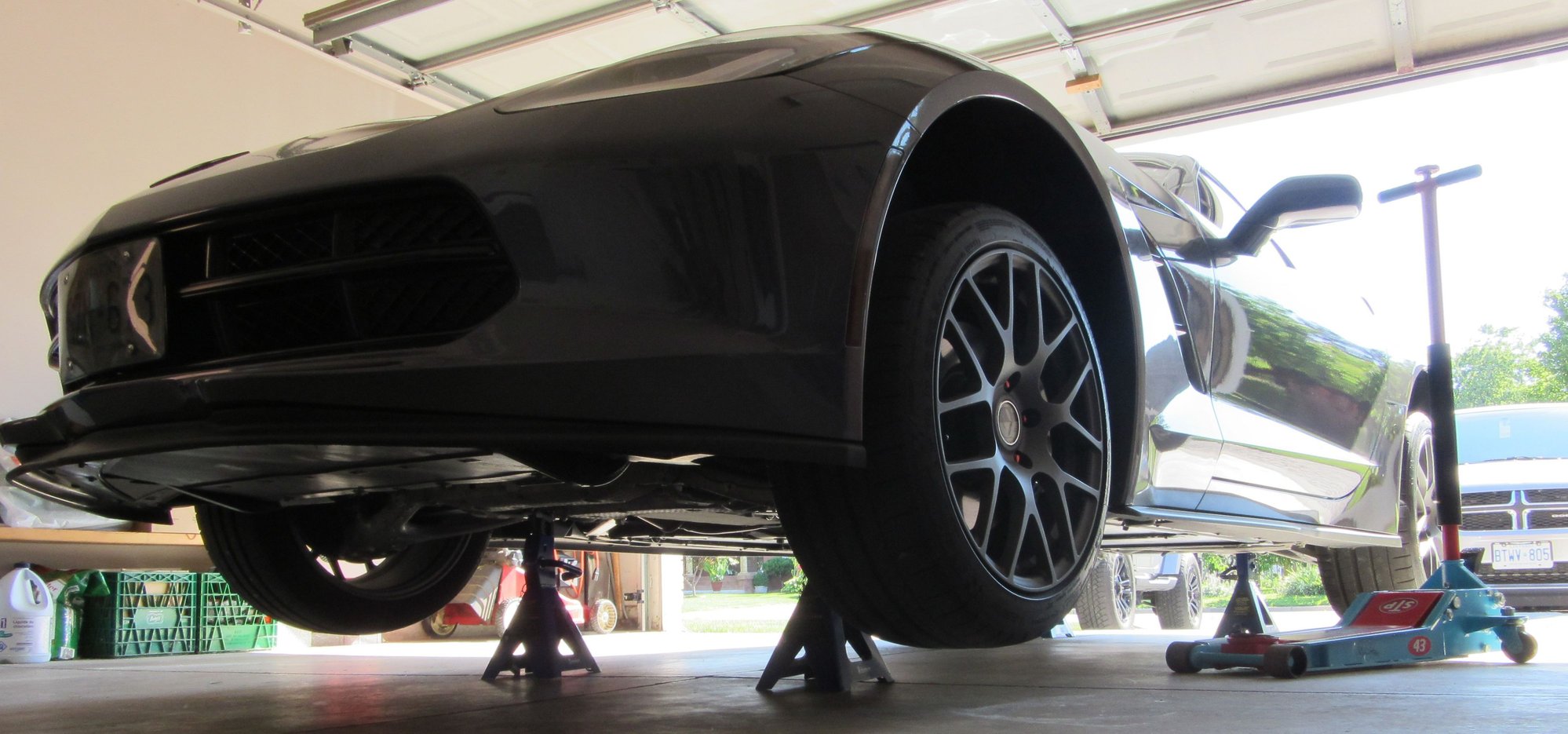

Originally Posted by C7Jake
permanent snap-in pucks
I recommend you move the jackstands inward a little more. Place them so they are under the cradle where the LCA is bolted to the cradle. You can see the bolt head right behind the jackstand as it is pictured.
Bill

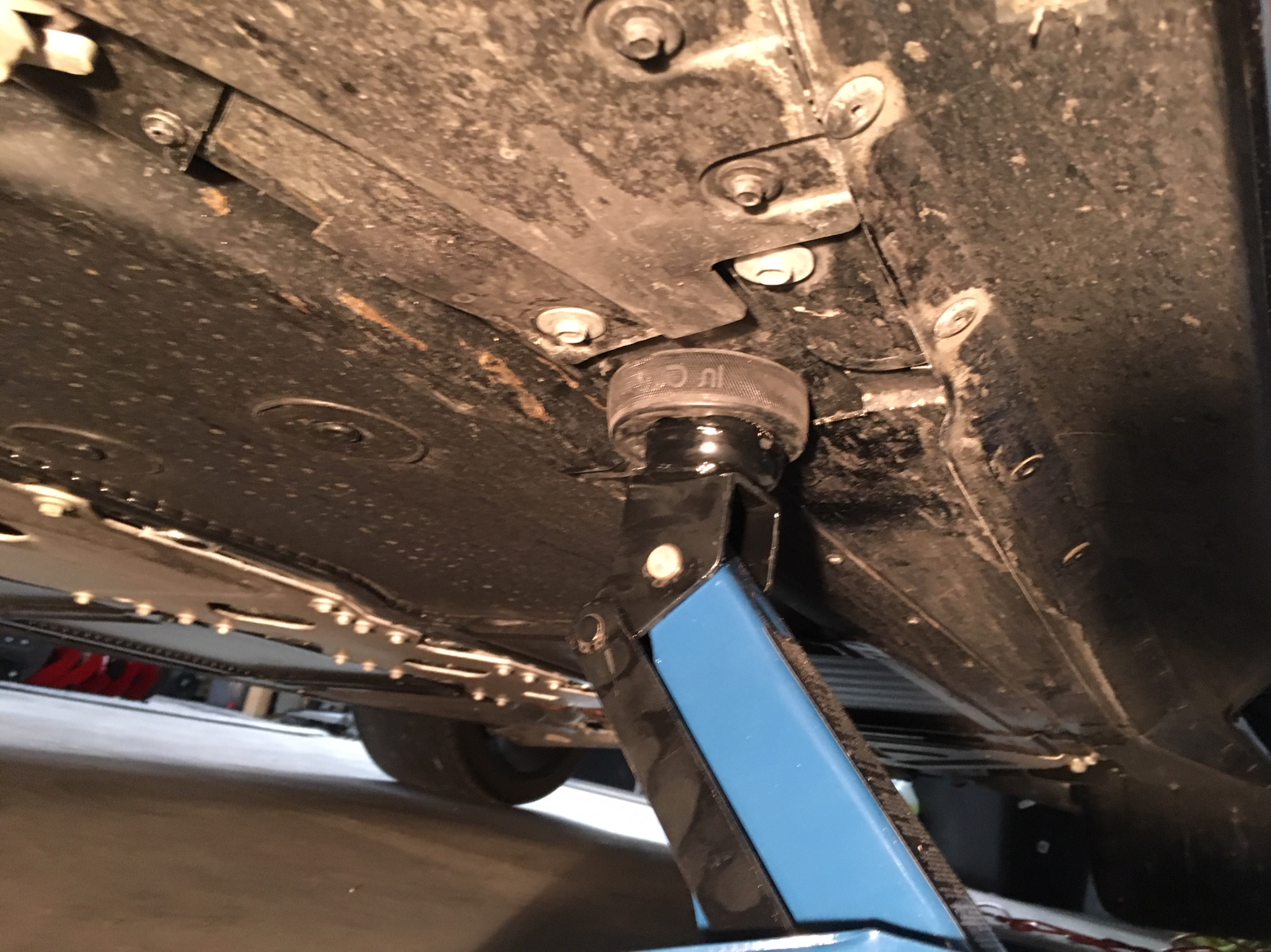

Default I tried this and it worked
I wanted to lower my Z06 and didn't want to wait for on line jacking pucks to show up so I used this idea. It worked perfect.

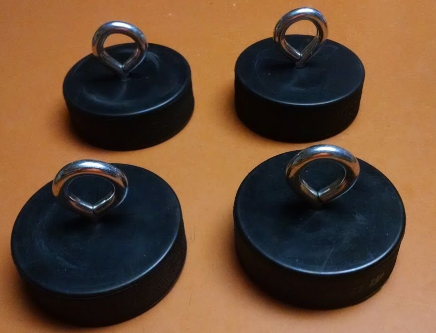

I've used hockey pucks with eye bolts for 15 years. First on my 2001 C5 and now on my C7. never had one slip or any issue with them at all.
Phil

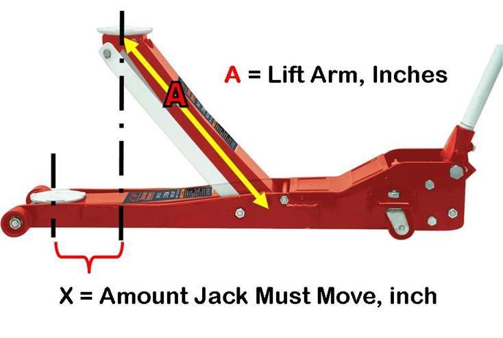

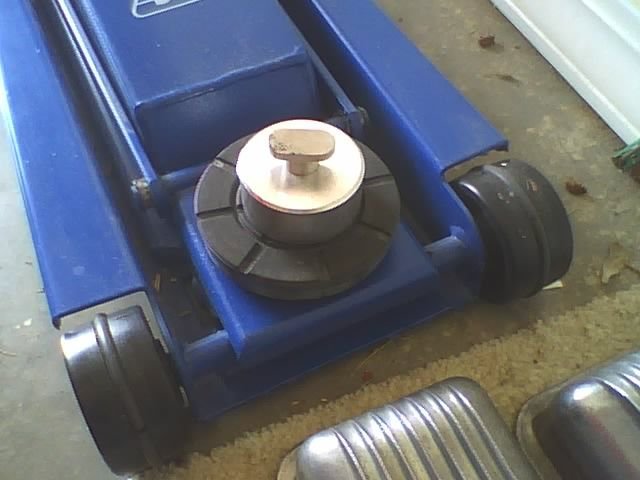

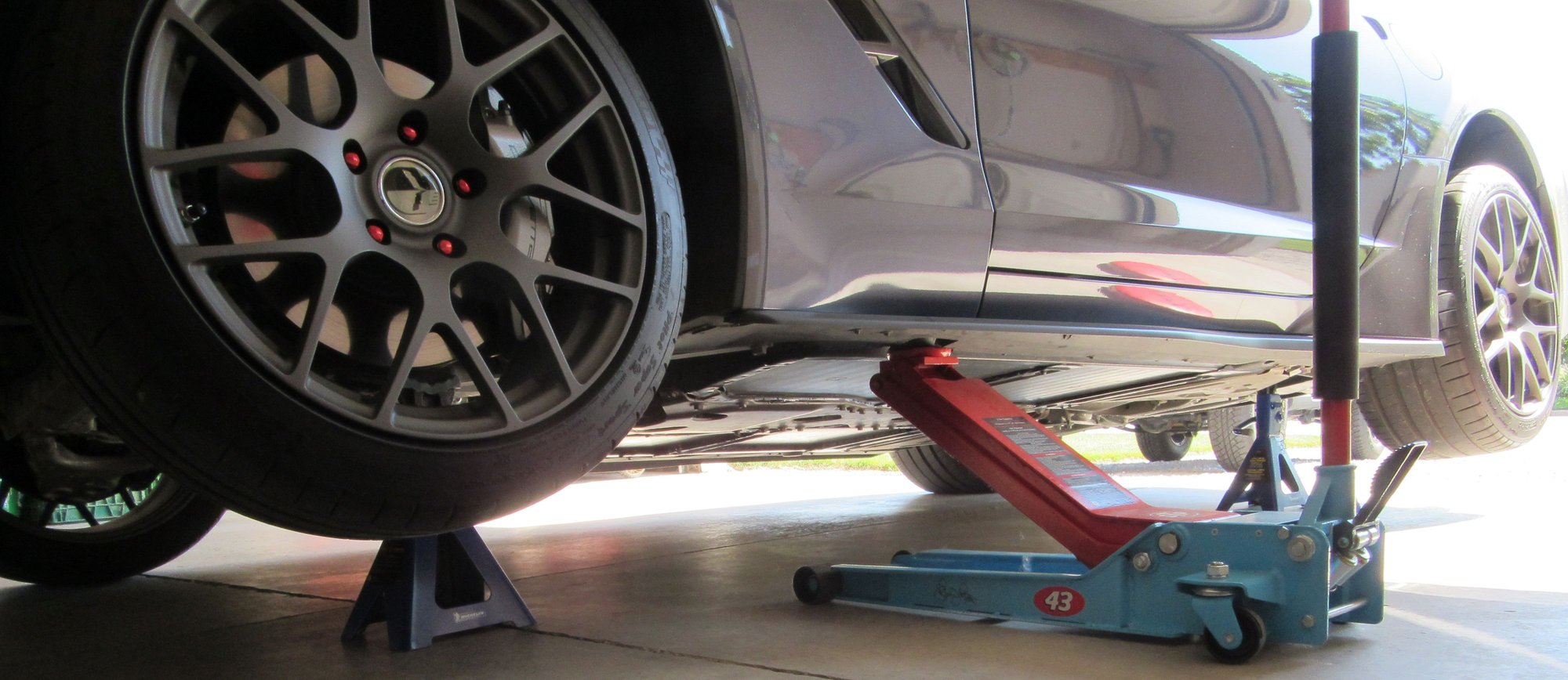

I had 3 inch diameter alumiminum jack pads for my C6 but found the GM Owner's Manual was right- needed 2 1/2 inch diameter for my C7. There were two frame slots that the 3 inch pad that were hitting the plastic rocker panel. With a smaller diameter eye hook in a hockey puck it probably can be pushed further from the panel versus and aluminum puck that is centered in the slot.
Also it is dependent on the length of the hydraulic jack arm as to how far the jack has to "move into" the car to keep it centered on the jack saddle as the car is raised. A short jack arm lifted near max-quite a bit (see pic.)
I bought a long reach jack from Harbor Freight so it would not have to move in as far. But it weighs 95 pounds! To get a low lift position it had a very shallow saddle! That heavy jack was not moving in at all! Solved that by welding a metal rim around the jack saddle (see pic.)
Bottom Line:
Whatever you are using be sure the Jack Pad/Hockey Puck is staying on the frame and jack saddle as you lift!
For equal lift height (max shown for short jack arm) a longer jack arm has to move in less to keep the jack saddle centered on the jack pad. Thinking I would solve the potential slipping problem (ask how I know about slipping!) I bought a long arm jack, it did not! The heavy jack was not moving in well even on my titled garage floor and would be difficult to have it move on my concrete driveway! Solved that by welding a rim on the shallow jack saddle making it deeper to hold my jack pad. Pic insert on left is after welding a rim to the jack saddle with a I inch high jack puck in place. Still plenty of room to fit under my side skirts and 1 inch high jack pad when installed on the frame.
