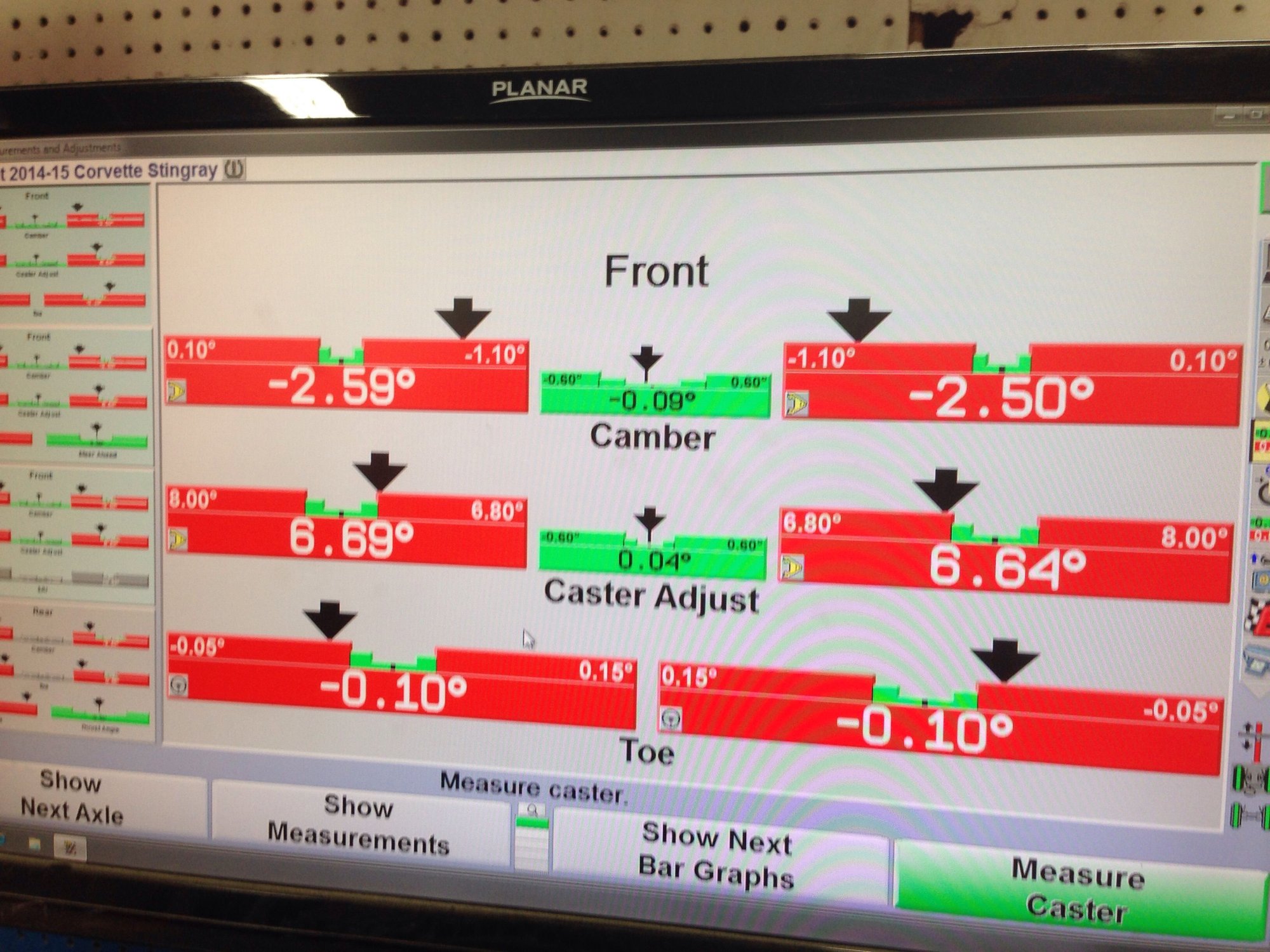

WOW!!! - Savage. That is a WHOLE LOT of toe-in. I am running the factory recommended 0.05-in at each corner and have zero oversteer issues. The car works for me beautifully with -1.3 camber at each corner.
One question to Savage or anyone; my car lowered fully on stock bolts, which means only 0.5" lower at each corner. Prior to installing the Z51 shocks I bottomed out at the rear at my local secondary roads when I hitting road dips at 70 MPH. Once I got the Z51 shocks no more bottoming at 70 when driving alone with less than full tank of gas. But, today with a full tank of gas and a wife sitting next to me I bottomed at 63MPH. Bottoming sounds like a "plastic" touching something, perhaps the tires go up against the rear linings? A quick look under told me nothing. The car has stock wheel offsets and plenty of camber to avoid the tires touching the fenders.
Anyone else bottoming and found the reason?

If it's a auto transmission my guess would be the small plastic deverter under the rear center of car to cool transmission, it looks like scrapper. Sence you liked the rear your going to love the front!
Thanks, Savage, I will check under. Yes, I have the A8.
The fronts looks fine for a track setup. I forget what kind of driving you do but, the cambers look good for the track or even for autocross. For track, and particularly autocross, I tended to go with a small toe-out up front for better turn-in on my race cars but, they were not Vettes and not street cars.
Your rear toe-in is HUGE. What are you gaining with that as opposed to the "normal" 0.05 toe-in? I would think it would blunt the turn-in and promote understeer...?
My driving of the C7 is all street, almost fully winding mountain roads. The -1.3 cambers with factory toe and caster settings work super well. The car is now a pleasure to drive, thanks to you posting the rear bar solution.
I hate that the widest rear tire I can fit is a 315/30/18 Hoosier a7 on my z51 car, I found I had way more oversteer with this tire compared to a 335/30/18 that I ran on a c5, long story short- tow in at the rear was the fix! The more I added the less oversteer I had, I stopped when oversteer was gone, I know I am scuffing some speed off in straight line but more than make up for it in the turns, I autocross mostly with small cars on tight courses and this works for me.
