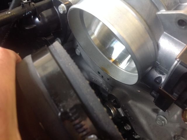

While I had mine apart to install a ported throttle body and intake manifold, I took these pictures of the oil in my Elite Engineering dual valve catch can at 1500 miles since last emptied (a little more than 2 ounces), and my throttle body. There was also a smear of oil around each of the intake ports where the manifold meets the head. The car has just shy of 6000 miles and I empty the catch can of about this same amount of oil at 1500 mile intervals.

Do you have the cleanside separator installed as well? The E2 is the 2nd to the best they offer, the latest is the E2-X just for GDI needs.
Also, are you using 2 checkvalves with the E2? Great pics!

Yes, I have the clean side separator and the two check valves.

Originally Posted by Higgs Boson
It's not an invitation to join the thread. Its a link to one post. Your post and pics with oil in the intake even though you have a catch can just reinforces my point.
Your point is that catch cans are not 100% effective. My point is that I would rather filter out a large amount of oil than have that extra amount go through my intake, across the valves and into the combustion chamber. I'll take some filtering over no filtering every time.
JV
JV
the problem is any oil on your valves is the same thing as a little bit, especially with a DI motor. pointless mod unless you eliminate the intake suction and thereby eliminate the entire source of the problem. if you think otherwise you are just lying to yourself.

Another picture of oil being drained from a catch can, and yet no pictures of the valves.
yes catch cans catch something. but that oil being put into the engine. We dont have enough data on the LT1 if its even that bad for the engine. Hell i really wont care if oil is chilling around in the engine or being burnt away if it doesnt hurt anything. or it takes a lot time and miles to cause damage.
on top of that. the pictures being posted are from a BMW n54/n55 which are known to have terrible build up.
JV
tell me cospeed2 what is wrong here it is still getting into the t.b. & intake and down onto the valves not good here at all.
