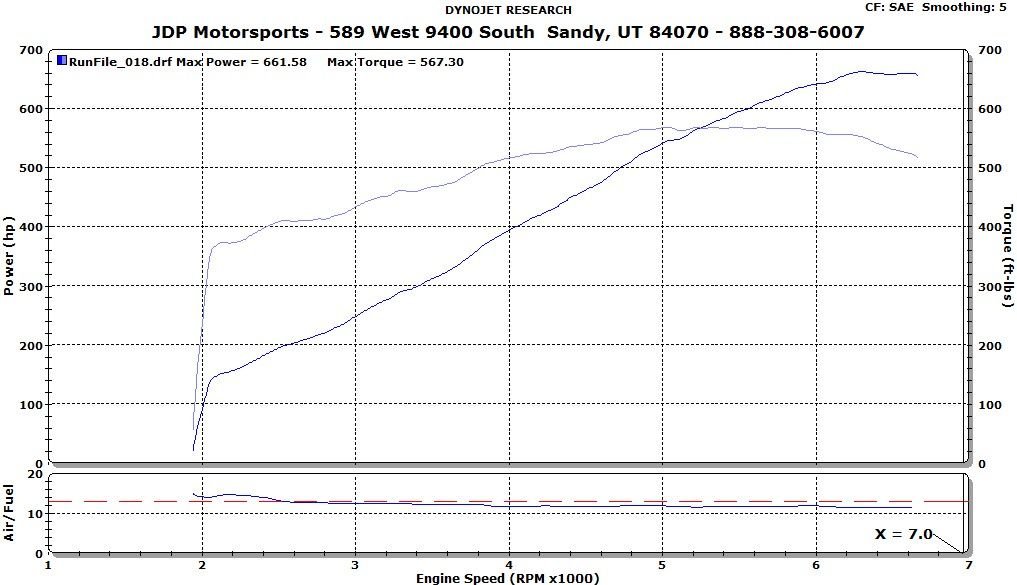

The A&A and ECS systems are the most popular set-up we offer. We always suggest the Alky Control kit with a good catch-can/breather system (FSP) on the LT1's when boosted.
The beauty of these systems is the car will drive like stock until you get after it and want the power. They are very reliable and low maintenance. The last ECS system we did made 662 WHP and 567 WTQ with ARH LT's, Alky kit and a breather/catch-can.

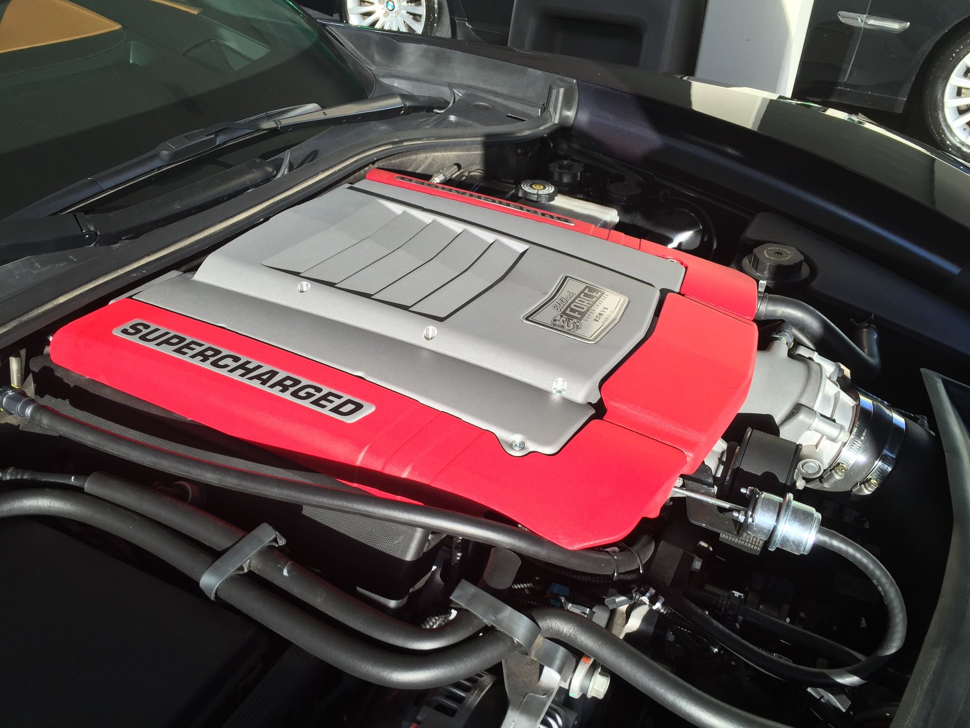

Don't forget the Edelbrock E-Force unit. Mine makes 560 RWHP without headers and the tune from Edelbrock. I do have a Borla non-catted X Pipe and it gets really loud. I am very happy with the performance. No overheating issues at all. Highway mileage remained the same. Fun factor went up. Drive train warranty backed by Edelbrock for a total of 3yr 36k miles was one of the reasons I chose the E-Force plus it looks great under the hood.
