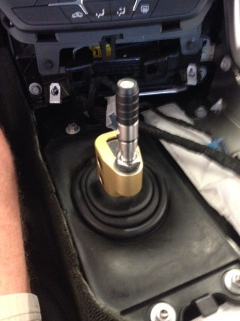

I finally received and installed an MGW short throw shifter this past week and I cannot tell you how great it is compared to the stock shifter. Very precise feel; especially up into 3rd and 5th - - best $260 upgrade out there in my opinion.
This is the first time I had ever done this so it took me about 2-1/2 hours. Now that I've done it once, probably could complete it in about half the time. Would highly recommend to anyone who is on the fence about a new shifter - don't hesitate - you will love it.
One caution for the taller guys, the MGW only fits in one direction and the shift lever sits about an inch to an inch and a half farther back in the box than stock. I'm 6'1" and it is still fine for me, but some might prefer it positioned slightly farther forward. If you look at the photos you can see how the lever is offset toward the back of the box.

About the position being too far back for tall people :
George at MGW has confirmed that you can safely reposition the shifter to the FRONT, instead of the back as in your picture, if that works better for you. He redesigned the shifter to insure it can operate in either the 6 o'clock or 12 o'clock positions without interfering with the C7's console.

I used the videos and photos from the forum (they were great) and a couple of other threads on YouTube/Google Search and everything went along very well. I could not figure out how to position the shifter in the 12 o'clock position, but if MGW says it can be done, I believe them.

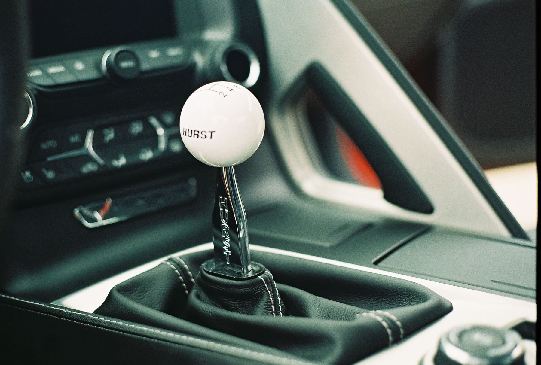

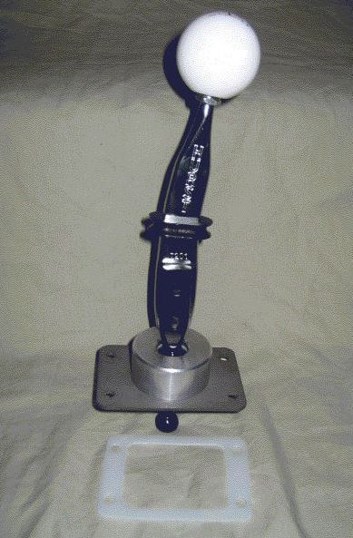

Modified Hurst shifter from Core Shifters is another option if you like retro styling, and has about same throw as MGW. You can also get a stick that will use stock ****...
