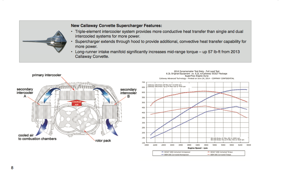

We use the Eaton TVS Rotorpack as the basis for our patented GenThree Supercharger System, which is packed full of features like nobody else has or can deliver.
Here are some details of the new supercharger we developed for the Stingray, GM Trucks, and new Z06 Corvette.
info@callawaycars.com
