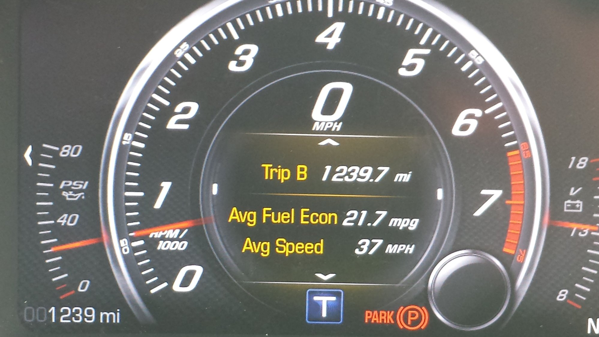

Exactly what is stuck in Sport mode? The round speedometer / tach display (Sport mode shown) or the letter at the bottom center?(T shown is Touring, can also be Sport, Tr for Track, Eco, or Weather). The letters at the bottom show driving mode selected by the rotary **** on the console. The dash display format can be fixed or linked to driving mode using the steering wheel controls. The HUD display mode (2LT and 3LT) is set from the HUD controls.

Hi Ron,
The driving mode and the display are stuck in Sport mode. The display and the driving mode do not change when I rotate the Mode Selector **** left or right. My Stingray has the performance exhaust so I can tell the difference audibly when the driving mode changes from Touring to Sport since the second pair of exhaust pipes open in Sport mode.

So the letter below the tach will not change from S? Sometimes you need to hold the mode selector in the left or right position for a second or two. It is touchy. I'm guessing there may be a bad switch, connector, or cable if the S won't change. You have a warranty.
