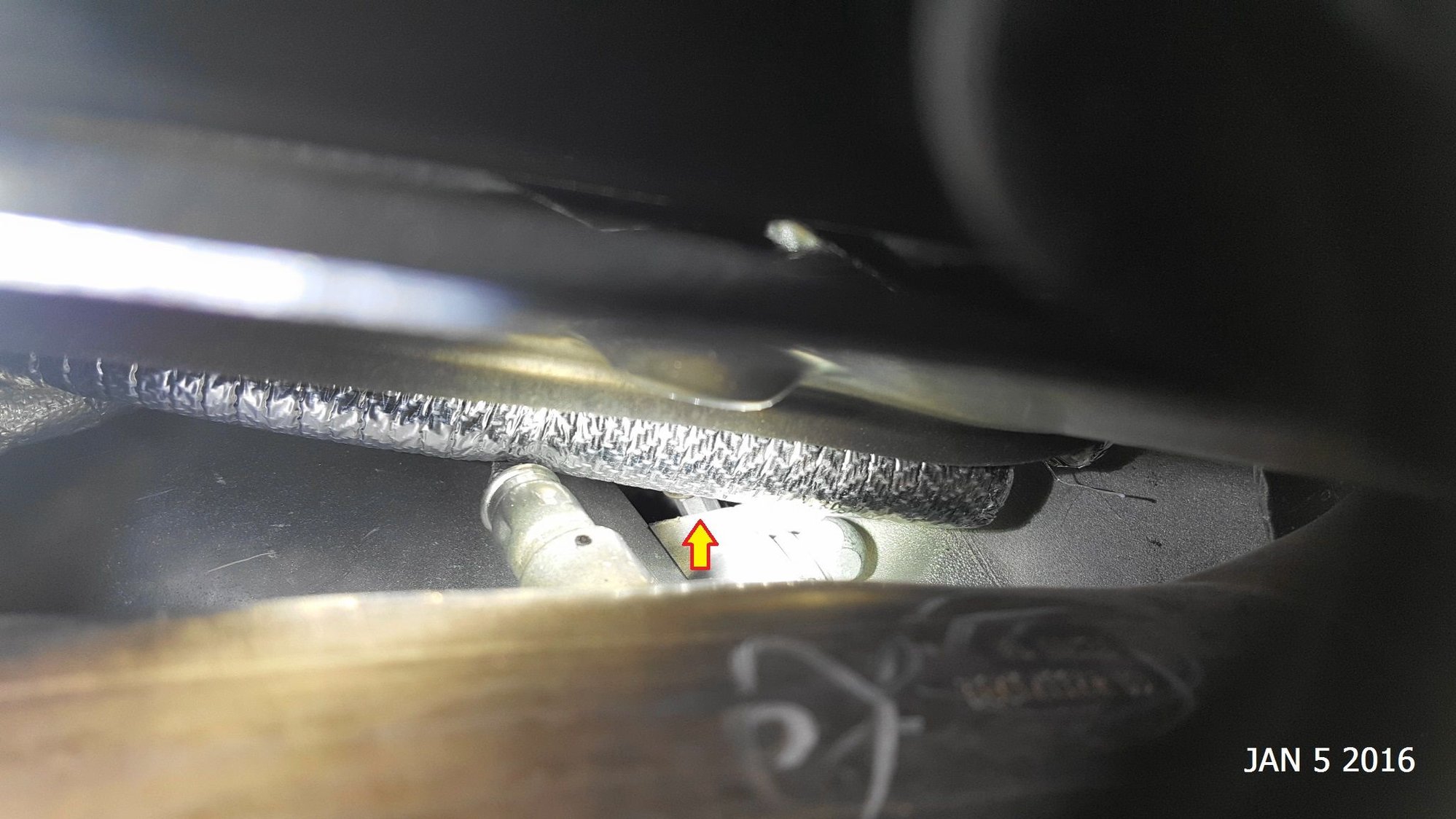

I was about to start to tear things down for the Helixx, and Xtreme Corsa exhaust system, but I noticed the clutch bleeder is up there away, and inapproachable.
I looked and the only way to properly bleed the clutch fluid is by removing the main left catalyst. If I have to remove everything behind the main cats for the exhaust installation I rather do this "mod" as well.
I did a search, and located threads about members asking similar questions. I have a new C5Z06 remote bleeder I never got to install, and I wonder if anyone knows if it would fit on the C7's hydraulic slave cylinder OR if anyone out there sells a remote bleeder for the C7Z07.
This is the best picture I could take.
