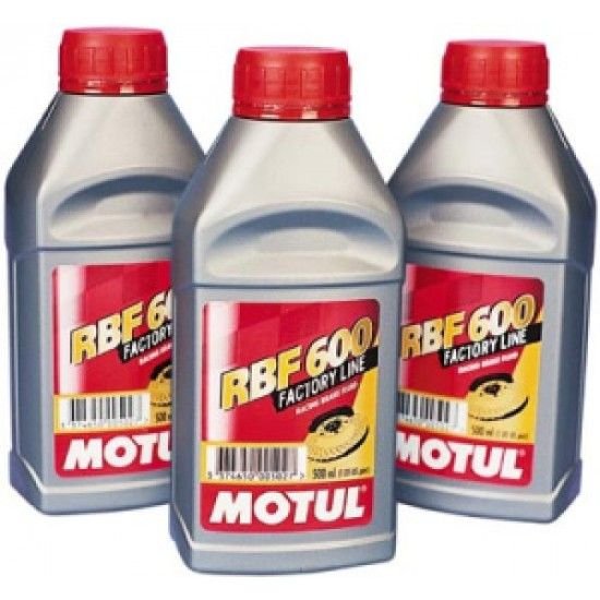

Motul 600 Dot 5 fluid....

I would not use Silicone-based (DOT 5) brake fluid in a car that's going to be used on the street. DOT 5 fluid, if left in the system for very long, can allow water to pool at the low spots in the system, which just happens to be behind the caliper pistons, which is where the fluid gets hottest. Water + heat = loss of brakes when you need them most. If you're going to use DOT 5, bleed the brakes frequently.
DOT 5 is not compatible with DOT 3 and 4, so if you're going to swap back and forth you need to make sure you thoroughly bleed the brakes at each swap. Not worth it.
There are high temp DOT 3 and 4 compatible fluids that are a better choice for a street car.

Any downsides to using the Motul DOT5.1 compared to the Motul RBF600? I'm not planning on tracking my car yet, but do plan on a fair amount of spirited driving. This includes a week long trip to the Tail of the Dragon in May. The car is also my daily driver all year long, including the winter.
Going to do a full brake fluid flush in preparing for my trip and I'm trying to figure out which brake fluid would be best for my use.
