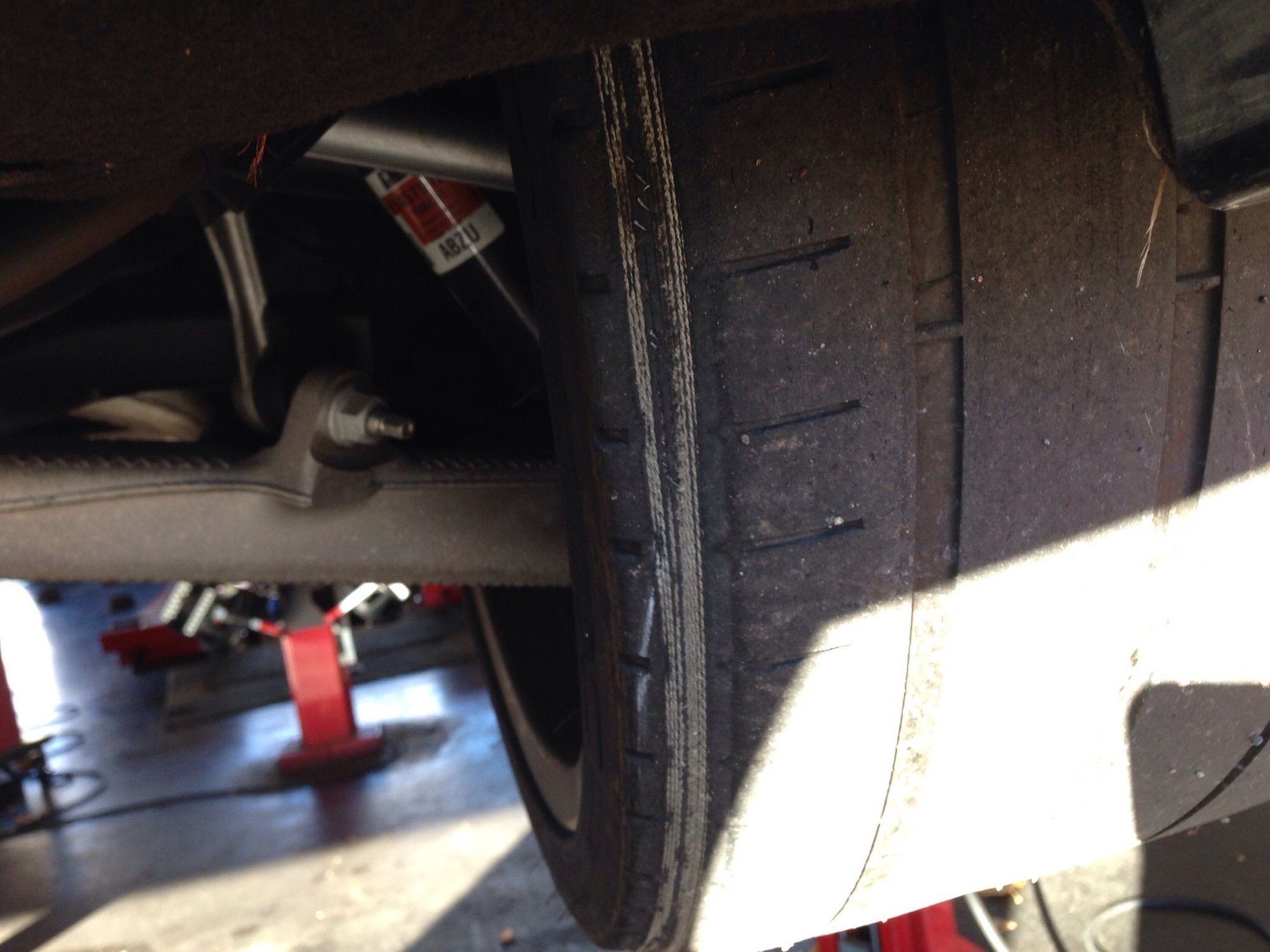

After my one track day the outer edges of my front tires were worn MUCH more than the inside. This after my local dealer did the Track Alignment.
I was suspicious so I had an independent shop do a check. I've attached copies of the 'actual' check alignment comparison with 'regular' spec, Track spec and actual. Documentation for each also included. It would seem that the outside tire wear is explained by the actual readings.
Old Mar 5, 2016 | 01:34 PM
Good thing you checked. Of course, on the right track it's pretty easy to get outside wear even with -2.5 camber.
Maybe I'm reading things wrong, but your camber is set to close to zero where track spec calls for -2.0 front and -1.8 back

Exactly. That's the point. Apparently the dealer charged for changing the alignment from street to track, but didn't do it. The independent garage after-track alignment check found that the alignment was almost exactly that of the street specs. This helps to explain the outside front tire wear?
