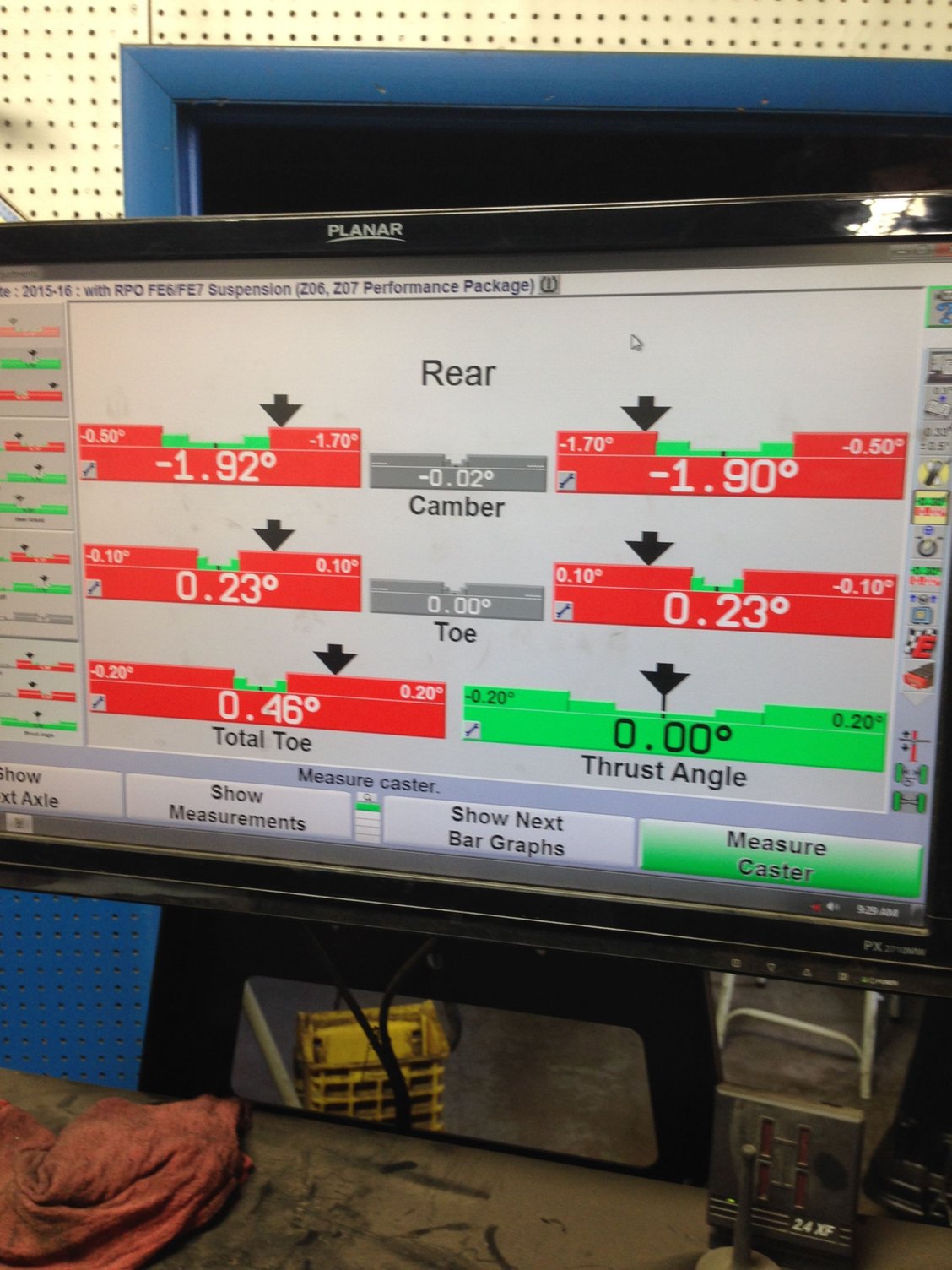

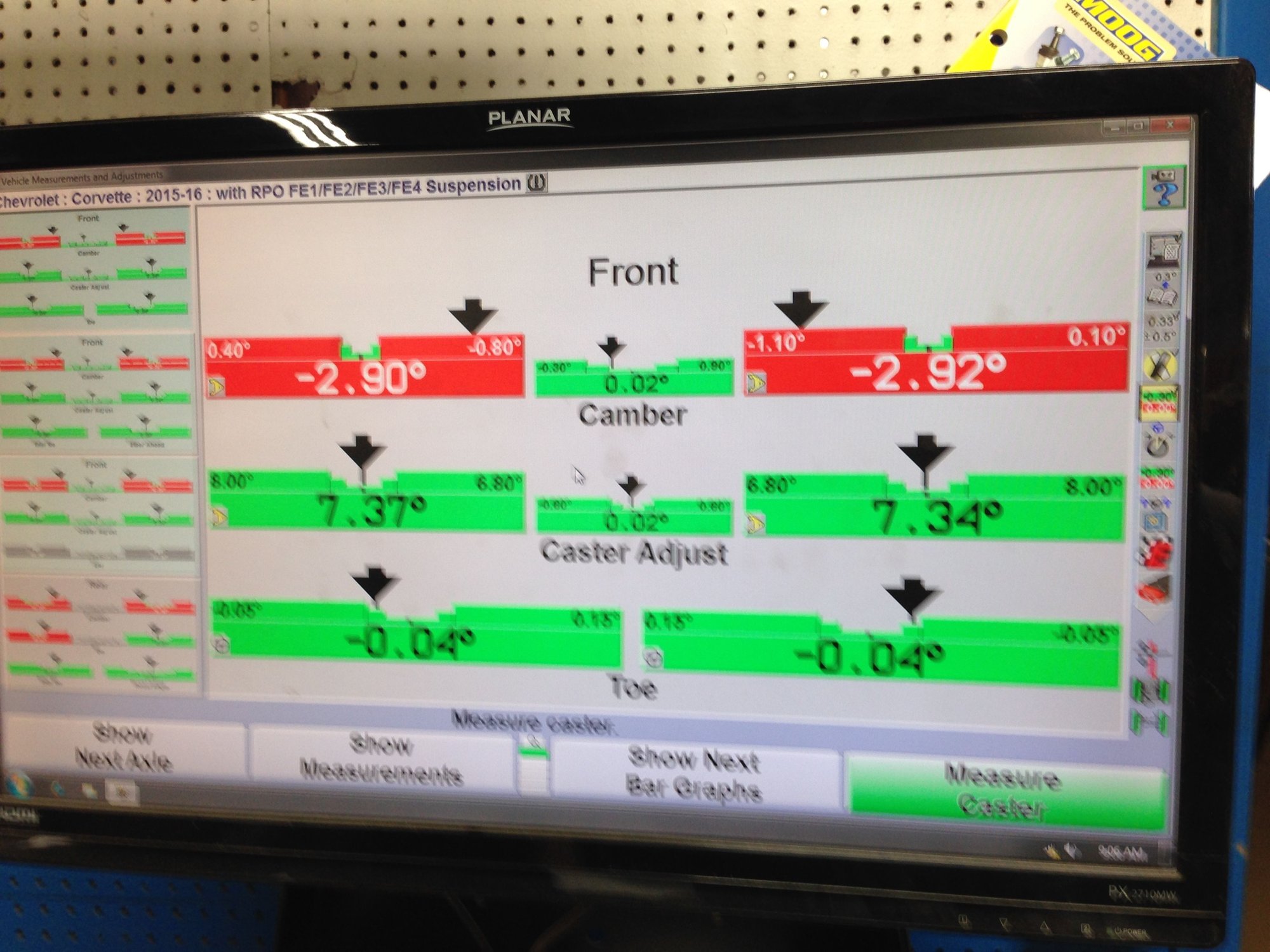

2016 mag-ride z51, took all from front and half from rear, going with less neg camber this year in
rear looking for better launch, and much lees toe in out back because I think when I went crazy with it I lost oversteer but found a push(understeer)

hello bill, thanks for all your input in all threads you post in . I found out something yesterday I'm sure you already knew- my base14, z51 non mag 15 and my mag- ride z51 2016 all had two washers behind every A-arm bolt front and rear but yesterday when Removing all the shims from my new ( leftover) 2016 z06 their was only one washer per bolt in the rear ??i did not know that ! Anyway I just hit 500 miles on car and I need a auto cross alignment for next weekend so I started with the shims !!

It's just so much easier and free to just remove the washers( shims) in the rear . I'm not even at the limit neg camber and tons of toe in but stopped right there when I got 1.2 positive caster in the rear - no oversteer for me now !!
