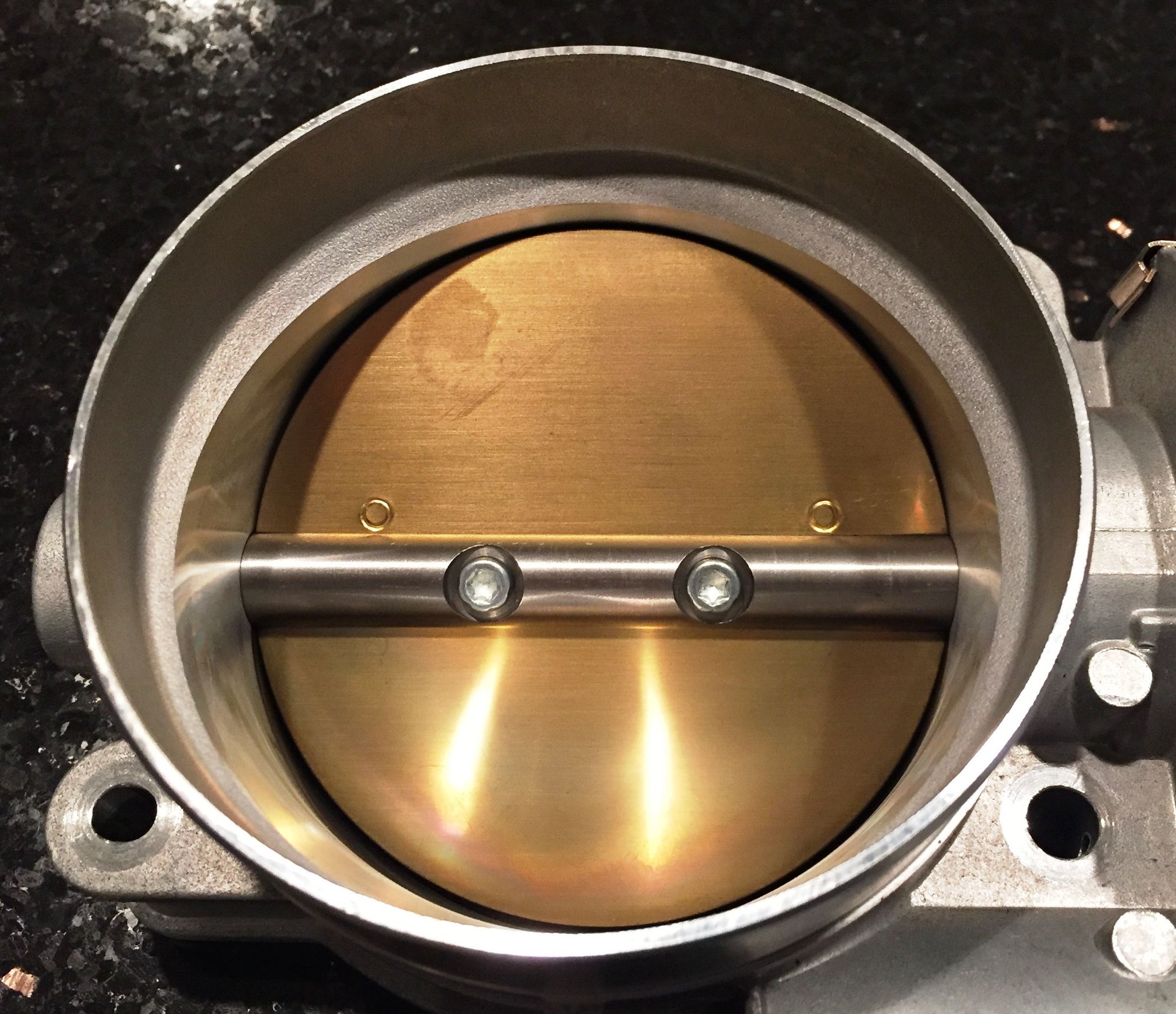

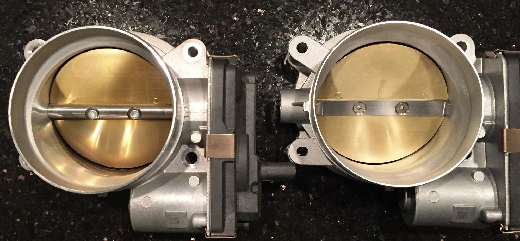

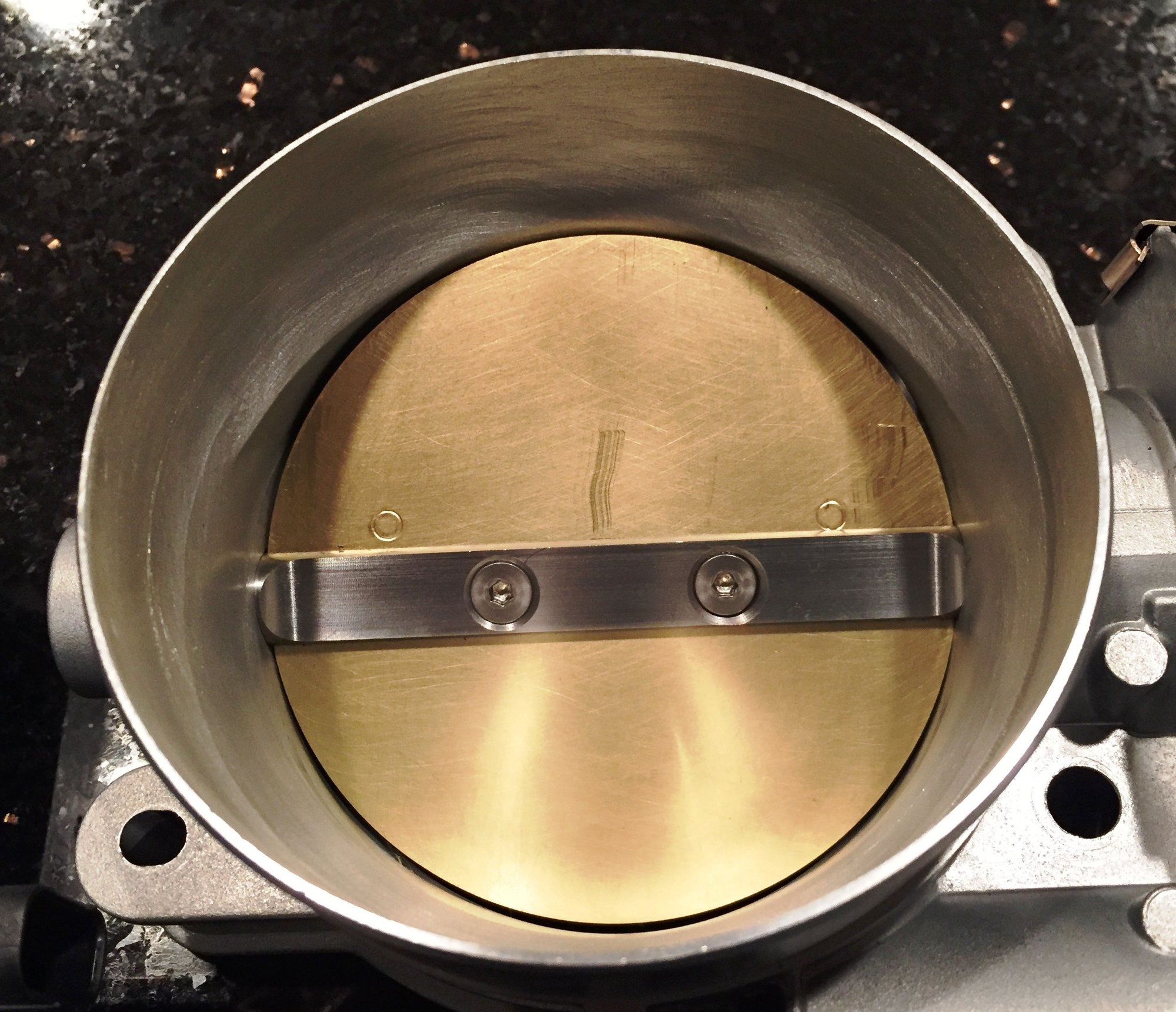

I want to give a quick report on my final positive outcome with the Katech ported TB. Jason Harding has been great to work with and exemplifies customer service.
Last fall I purchased the ported TB. Pricing is great, and Katech is local. I know from my own dyno testing with other ported TBs that horsepower gains would be little, if any, for my CAI only application. However, I figured I'd give the Katech a try as it's the only one that mills down the butterfly shaft...and it's the least expensive option I found and no core charge.
I tried two samples last fall, and I experienced the low-speed, part throttle drivability issues with my A8 as reported by RussM05. I will say the WOT and throttle response were fantastic, and with an M7 I'm sure it wouldn't have been as much of an issue. For my automatic, part throttle and low speed shifting was just too jerky, and it was in a box since last fall. I was too lazy to take Jason up on his refund offer at the time.
RussM05 explains the reasons for this behavior here, but more importantly that there was a new porting profile to address this:
https://www.corvetteforum.com/forums...post1592298998
I finally got around to exchanging it for the revised version last week (again without question by Jason). I'm very happy to report that the low speed drivability and light throttle shifting are just like OEM. The throttle response is just as great as I remember in the original version. I'm a VERY happy camper now!
Thanks to Jason for his great service on an extremely small-potatoes transaction in the scheme of Katech's operations. Problems happen, especially in the aftermarket, and they tend to get aired here quickly. The CF vendors who do step up to resolve them don't always get visibility on that part.
Some pics:

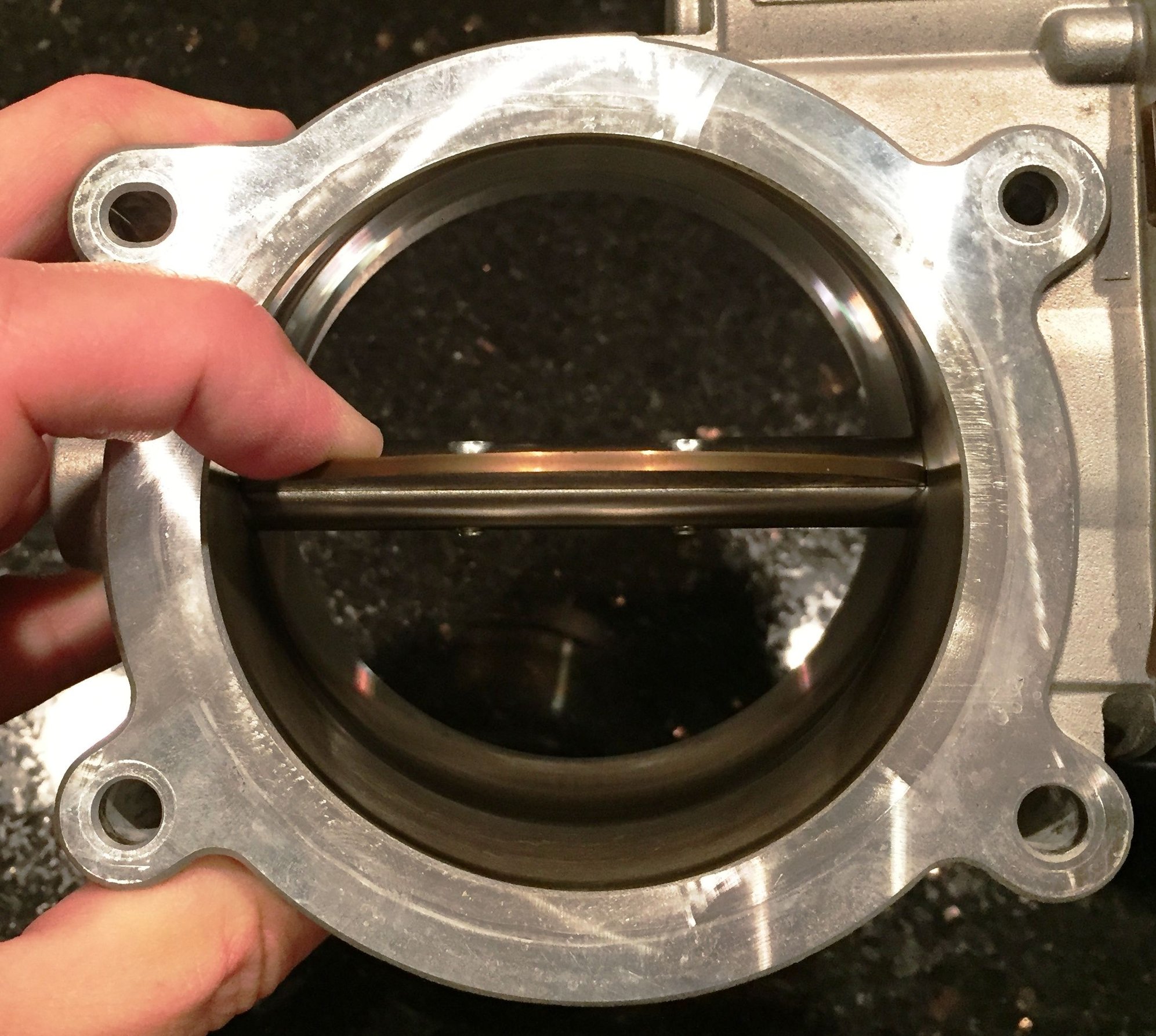

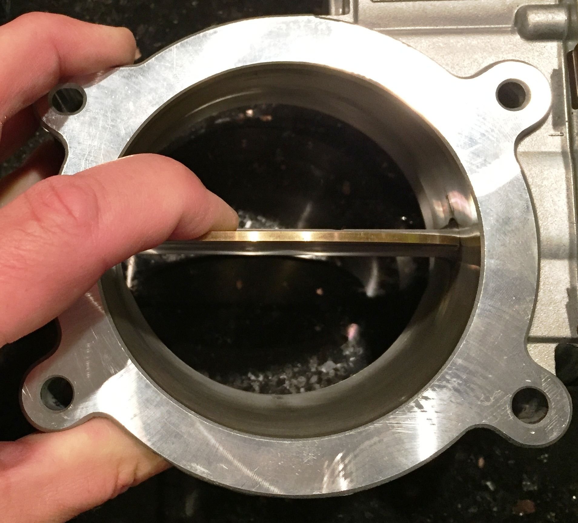

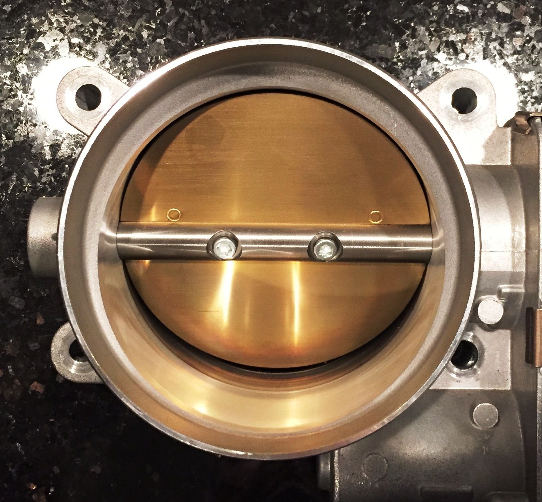

Take a look at the second picture in the link in my OP. You can see how much more material the V1 had removed around the blade in the closed position. To my eye, the V2 mostly retains the OEM 'closed' gap around the blade. This is what seems to keep the low/part throttle drivability MAP (like RussM05 said).
Now I've put a few hundred miles on the V2 TB. It drives just like OEM at part throttle and ZERO shift/smoothness issues. Super happy.
From the above link (V1):
Similar view of mine (V2):

We made some changes to the port to improve the 15-25% throttle range drivability.
