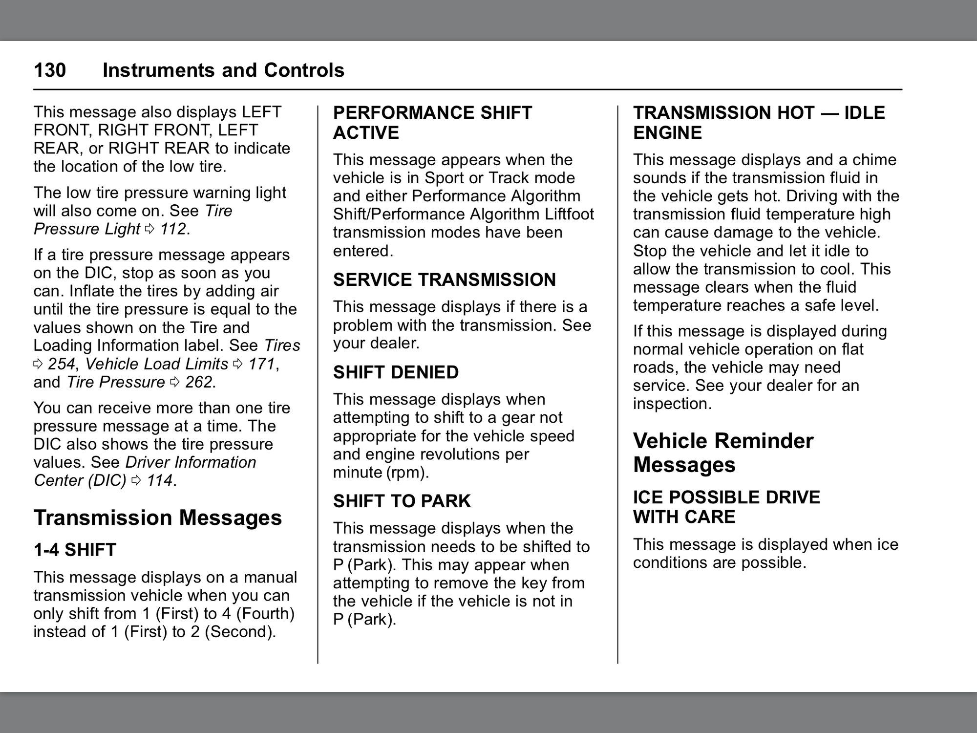

According to the manual, does not enter PSM unless in Sport or Track. Touring will not allow activation of PSM.

Be careful quoting the manual; it states that my '15 A8 with Mag Ride DOES NOT have launch control.....but yet at the Ron Fellows COS they do a demo launch with an A8 & Mag Ride
OP, I have had the same issues; I believe the computer is still thinking/waiting for more "Right Foot Happy Time", even though you are in touring mode. I found if I manually up-shift a couple of gears after doing a little "Happy Foot" time, the computer will reset to touring driving rather quickly.
