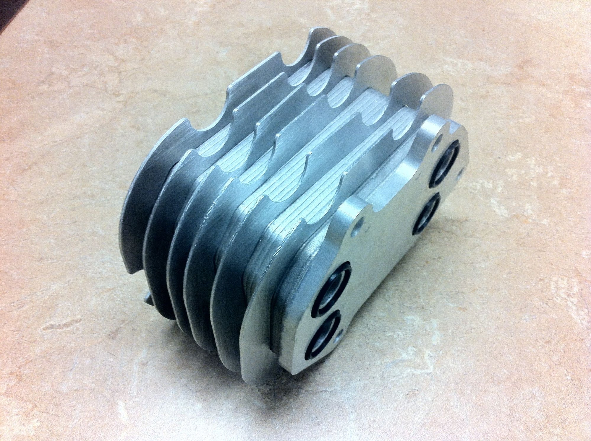

Newton, Here's a pic of the fins on the cooler. This is our test cooler they install on the car with a thermal adhesive, easy. Were just back from Watkins Glen running in the 90's with high humidity. On our Aim data recorder highest water temp 225 and oil 273. This was on many hot laps of 2:10 seconds no short shifting, red line 3 times every lap, half hour sessions, 150 back stretch speeds!
Our car has all stock cooling but use the heat sink fins with a 3 inch hose blowing fresh air on to it from the grill area. Also cat covers and titanium rapped exhaust. PM to get on the list for when I get the kits completed.
