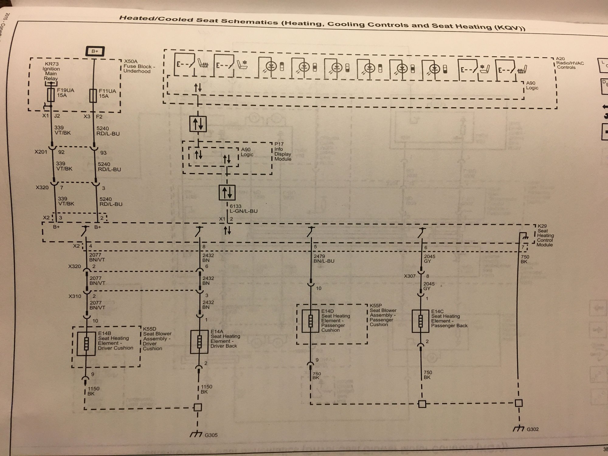

You will need the seat bottom heating cooling module and the seat back heating module for both seats, the seat control module which controls the seat heaters (mounted to the passenger side seat frame), the HVAC control module with the seat control push buttons, some extra wires run from the underhood electrical center plus a couple of fuses, wires going to the passenger seat and from the passenger seat to the driver seat. You will also need the passenger side HVAC control display that lets the passenger turn on their heated seat. Here is a copy of the schematic:

Thank you for the info. Seems involved but definitely something that can be done.

I have a demaged C7 here to with Heated/cooles seats an like to swap it.
But i can not found the wire from right seat-modul to ac-ecu and info-display.#
Wire starts at X1/2 but no colors/pinnumbers in the wireingdiagram.
Had somebody of you finished the Build?
