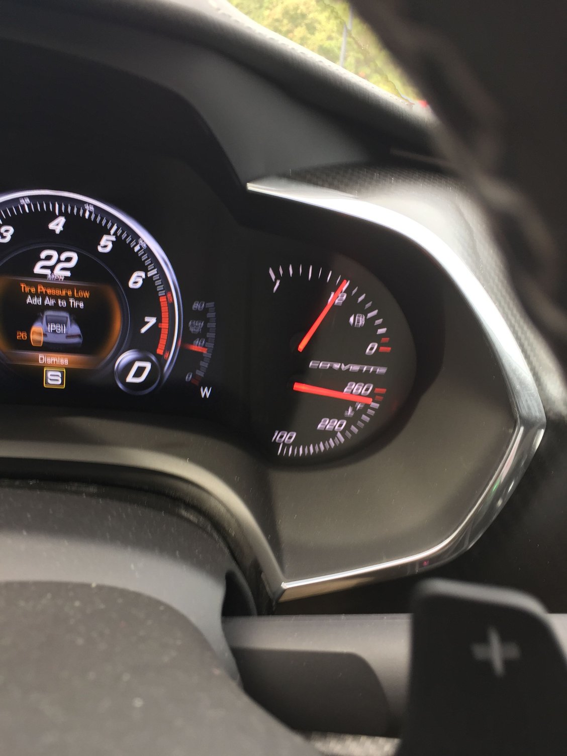

I have had my 14 Z51 into the dealership now four times (totaling two business weeks) for an overheating issue, that they are unable to replicate (of course) and unable successfully troubleshoot. In short, overheating has happened roughly two dozen times where in the cooling fans will not come on automatically when required normally at 220d under normal driving conditions, usually while sitting at stop lights or in traffic. However, as I soon as I recognize the overheating condition, I turn the car off, immediately restart, fans kick on, temperatures fall right back down to 220d, no further issues.

I'm using the 220 number from what my car usually runs on gauge and maintains all the time while driving, to include stop and go. When I have experienced the overheating temps above 255, on two separate occasions I was sitting at a stoplight windows down - no fans on. Turn off, restart, fans kick on temp drops down to 220 gauge temp. Another time I was sitting still in a parking lot, car idling, goes to 255, all is quite under hood, turn off car, restart, cools back down.
Car does not overheat while driving since ambient air is keeping it cool. Unfortunatley every time this has happened I'm 30+ miles from the nearest dealer.
Latest overheat sent to Service Rep so he didn't think I was crazy. Outside temp was 61.

The digital and analog gauges run off the same serial data signal coming from the ECM. The digital signal is displayed as digital numbers in the Tour Mode next to the speedometer and the analog gauge first converts the digital stream to an analog signal that is displayed using a volt meter calibrated to show temperature. The analog gauge is the least accurate of the two since there are small errors that can occur in the conversion and the meter has an accuracy tolerance as well. The ECM gets the engine temperature from one sensor which is wired directly to the ECM.
The analog and digital gauges can't read significantly different unless a wire is broken, or something is wrong with the digital display or wrong with the digital to analog conversion/meter. None of those types of failures could be corrected by changing the thermostat.

Bill, agreed on the sensors/gauge. If the car is truly overheating and not just having a gauge malfunction, then thermostat is probably stuck closed. This is easy to check and verify.
