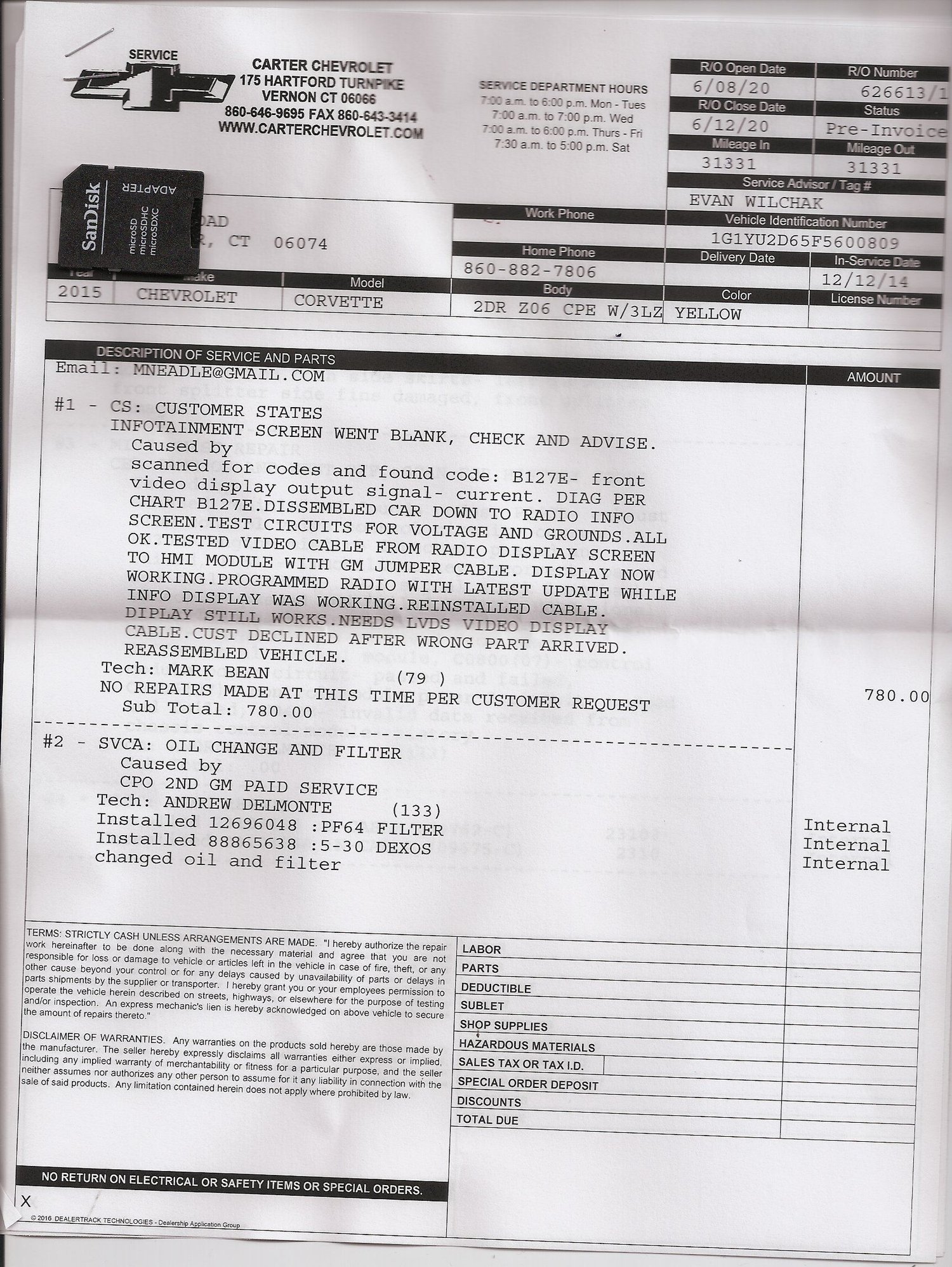

I have EXACT same issues. 2015 Z06 and 1week out of CPO warranty screen goes black. Brought it to my dealer and they took apart dash and said when tech disconnected cable and reconnected it went back on but there’s clearly an issue. It’s either cable harness or screen decides to swap cable first because screen is expensive and worked fine...until it went black. Wrong cable came in, and right one back ordered. No idea how long so I said put it back together as it was already there 1week. With a 10% discount (because I whined) $780. No repair at all just labor and diagnostics. When I get in car it was working. In their lot I lowered screen to get my sunglasses and they made it go out again - never pulled off lot. 1 day later it randomly came on, and has been on for 3 days now. I won’t lower screen anymore but assume it will go out again soon. $780 in already and want it fixed. Wish I knew if it was LCD panel or wire harness because trial and error is expensive with labor!!!!!

It's crazy, but it still is an issue. My 2019 Z06 PDR screen has gone black. Only the PDR feature. All else on the infotainment screen works. Other threads have identified the trouble as the blue "network like" wires that enter the lower front of the display unit. Was mentioned that one wire controls the infotainment section and the other wire does the PDR. One poster said that the lowered screen hits the wires. Seems to make sense, since these led screens are generally reliable, as they are on laptop computers. I'll report back when I get the trim pieces off and get at the wires.
Raising and lowering my screen seems to be the trigger so makes a LOT of sense to me!!

My '15 Z has the same issue. PDR only doesn't work...black screen and I was raising and lower the screen a bunch so I'm sure that's it. Hamfisted me knows that if I try to remove all the trim pieces to get to underneath the screen to check the wire, I will surely bust some of the trim pieces so I'm just living without the PDR for the moment. I've been told that if it's the blue wire, you can zip tie them to secure them better.
Subscribing. Good luck.
