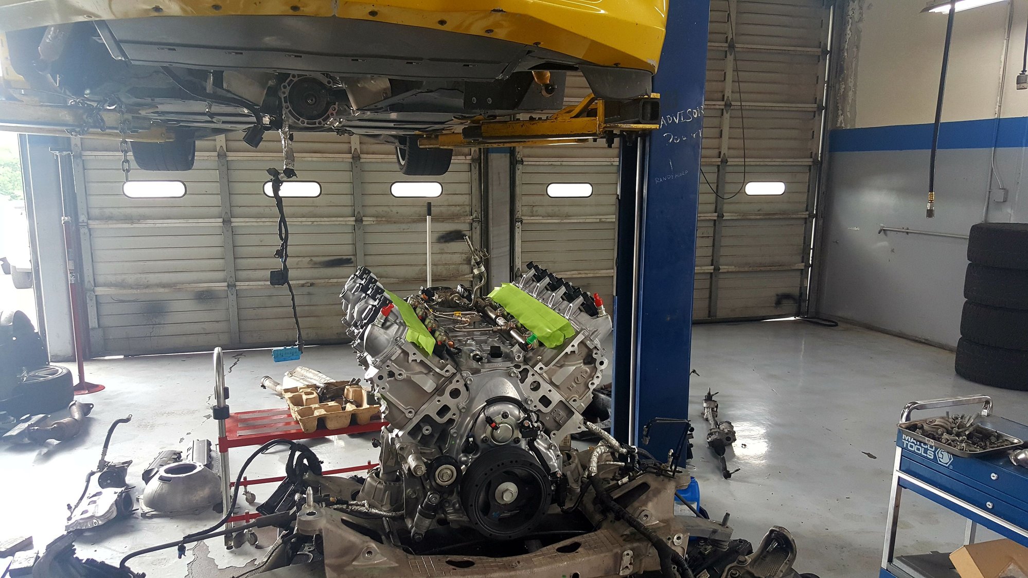

So I drive a 2014 Z51 M7. Driving down the highway last week and the car started making some horrible noises (clunking and grinding). Immediately drove to the dealer. The next day the service manager calls me and says what everyone dreads hearing... "Sorry to tell you this, but you need a new engine"
WHAT!!???!!!
So after a little back and forth with GM they will be replacing my motor. Not thrilled, but at least it is covered.

Thrust bearing broke and the engine ate it
UPDATE: Just heard back from the dealer... after final diagnostics, the thrust bearing was gone...could not even find the pieces. 1/8 inch play in the crankshaft (HOLY CRAP) and cracked rod in #3 cylinder.

38k
New Heart...
