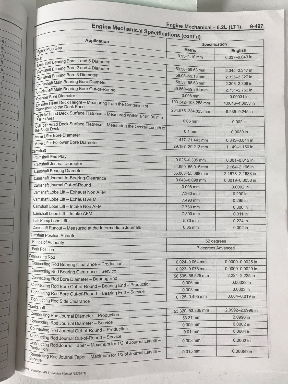

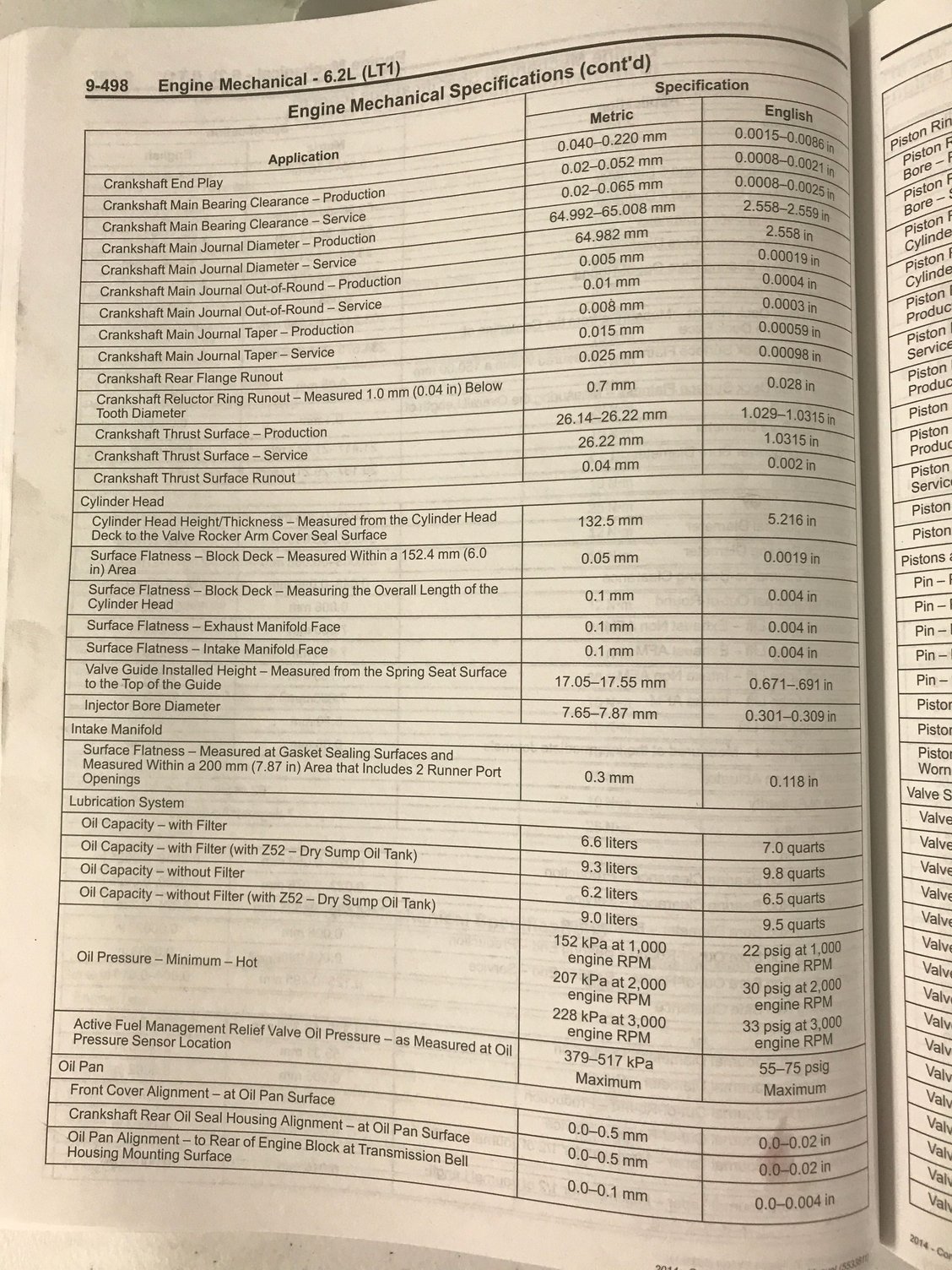

How many miles on it? I'd leave the cam bearings alone if they look ok. I did not replace mine as they looked fine at 52K miles. Here are the tolerances for the main bearings and rod bearings:
